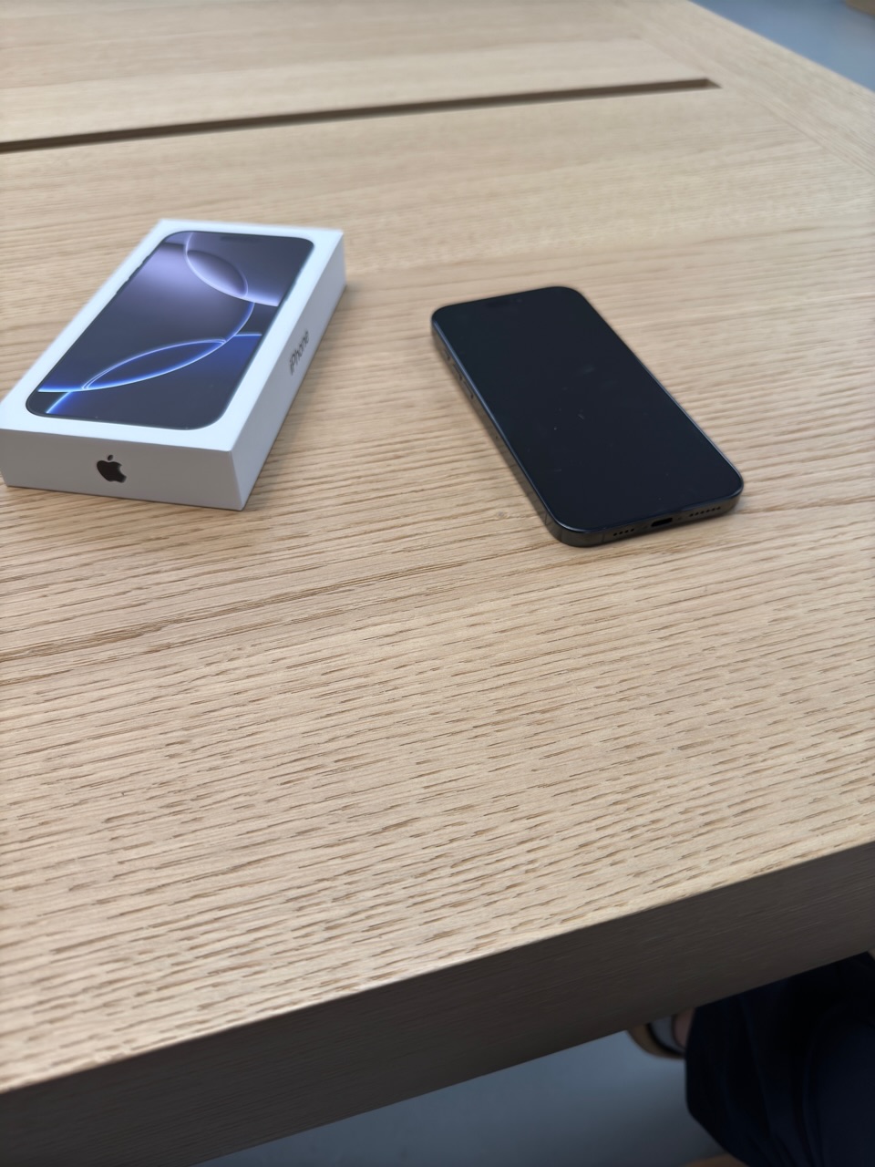

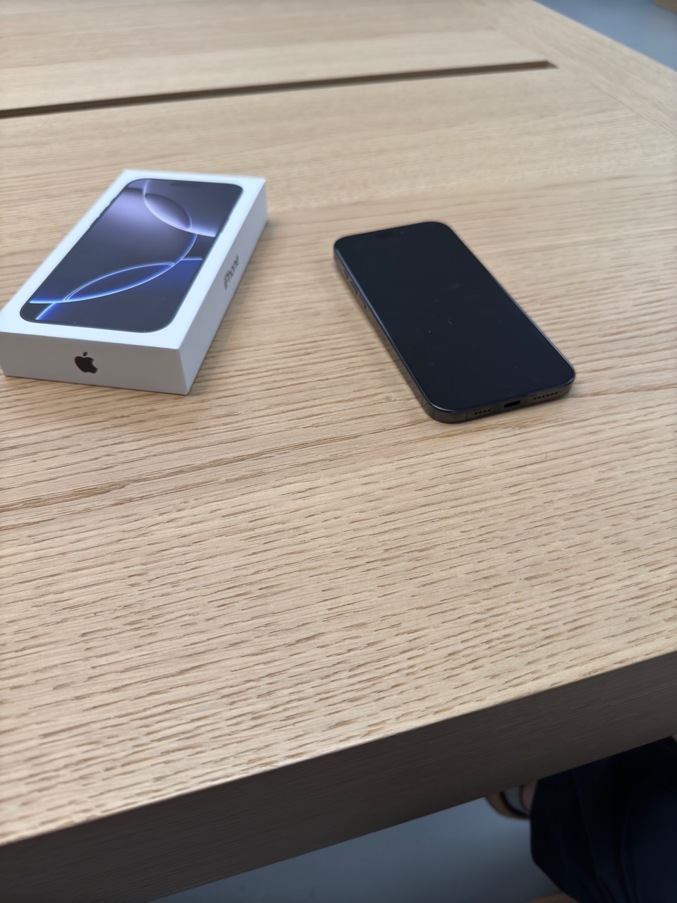

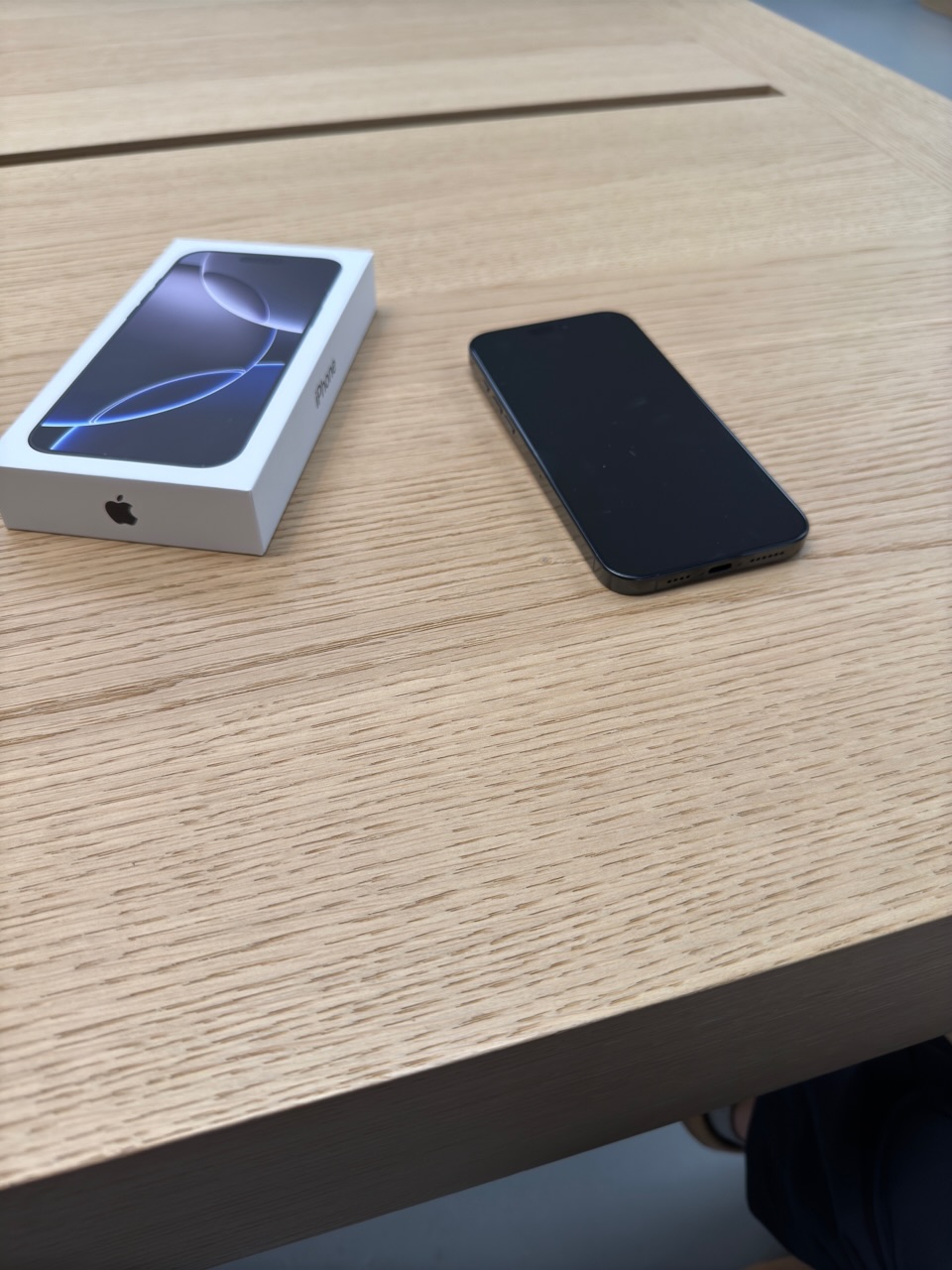

Here we go...
I'm assuming it's good so far ?
Camera is fine and without iCloud backup it feels as snappy as my old 15 Pro Max. Huge improvement. Right now restoring iCloud to see if that changes anything.
Such a relief to type on this phone. Super snappy.

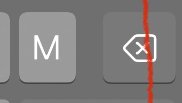

I have the same problem with the touch screen
I contacted apple support and they installed some profile to take logs but still they find no issue and i went to genius bar at my country and then they detected multi touch screen has issue and they gave me a new replacement and BUILD is july 2024
so far touches has been good and doesnt miss keys anymore but there is still one issue
23d4fde8-21ff-4b81-a817-bf7b1c53505a
Anything at the end of the red line cant be touched or sensed
I tried P , Q , SHIFT , ABC/123 TOGGLE
All cant touch but i used assistive touch and toggle the ball over to those edges and it can detect
so i m pretty sure its a software issue instead of hardware
Anyone else encounter this ?

currently with the latest one still having the issue at the edge part where it doesnt sense the key but if u try scroll on it it works
so its software definitely
