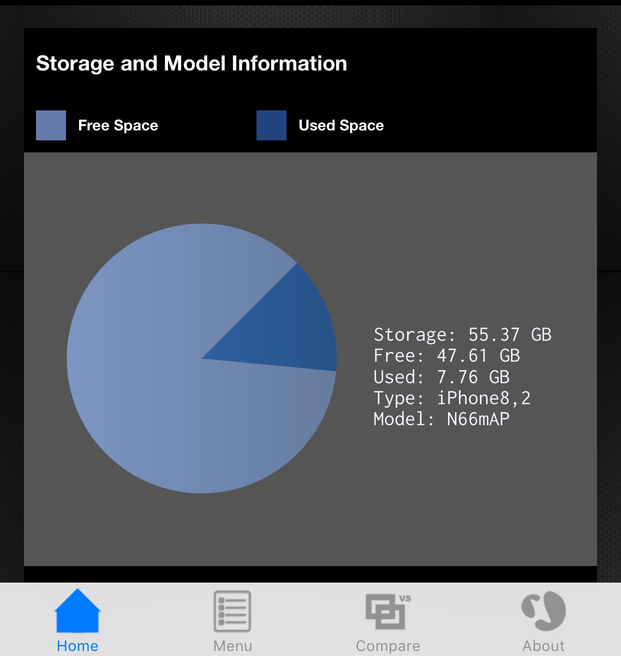

I tied that app and it didn't work at all for me. It shows a few details but not that.
It is in the first tab and is blocked by an Ad. You need to tap 'Not now' to remove the ad first, then you will see your model number.

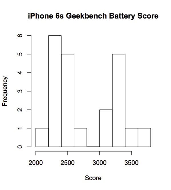

I don't really think that the battery alone can contribute to such a big difference. If that is the case, it's a serious quality control issue. According to a Tweet by John Poole, the founder of Primate Labs / Geekbench, the distribution of battery test results of 22 iPhone 6s is not normal:
I thought this article was a click bait until I saw this tweet.
