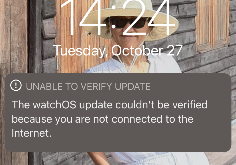

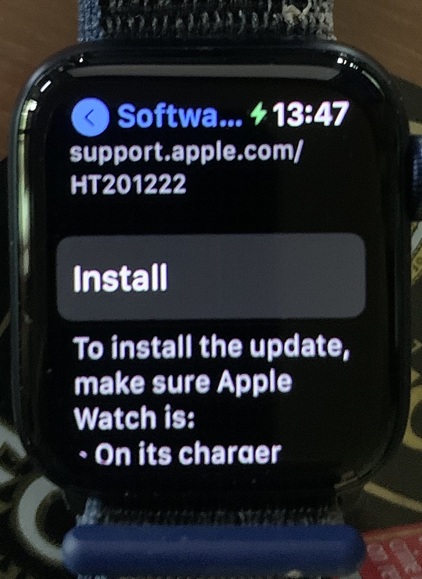

Ok. And what happens when you press install?
It says "Verifying" for a while and then it just goes back to the screen with "Install" on it. And, then,I receive a notice on my iPhone telling me that it's not connected to the Internet.
I also have Nightstand Mode enabled.
