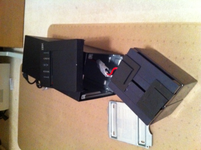

I ordered 2 refurbished 1500TLV units from ExcessUPS on Monday. I found the unit listed cheaper on a few other sites, but they had sketchy reviews. ExcessUPS was recommended on this forum and their EBay feedback looked OK, so I went with them.
I ordered them through their EBay (not the website) store for $250 each with free shipping: http://cgi.ebay.com/APC-IBM-SMART-U...-/110582074452?pt=PCA_UPS&hash=item19bf348c54
They shipped Tuesday and arrived here Friday. The units were adequately packed. Both had moderate cosmetic damage to the cases, but nothing that you shouldn't expect in a SELLER-refurbished unit. The batteries looked new, but I didn't see a label so I believe they are an off-brand, not APC batteries.
I'm testing one unit first. I plugged the new Mac Pro into the UPS along with my 30" ACD and my Altec Lansing speakers. The Mac Pro recognized the UPS with the included USB cable.
There are a few shutdown options:
The UPS icon appear nicely in the menu bar:
The unit was charged 83% but quickly went to 100%. I pulled the wall plug -- the UPS alarmed and this came up:
There was no lapse or flicker in the display when I pulled the plug. I did not have any processes running at the time. The power management window said I had 36 minutes of power at full charge.
The unit is VERY quiet at rest. The Mac Pro is louder. When the battery power kicks in, the fan in the UPS box comes on and it is quite noisy. However, it runs for only a few minutes after utility power is restored, then shuts off. People who have concerns about the fan noise of this unit do not need to be worried. My unit did not make the humming or whining noise described elsewhere (?).
Overall everything seems to work OK. I'm not sure how much ACTUAL time the UPS will provide; the power seemed to drain a bit faster than indicated. However, there should be more than enough time for a graceful save and shutdown. I plan on testing out the other unit and playing around a bit with the save/shutdown settings. The second UPS is for two external RAID boxes I intend to purchase for backup purposes. I suppose backup for those is even more critical, as they will lack the battery backup found internally on my Apple Pro RAID card.
I hope this was helpful to anyone asking about UPS options. I appreciate all the useful information I have received from posters on this forum. Thanks.
