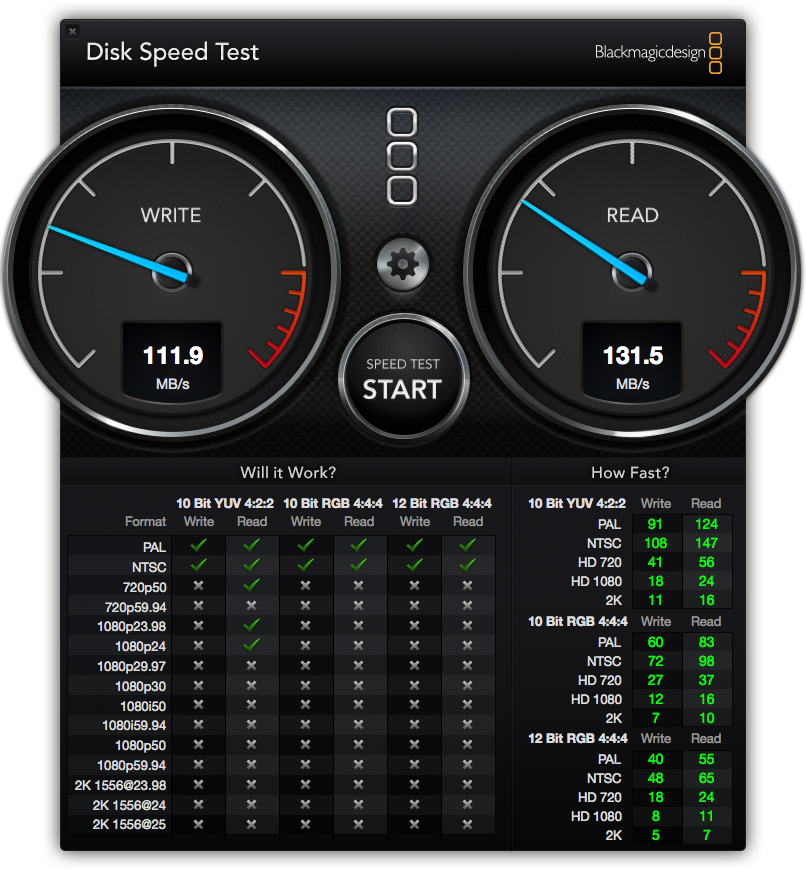

finally working usb 3 expresscard
buffallo expresscard 34, nec chipset + go-flex 1tb portable
caldigit card was £70, c.f. buffalo card = £20
i got the buffallo tech 2-port usb3 expresscard, handily came with usb2 power thing which draws extra power into card
installed the caldigit mac osx 10.8 drivers
downloaded multibeast 5.2.1 from tonaymac86 site
used pacifist to extract usb3 caldigit file, ran install on pacifist and it overwrote the caldigit usb3 kext
(dont ask me why one needed to download the original driver from caldigit, but this was the only was it worked)
reboot
all working fine (just cant load with express card, major kernel panic)
can how-swap my drive in/out the usb3 ports
tested seagate go flex
usb 2 read 14mbs/ write, 19 mb/s read
usb3 80 mb/s read, 76 mb/s write
downloaded 4 gb file in 90 seconds ! scorching (tool 8 mins in usb2)
This method will work for any of the nec controllers:
buffalo, lacie, caldigit - all have the same nec controller
