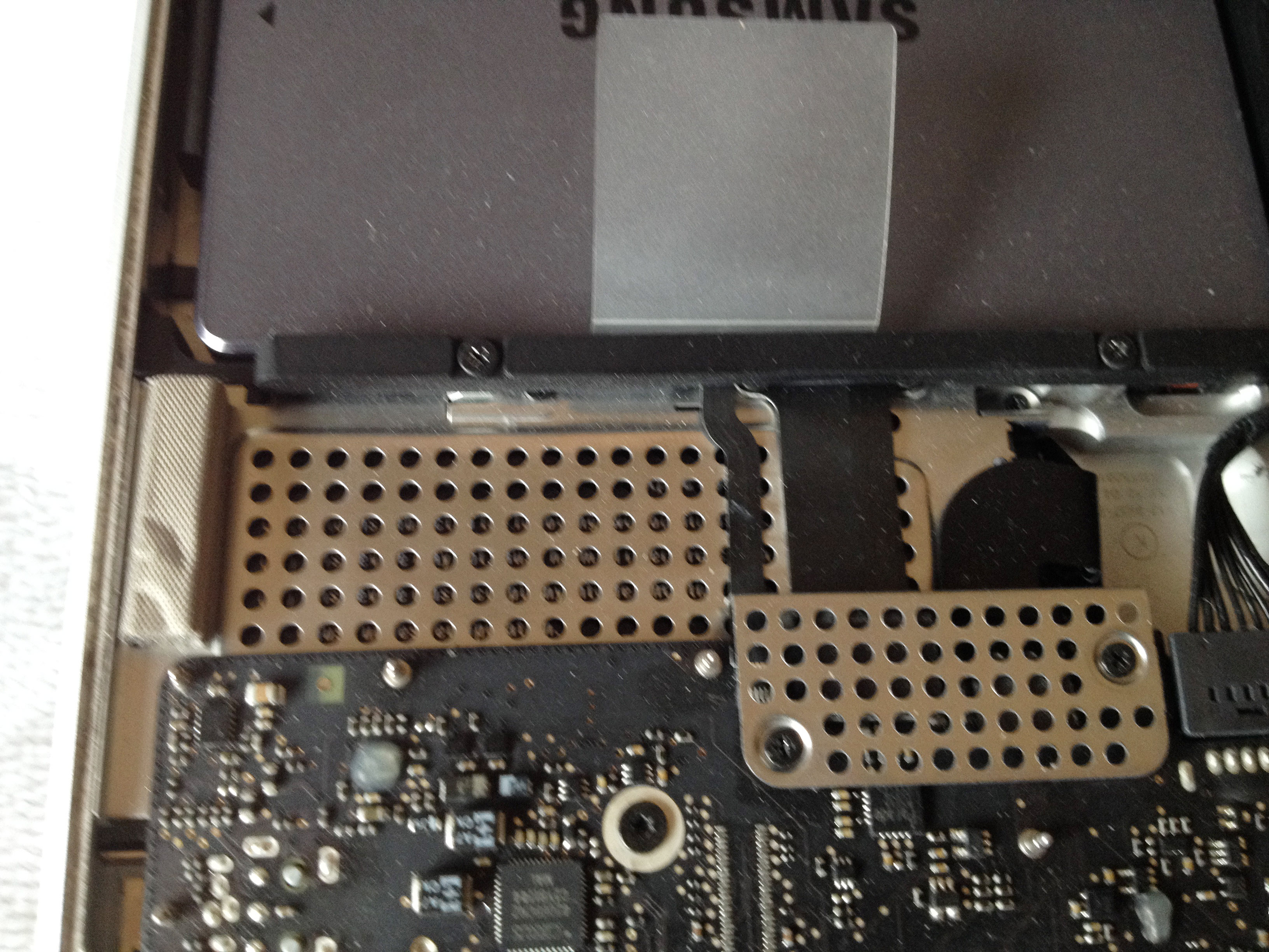

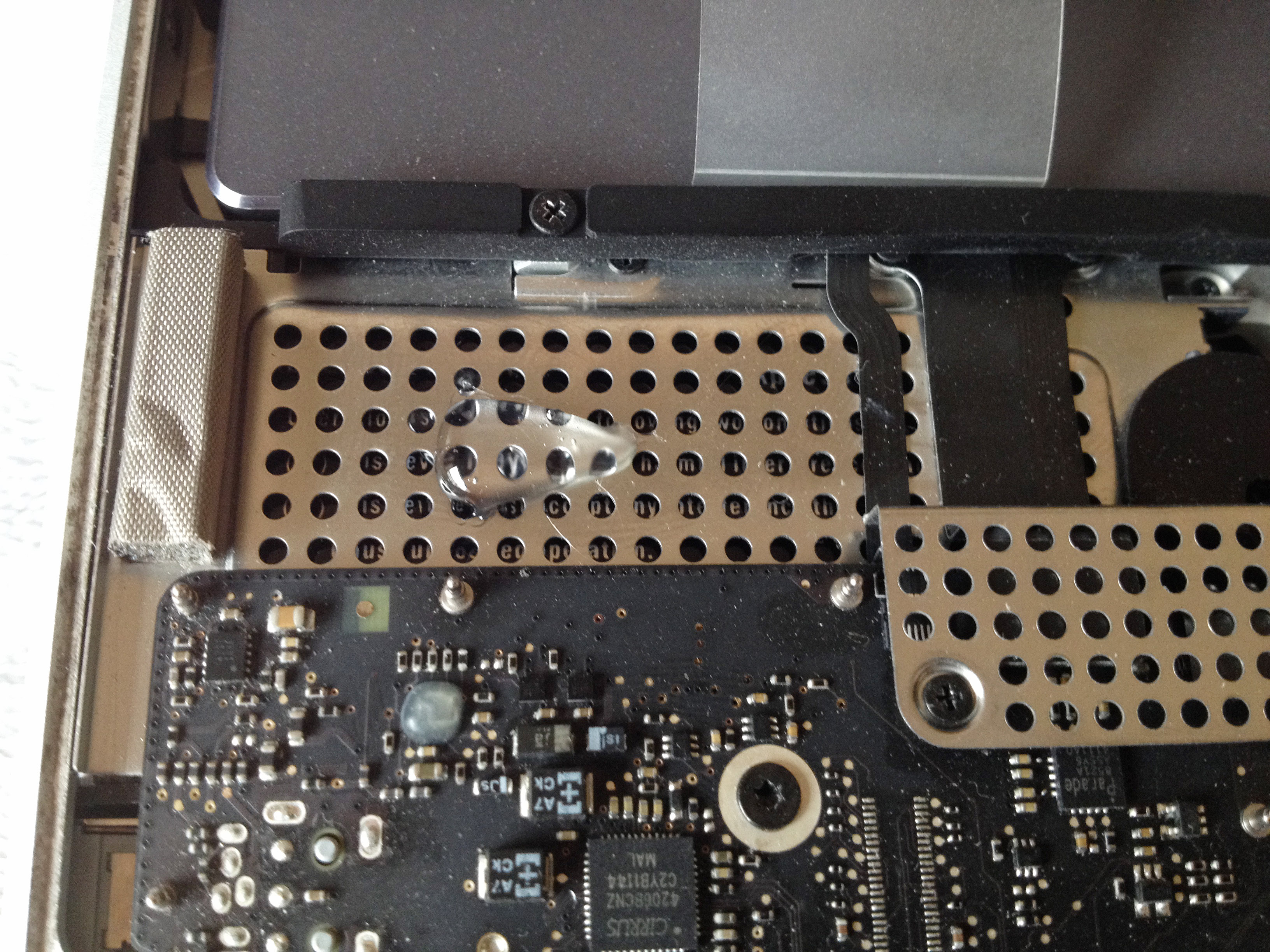

I took off the back and used the heat gun to apply some hot glue.
I put the glue gun nozzle up against one of the holes in the perforated plate and it went between the card and the plate, which means I'd need to do some disassembly if I decided to remove the card, which is fine with me seeing as I have no other use for the ExpressCard slot.
If you want to make it less permanent just let a few drops of the hot glue drip onto the perforated plate.
