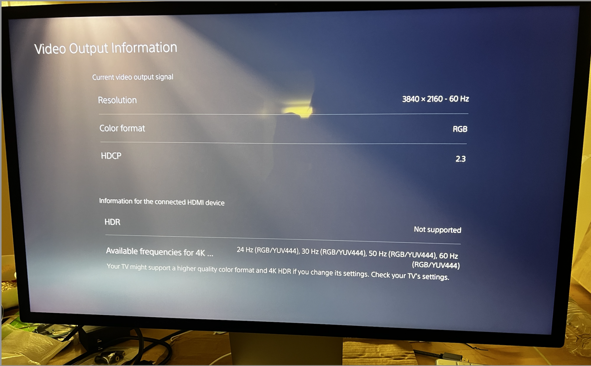

YES! It is because the EDID!
I tried with
It has an EDID associate with it.
I use it with Wacom Link Plus.
It finally works with 4K@60Hz, No Audio, No HDR.
PS5 → gofanco Prophecy HDMI 2.0 to DisplayPort 1.2 Converter (Red Light: 4K@60Hz EDID) → Wacom Link Plus → Apple Studio Display
