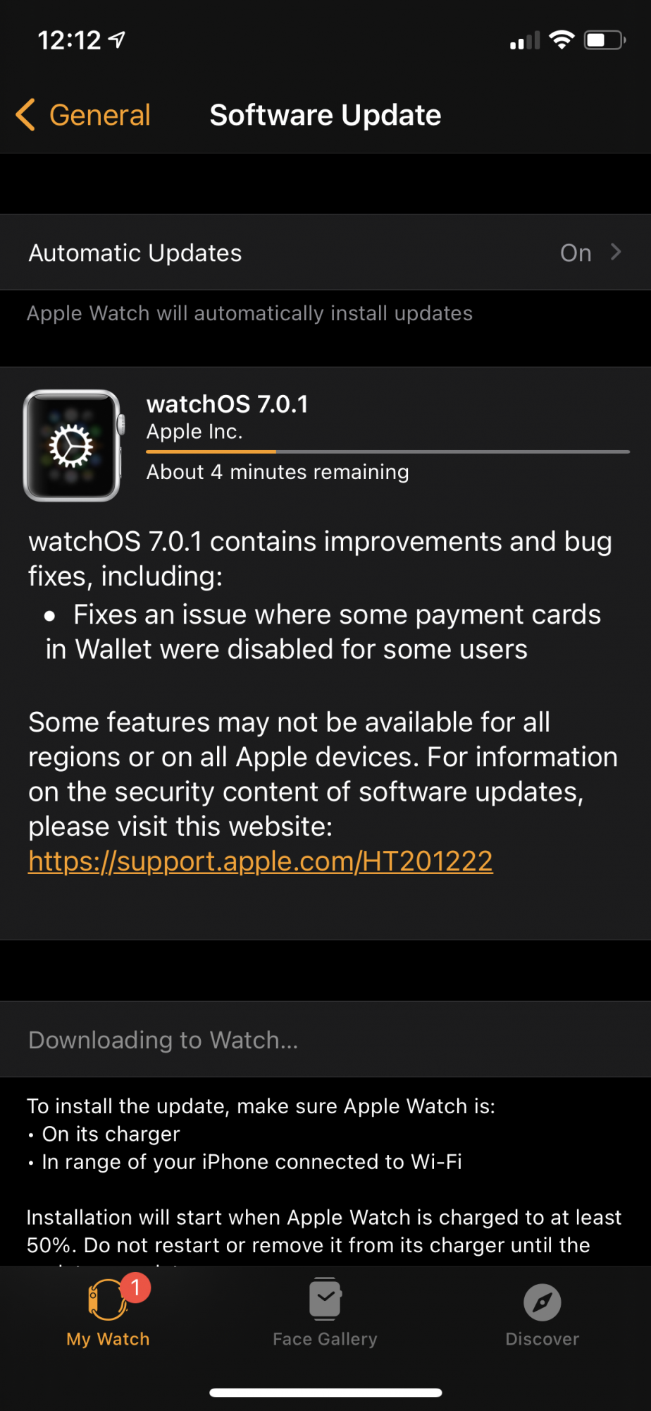

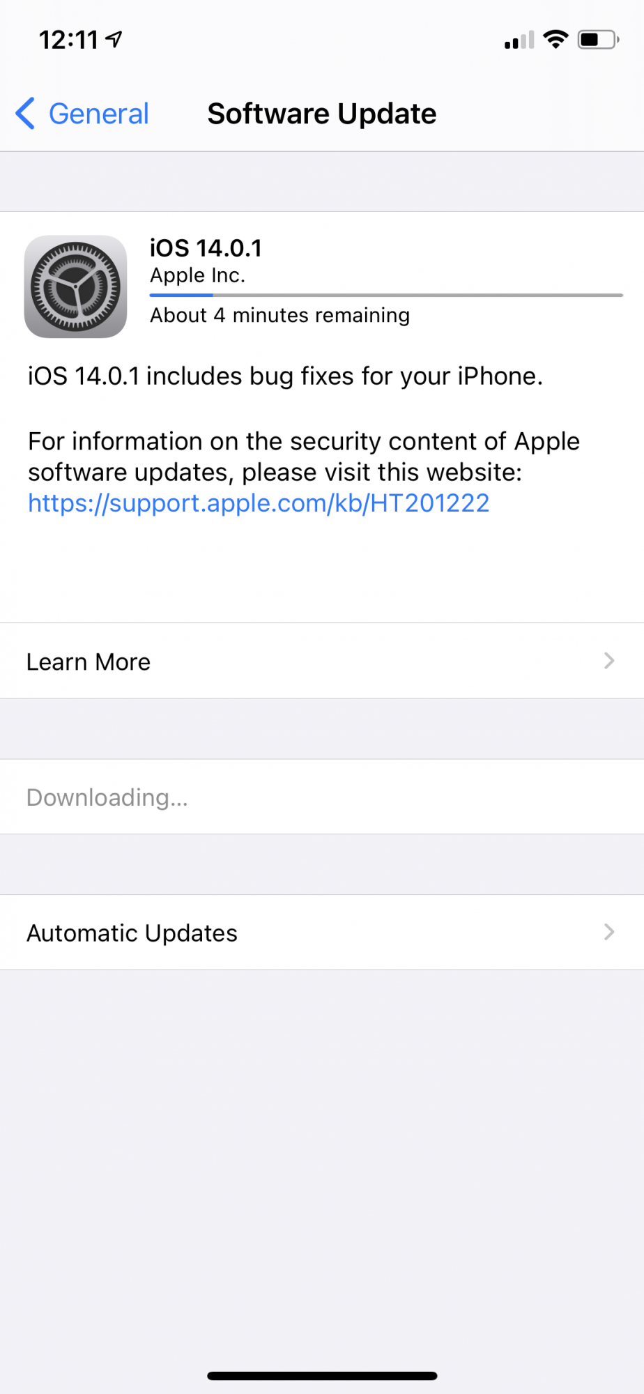

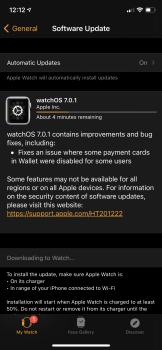

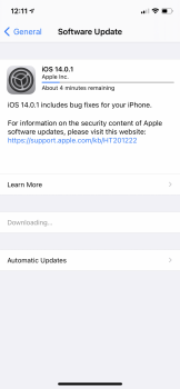

Hope this will fix battery drain issue in WatchOS7
