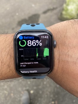

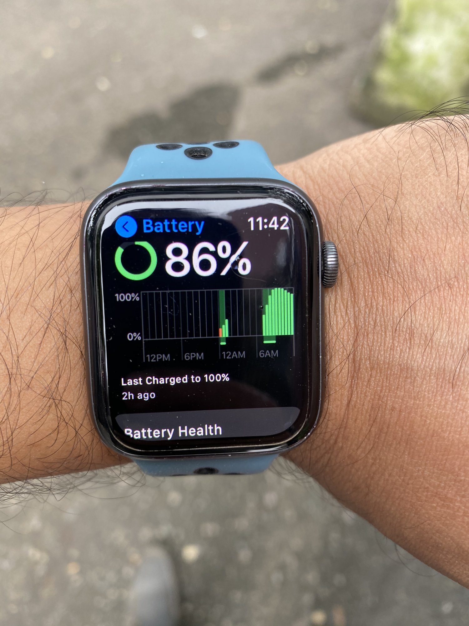

Worst battery life. Just in 2 hour battery discharged 14% without any use of it.
Did unpair/re-pair
Restored from backup & also started as a fresh setup. Both case same.
series4 44mm
Watchos 7
