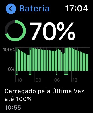

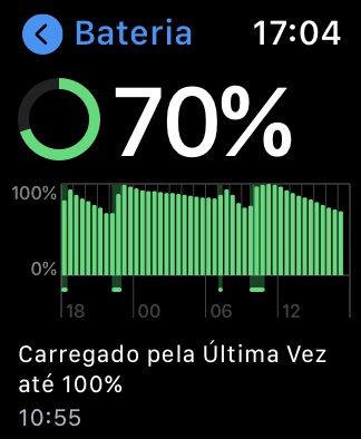

This is after the unpairing process. Amazing. This is what I wanted. Thanks for the advice, guys. 30% on 6+ hours of usage. If it goes like that I will finally have the 18 hours.

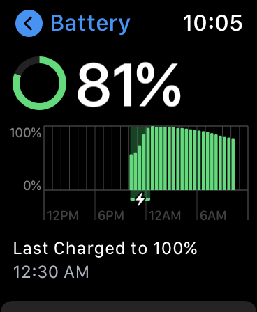

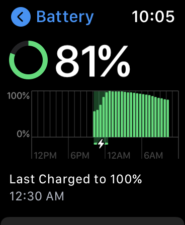

Series 4, 44mm with Cellular.
Would only get a few hours on Watch OS 7 but I re-paired before I charged to 100% and it is a lot better.
I have a series 5 but I’m in the process of charging back up to 100% after the re-pair....fingers crossed. If this doesn’t work I will deal with it - hopefully my Series 6 will have better battery life (slated to arrive first part of October)
