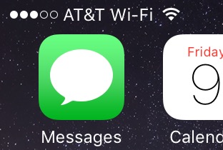

Got it to work and say AT&T Wi-Fi with airplane mode on and a test call worked. I believe if you have sufficient cell signal the call is always going to go through the network and not wifi
Actually just confirmed through the AT&T store I work at the you must be in a low coverage area or airplane mode for it to work.
Not sure what consitutes as a low coverage area though. Apparently the phone knows when to switch to it.
Yep basically it's a game of strongest signal at the time wins. Your phone basically when you have WiFi on will always analyze the signals around and in theory prioritize the stronger of the what's available near you

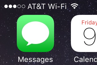

Was finally able to toggle on wifi calling on my 6s Plus...but the AT&T Wifi icon is not coming up.
When I check my account/line features on AT&T website, it lists that I have a "Wifi Calling Blocker" enabled on my account.
I started up a quick chat with AT&T. They had me toggle off/on wifi calling and after about a half hour on the chat they claimed they succesfully removed the block from my account.
It's been about an hour since then and block is still listed and its still there. Looks like I have to call AT&T when I get out of work.

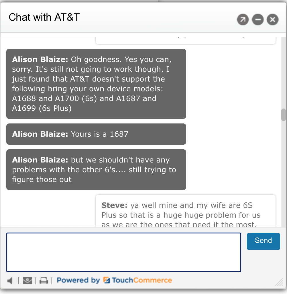

wont let me activate wifi calling on my iPhone 6S Plus when contact AT&T they claim "AT&T doesn't support the following bring your own device models: A1688 and A1700 (6s) and A1687 and A1699 (6s Plus)" and mine they say is a A1687 I pre-ordered on Apple.com choose AT&T Model 128GB Space Grey and a 128GB Rose Gold doing PAY IN FULL so would be unlocked. Well guess in their eyes I didn't get a AT&T Model....
They suggest returning and getting right one... well problem is now its over the 14 day return period 2 they probably have none in stock as still on back order. So would be without a phone..
So warning if you have a UNLOCKED Phone don't expect to us AT&T WiFi Calling

Talked to AT&T Tier 2 and Tier 3 support. According to them, if you purchased a 6s, 6s+ from Apple directly (didn't mentioned 6, 6+), those are not yet currently capable of Wifi Calling on AT&T. Something about there needed to be an agreement attached to the account when you purchase the phone, and Apple was not doing that.
I have a 6s+ from Apple Day one, purchased full price, and i get the error about your account not currently setup for wifi calling.
You do need a new sim Card, so if you have an old one, you will need to change it out. But they say they are working with apple on this. Now no idea if this is true, but they are not able to hit the switch and apply the agreement on the backend on my account, as they get an error.
I bought my 6S from ATT I'm getting the same error. I had wifi calling working on my 6 with iOS 9 GM.
I'm going to defer you all to this post and assume yea WFC is So new for ATT most reps don't have a clue or proper training yet
I called them and they have no explanation and said that it is so new that they don't know how to fix it yet.

have you turned your phone to airplane mode with wifi enabled? if your signal is above 2 dots, wifi calling won't enable.
It doesn't appear to be a simple "number of dots" rule. There's likely more involved in determining when to use Voice over Wi-Fi. My signal at home has had 3 dots for a while, and my phone has been on AT&T Wi-Fi a lot.

I called AT&T today since I received the message that I had to call. Although I bought my iPhone 6S from Apple I bought an unlocked t-Mobile unit and that is why it won't activate wifi calling. I spoke to a very good rep and she had to create a case. She said it would be corrected by Oct 20 but it should be complete before that.
Yep. I had three dots and still had the wi-fi calling enabled. I'm glad, because no matter 1 or 3 dots in my house, the signal sucks and I get drop outs, garbled audio complaints, and dropped calls.
There are a lot of signal values and variables, and the dots are just a dumbed-down estimation of signal people can understand.

I have some interesting information. I have a T-Mobile unlocked version of iPhone 6S plus that I use with my AT&T account. I have tried to activate W-FI calling and it would give me the oops message to call AT&T. What was weird is that if I put my wife's SIM (which is on the same AT&T account) in my phone, WI-FI calling turned on without a problem. She is also able to activate WI-FI calling on her own AT&T version iPhone 6 Plus without a problem.
So I called AT&T and after 30 minutes, they couldn't figure it out and said that maybe it was my T-Mobile phone but that didn't make sense since my wife's SIM worked in my phone. They suggested I get a new SIM which I did today and it didn't make any difference. The people at the AT&T store were very helpful and called technical support for me. After 30 minutes of trying different things, what we discovered was that if they put in the IMEI from any AT&T iPhone 6S in the store into my account (that is, I didn't actually remove my SIM from my T-Mobile iPhone 6S and they just changed the IMEI in their system), I can activate WI-FI calling without an issue. So basically, they left that in place -- on my AT&T account, for my phone #, the IMEI their system has is not from my phone but for another AT&T iPhone.
I don't how long that will last -- I mean if the system will figure it out the correct IMEI later and deactivate WI-FI calling in the future. I also don't know what would happen if I put my SIM into another phone and then back in my phone, will the WI-FI calling feature no longer work?
I guess the lesson in the future for me is to buy the AT&T version. I just wanted to get an unlocked version from the start.
I suppose if someone wanted to switch from another carrier to AT&T using their old non-AT&T iPhone 6/6S and didn't want to buy AT&T's version of iPhone 6/6S, WI-FI calling is a feature that may not work. I think this is silly since AT&T would certainly want people to switch services even if they didn't want to buy a new phone, and obviously some non-AT&T versions do work with their WI-FI service (at least my T-Mobile version does).
