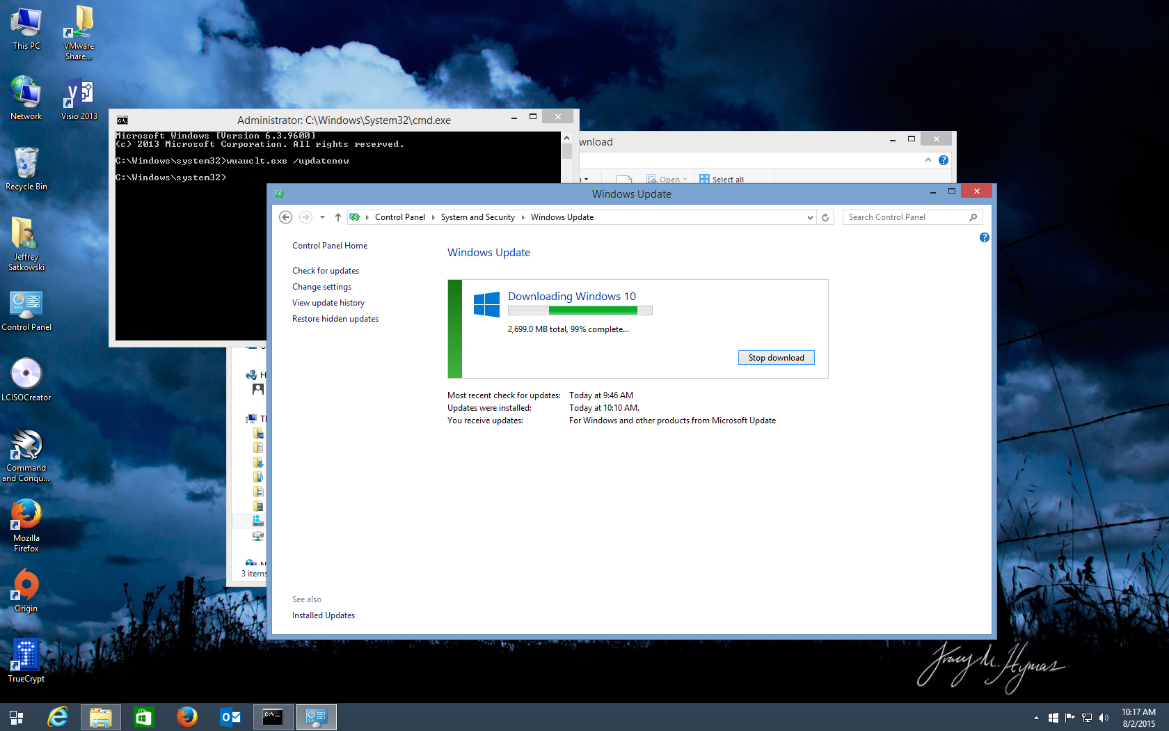

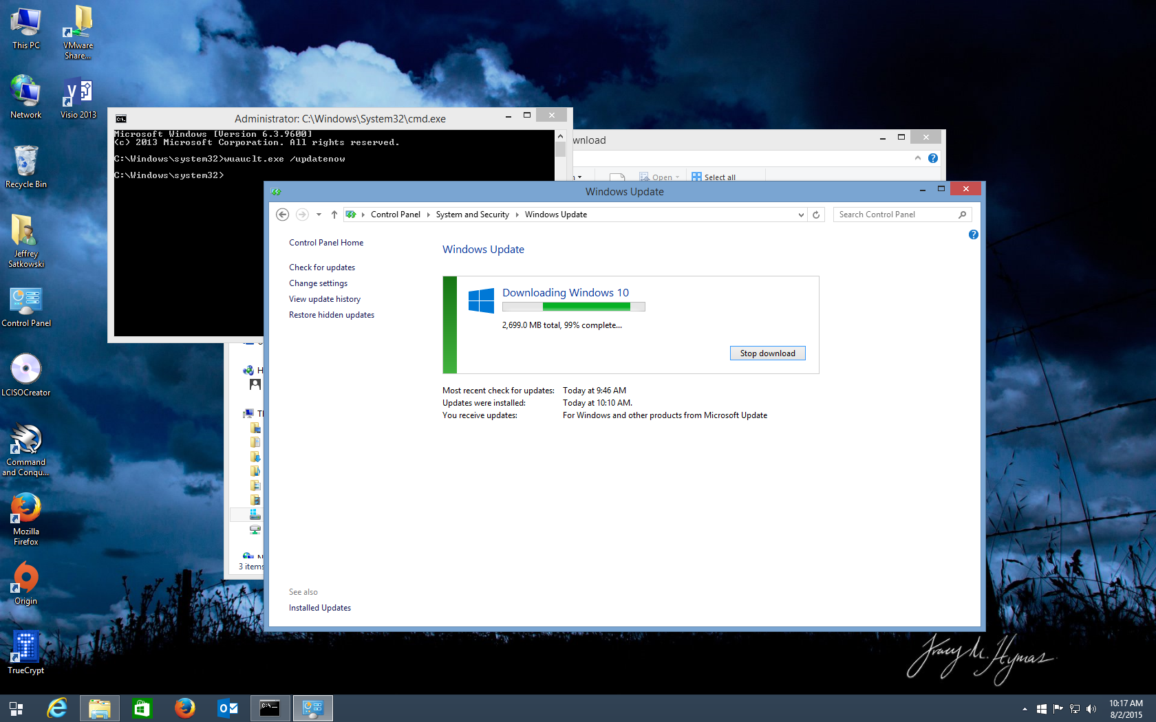

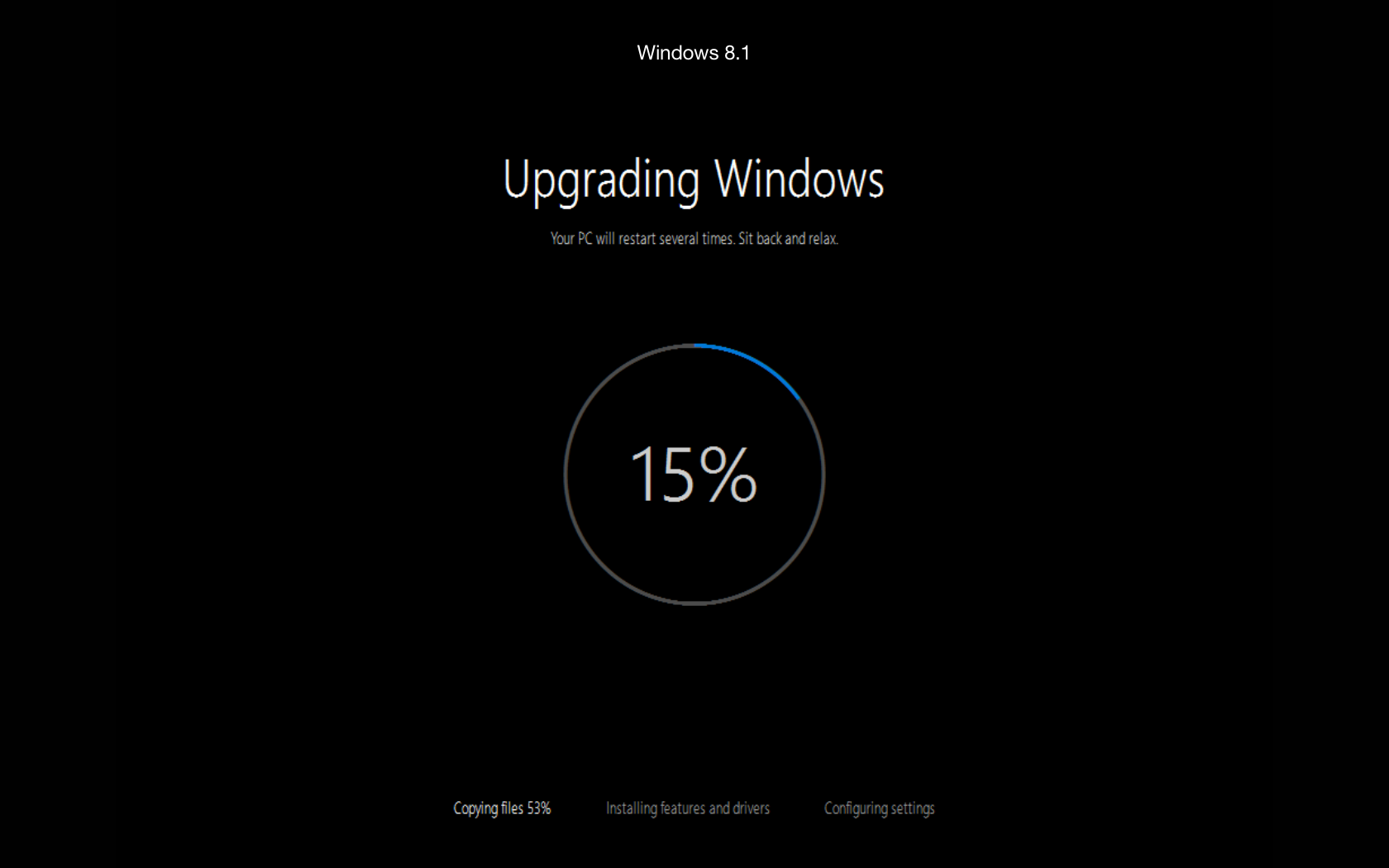

So this morning I decided to try to upgrade my Windows 8.1 VM to Windows 10, even though I already have a Windows 10 VM. I just wanted to see if it would work or not. When I clicked the upgrade button from the System Tray it came back and said it couldn't upgrade due to the VMware SVGA driver, as some have experienced in this thread. I did some looking around on the VMware forums and found this simple process to make the upgrade work.
  1. Uninstall VMware tools
  2. Restart Windows
  3. Deleted all files in c:\windows\softwaredistribution\download
  4. Run wuauclt.exe /updatenow from CMD as Administrator
  5. Go to Windows Update and Windows 10 started to download.
  6. After download installation of Windows 10 started.
I followed several things in that thread, linked above, and none worked for me until I got to this process. It worked like a charm and the upgrade is proceeding right now.
Disclaimer: This particular installation of Windows 8.1 was a conversion from Apple Boot Camp to Fusion 7 last year when Fusion 7 was released. Not that it has much, if any, impact on this upgrade process.
View attachment 572558 View attachment 572559

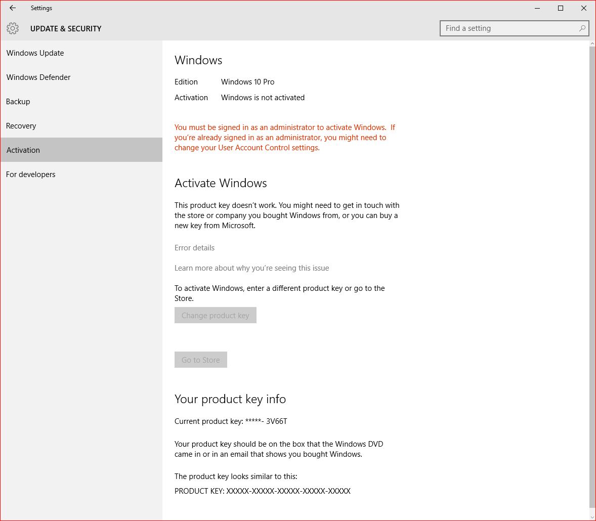

Hi!
Quick update from me. Thanks for your updates girls/guys!
Managed to upgrade my EFI Windows 8.1 (OEM) using VMWare Fusion!
Booted back in EFI and Windows is NOT ACTIVATED! :-( Perhaps I have to call MS tomorrow for a new key.

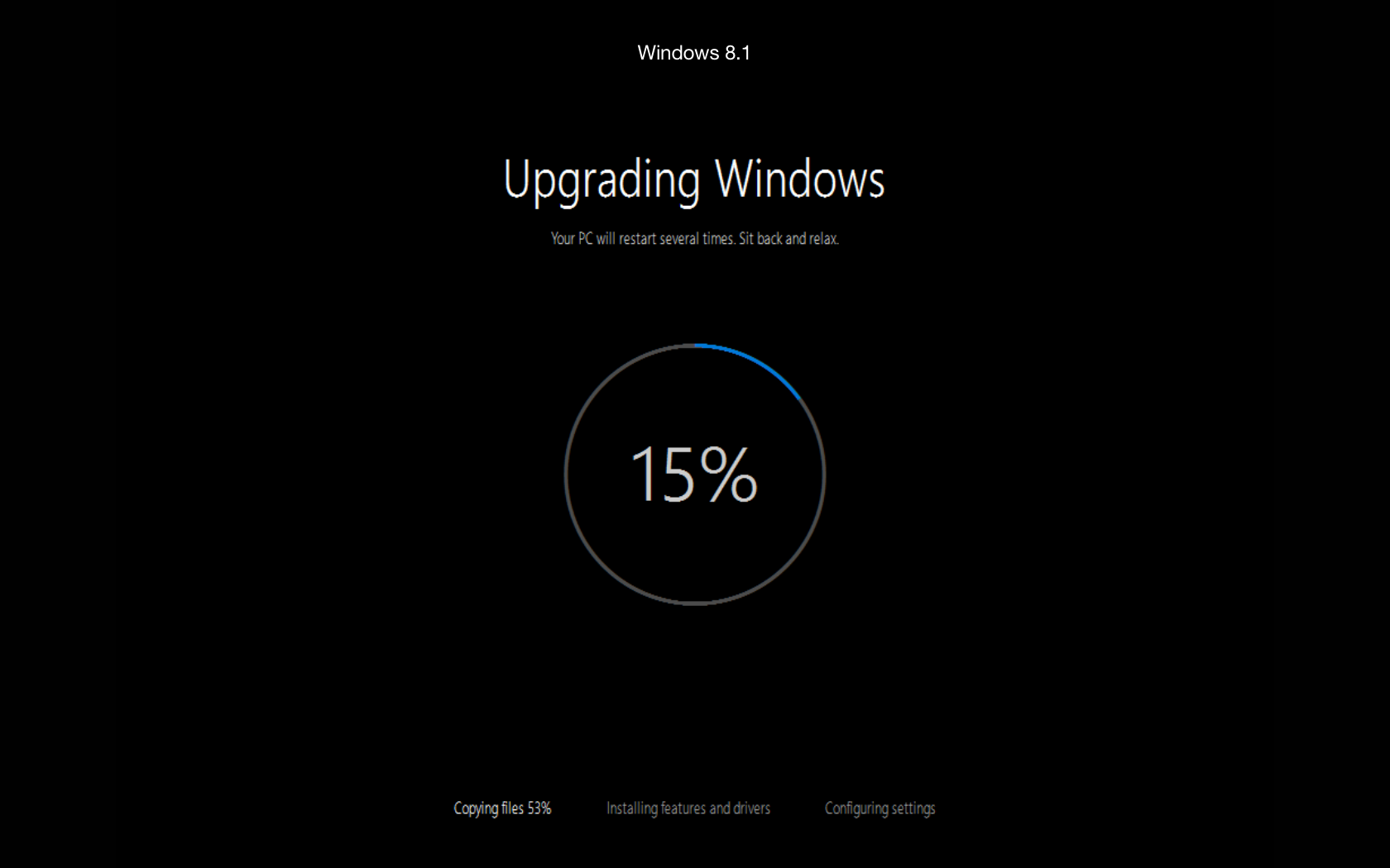

Since when does "keep apps and documents" mean an almost clean install of Windows 10? Don't know what happened, but this has been a terrible upgrade path and outcome for me. Spending ONE more day tomorrow to solve this, or else I'll revert back to Win 8.1 😡

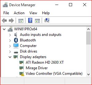

Did you have the VMware Fusion display driver when you were finished? My attempt in a VMware Windows 8.1 upgrade to Windows 10 seems to be working, but all I have available for a display adapter is the basic Windows adapter which only has 3 fairly low resolution settings. I need the Fusion 3D accelerated graphics display adapter so I have available a 2550 x 1440 resolution again. Attempting to reinstall VMware tools doesn't seem to complete, and changes nothing.
Hi hfg, thanks for your info's!

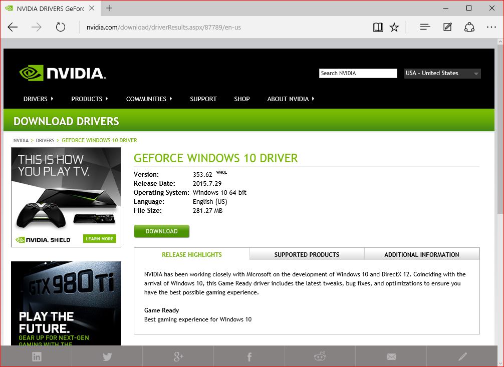

It didn't finish with the "VMware Fusion display driver" and even got a BSOD: "DRIVER_IRQL_NOT_LESS_OR_EQUAL (epfwwfp.sys)"
After reboot Windows 10 didn't detect my PC GTX-670, so I had to completely re-install NVidia driver package:
I too have a very crappy resolution in full screen running the bootcamp drive VM:

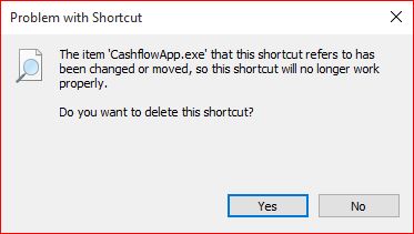

It seems that the Windows 10 upgrade killed so many apps, that I have to troubleshoot what I did 'wrong'?:
Many "startup at login/windows boot" apps are killed as well.
Even the activation was killed by the upgrade:
From Windows Event Viewer:
faultstring><detail><HRESULT>0xC004C003</HRESULT><Messages><Message>103 (Activation) - [PA Product key blocked. ---&gt; Product key blocked]</Message></Messages></detail></soap:Fault></soap:Body></soap:Envelope>) 00010003(0x8004FC01, 23:50:16:653)
I was signed in with my local user account with administrators rights, very confusing indeed. Any one here to give me some directions to troubleshoot my very crippled upgrade? Appreciated! I really don't want to do a clean install atm due to apps installed and their tweaks. Calling MS after lunch.... fingers crossed!
Seems I'm not the only one.... 🙄
http://www.tenforums.com/windows-up...or-code-0xc004c003-post312781.html#post312781
Cheers
