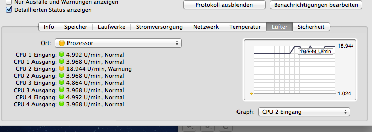

A little bit late but I do still have the problem. Fans working correct - swapped them in the array. May be the Logic Board of the Array or an issue with installing a second CPU in the original single CPU Xserve with empty second socket?! Any ideas? I've only put it in an started up, all working fine. Or must I do any other steps on the Xserve Mainboard?
