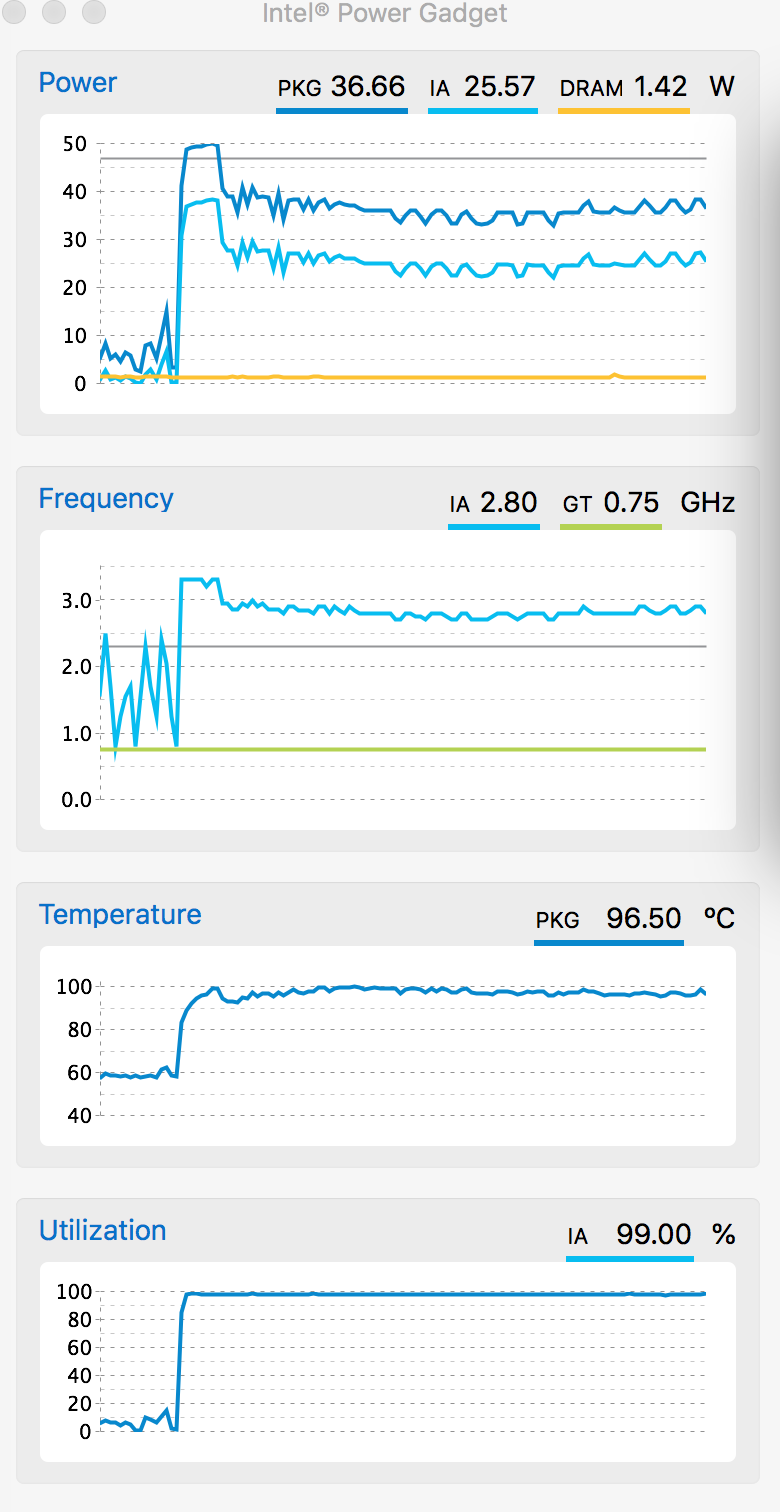

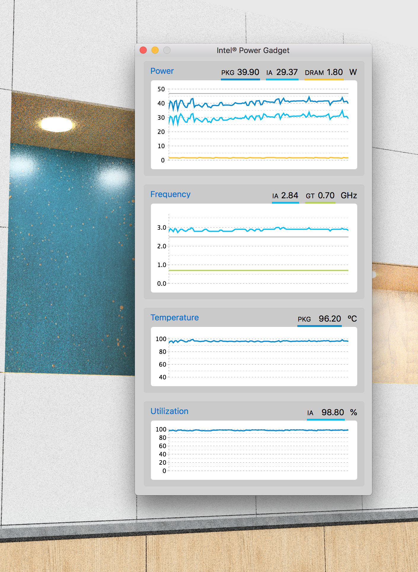

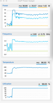

running the stress test on my maxed out 2012 rMBP 15" (2.7 i7 quad) and the speeds *never* fall below 2,7 ghz. (+ its running at 85 degrees C...)
Same here. Running my 2.3GHz 2013 MBP and its smooth sailing at 2.8GHz

I just uninstalled it. Second picture shows what happened after uninstall
I saw similar results in my Cinebench testing as my Lightwave3D testing. Single core performance around 4.0ghz to 4.3ghz. Multi-core 2.3ghz to 2.6ghz. I consider this reasonable as I've gotten much the same "drop" with other laptops featuring large core counts.

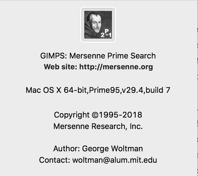

I realize that as I have a imac, and an older i5 to boot, and therefore my experience may be different, but Prime95 will
drive my temperature up to 100C, my power consumption to 72 W, and my frequency down to 3.2 Ghz
4 instances of yes will only consume 58 W, permit 3.7 Ghz turboboosting, and produce 95 C (which, in my case, is not enough to spin up the fan)
It should be 8 instances of yes, 1 for each thread. Basically repeat yes > /dev/null & for each thread.
I was trying to standardise our testing a bit, with Prime95 you can get different results depending on the version and settings.
I've been editing my post with some data from a current i7 desktop, not with the latest version but pre and post AVX anyways.
Thanks for the reply.
You're very welcome. Just to make sure we're testing the same thing, I used the Blend torture test with 8 threads. Default settings, basically.
I wasn't really trying to line up with anyone, rather simply demonstrate that the AVX instructions drive power consumption, and therefore TDP thru the roof. I think it's on Intel for this aspect, since it doesn't seem to remain within the CPU's design threshold for TDP when these instructions are used on all cores.
In my case we're talking an additional 25W consumed when using the same test with AVX. That increase is more than 25% of the base TDP design parameter on my desktop CPU.
