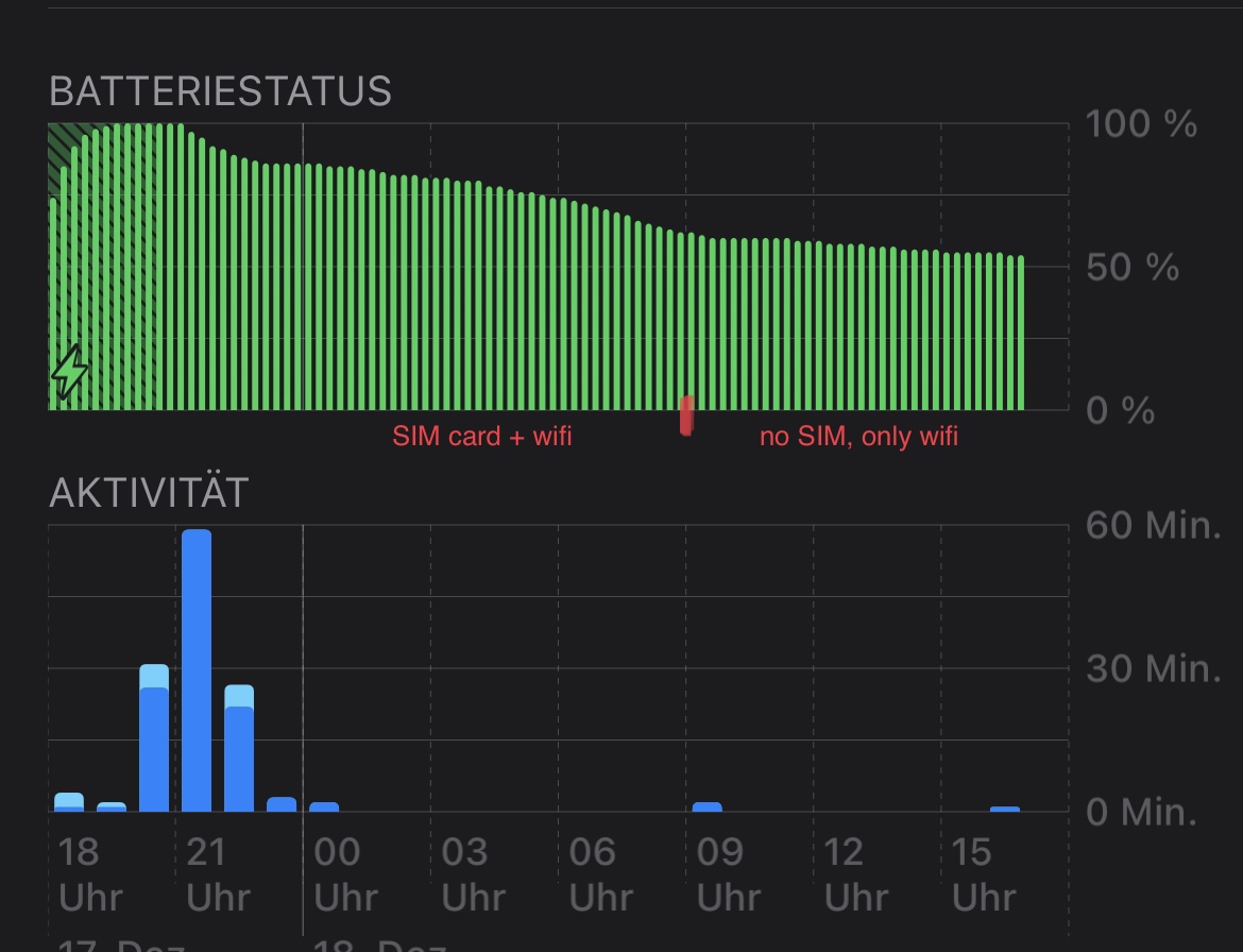

I am having the same issue with my 12 Pro, losing 3-4% battery per hour on idle during the night. I also got it already replaced and the new one seems to have the exact same issue. So waiting 6 weeks for the replacement unit did nothing. Thank you👌
I now created an automation running every 30 minutes to log battery level in a file on iCould.
I also did some previous analysis, playing around with setting disabling everything etc, without any significant change.
Now the interesting part, I figured out that battery draining is only happing with an inserted SIM card! (Flight mode does not have any effect), only removing the SIM card from the iPhone!
Using Telekom (Germany), perfect signal, wifi connected. So poor signal should not even have an impact.
I am going to switch to eSIM tomorrow, hoping to fix it with it.
Results

with SIM & Wifi: 12% in 4 hours -> 3% per hour
no SIM, only Wifi: 2% in 5 hours -> 0,4% per hour
Another night (not perfect without SIM, but definitly an improvement!

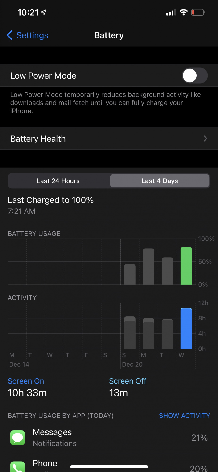

I’m on a 12 pro and never had any significant battery drain until 14.3 now I’m experiencing it significantly. 10-15% overnight where there was 0-1% previously and usage wise I can see it dropping 2-4% within 5 mins just doing casual safari browsing. Have even noticed it dropping while only going through settings to investigating battery/active functions. iOS 14 is simply a botched release for many users in different facets. If there wasn’t a health pandemic and I was in field working I’d be even more frustrated.

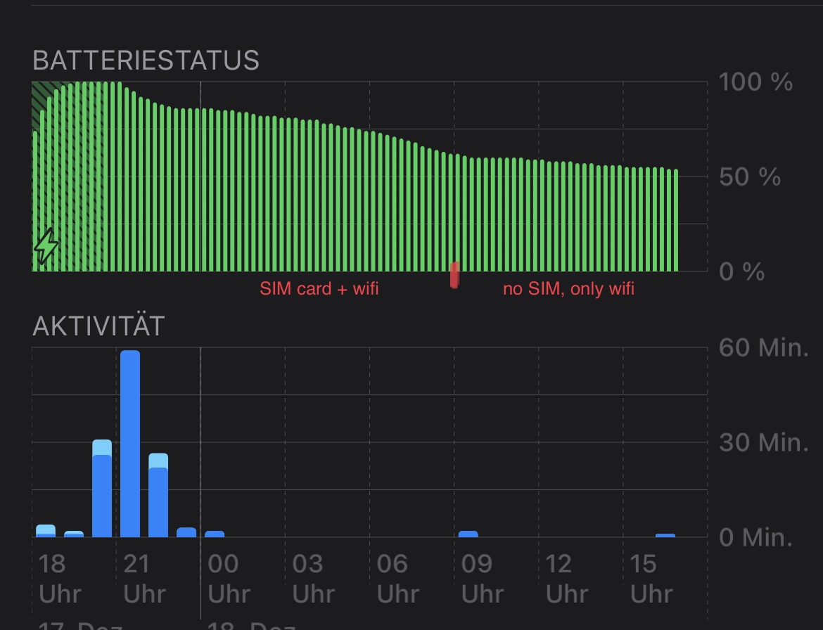

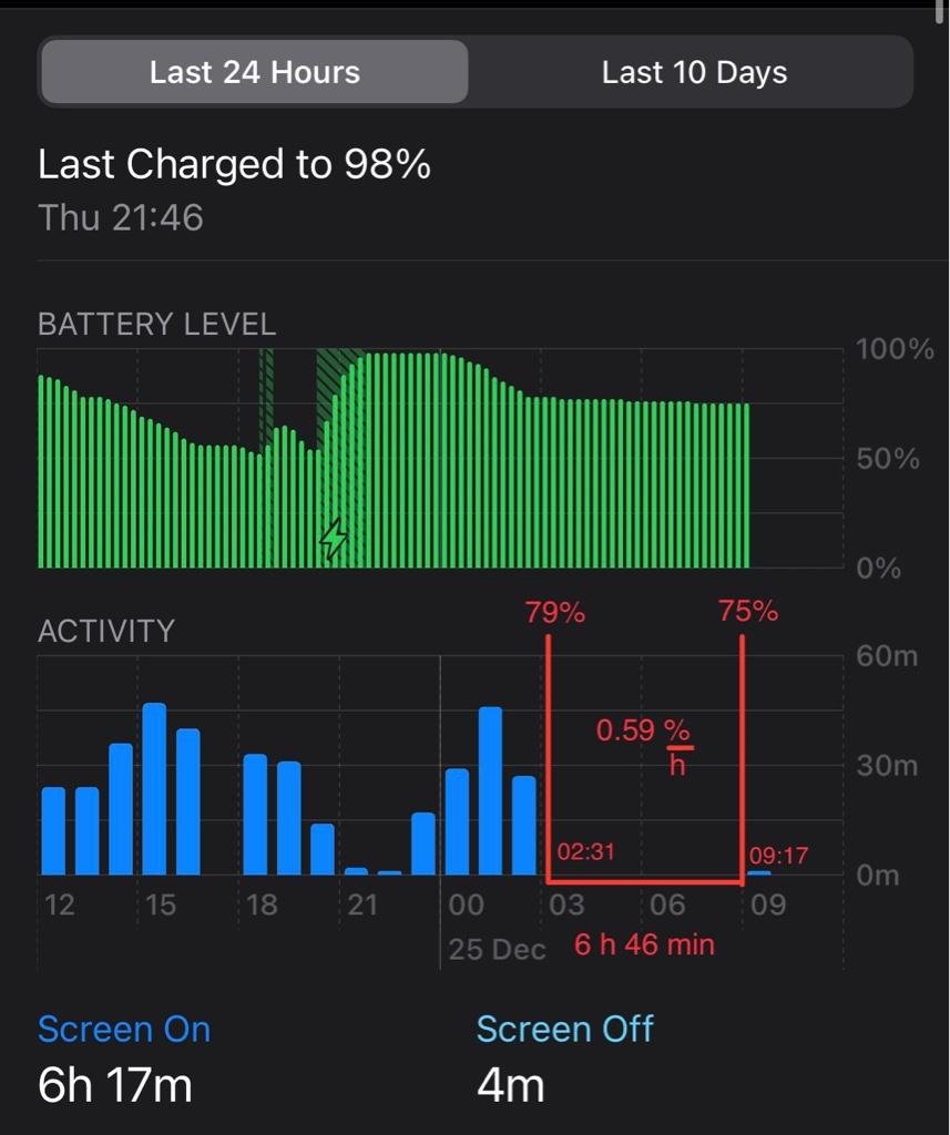

Well I'll be damned! It's a Christmas miracle!
iPhone 12 Pro 0.59% per hour dropped overnight. Only thing i did was leave it face down. Wifi and Bluetooth On, Physical SIM with poor room signal reception.
