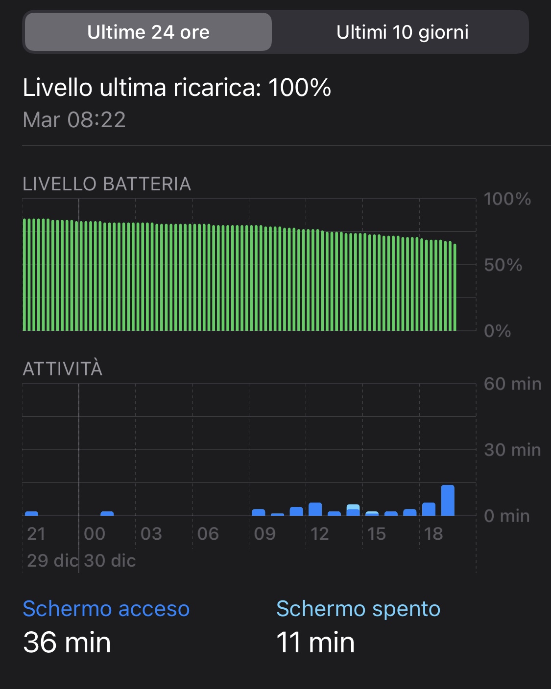

I lost 0% this night (12 Mini)
Note i have switched from another 12 Mini which lost about 7-10%
Its incredible, i will make another test tonight in order to make sure if this is regular

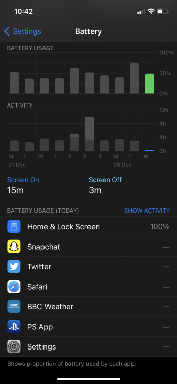

I don't normally check this regularly, but noticed this morning (due to the large drop) that mine lost around 50% overnight. 😵

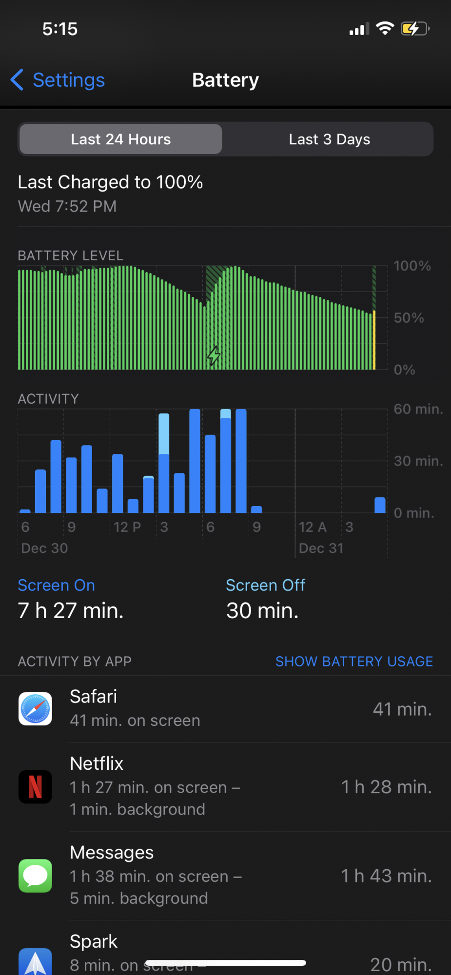

From my experience things are still very shaky. I have nights with the exact same conditions were i ve lost a reasonable 4-5%, nights i ve lost 0% (not from 100% but from a lower level) and nights like the last night where i lost a whopping 18%

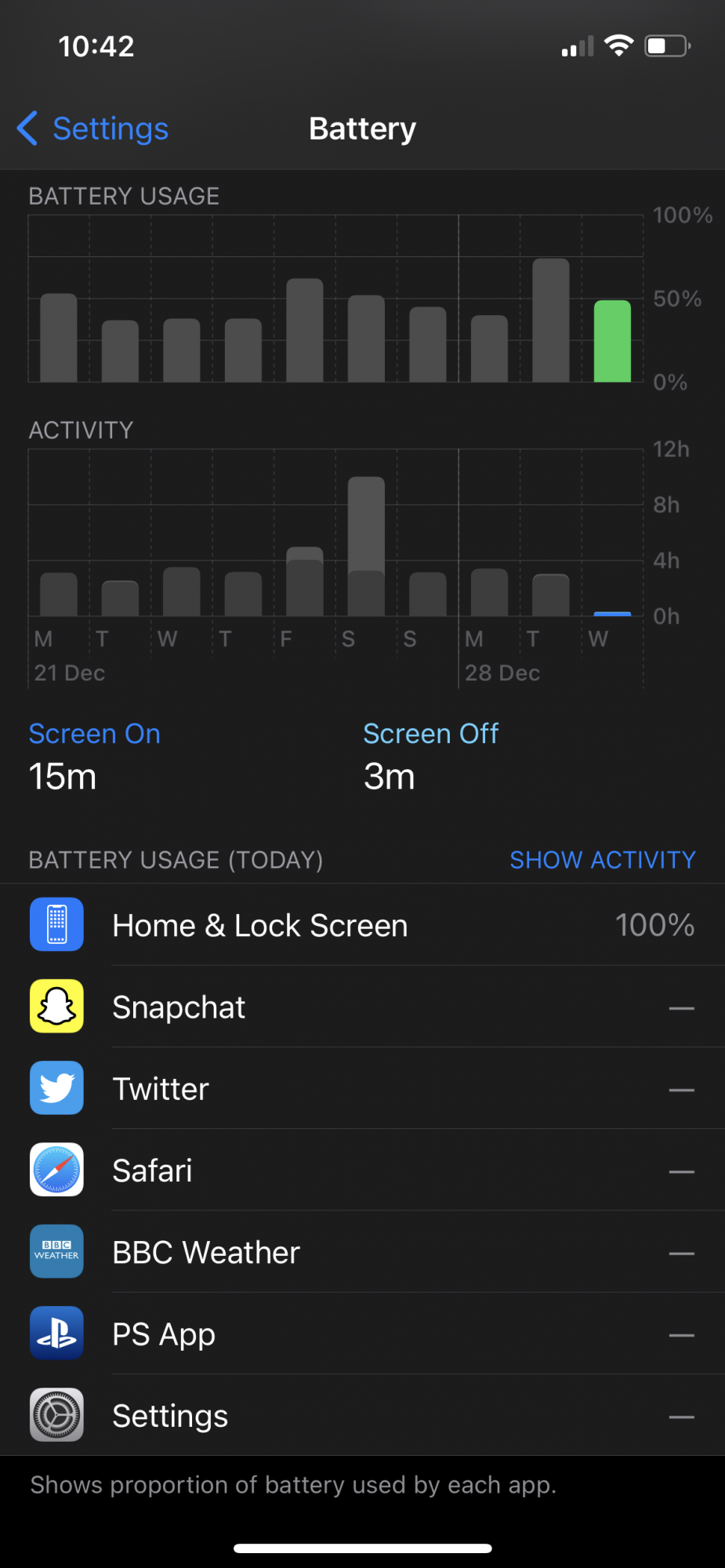

I lost a very substantial amount of battery overnight on my 12 (see from midnight onward). It shows no apps running during the night. 5G is off. Background refresh also off.

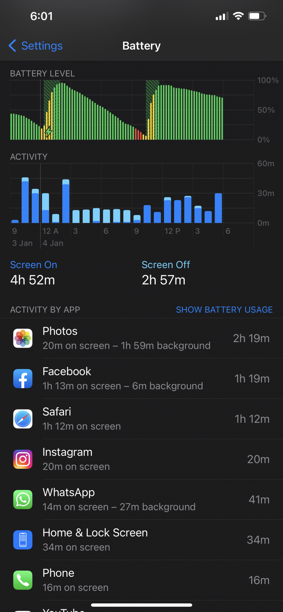

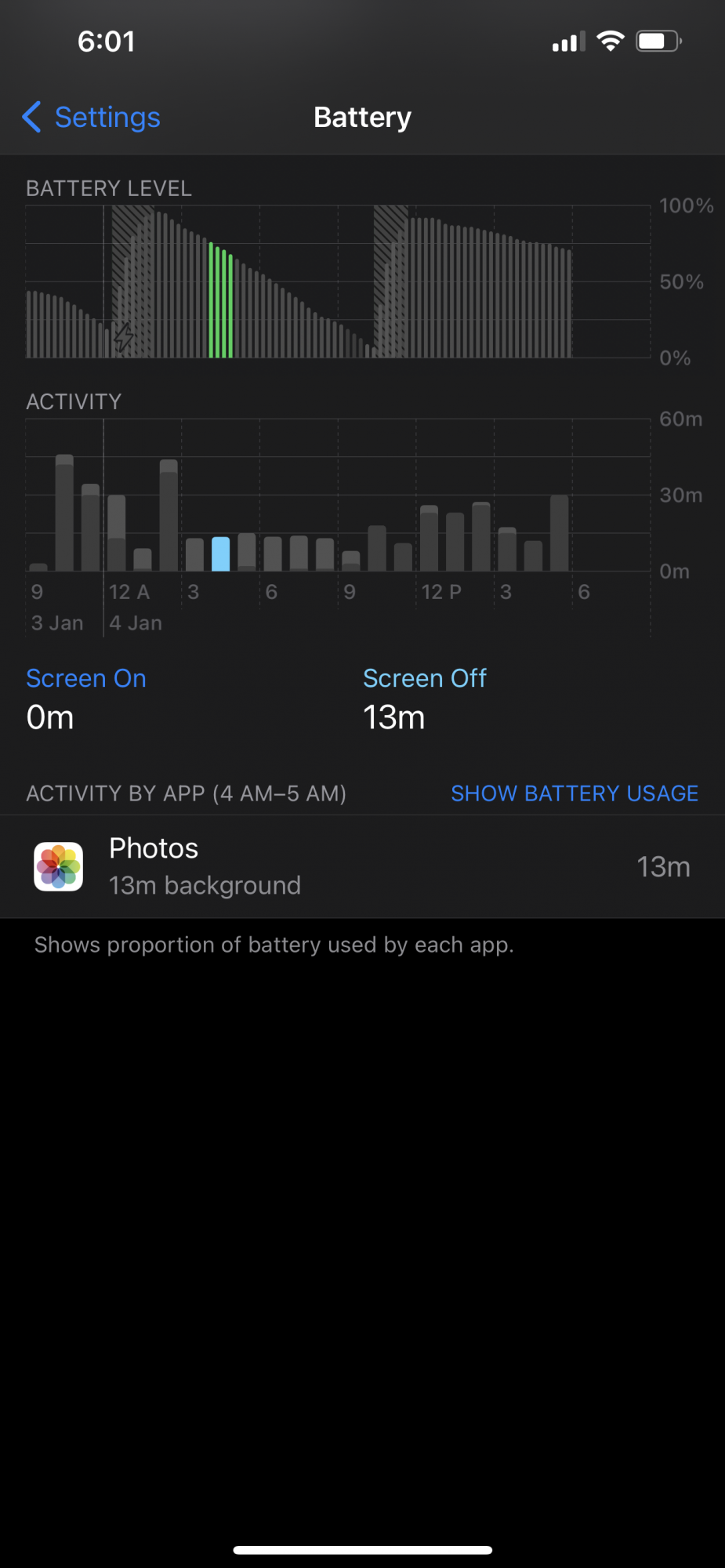

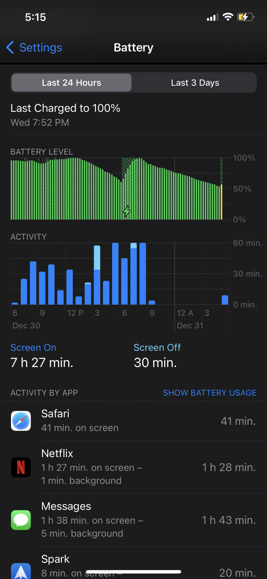

My 12 Pro Max battery drained from ~90% to ~10% overnight last night but turns out the culprit was the Photos app. The app tried to upload a photo all night in the background but probably was unable to do it and kept trying again and again. It was a one time issue though, hopefully.
Reactions: The Cockney Rebel
