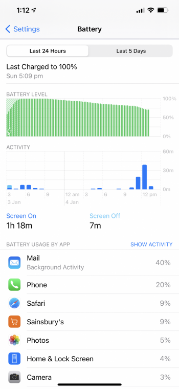

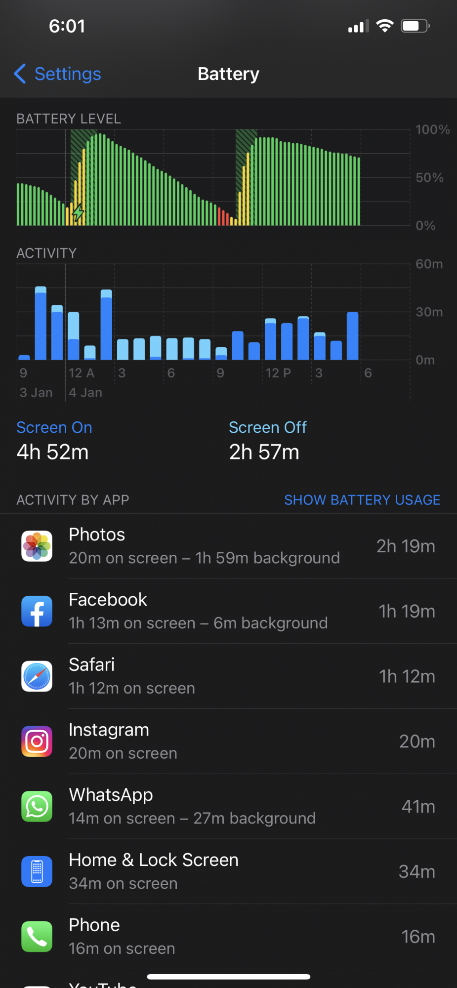

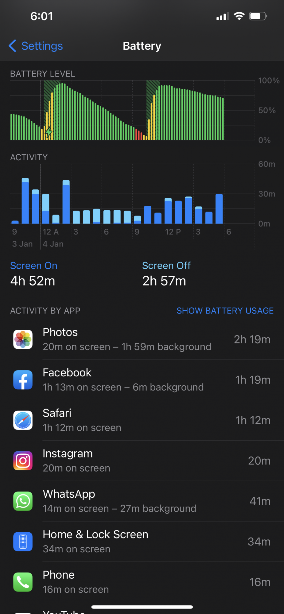

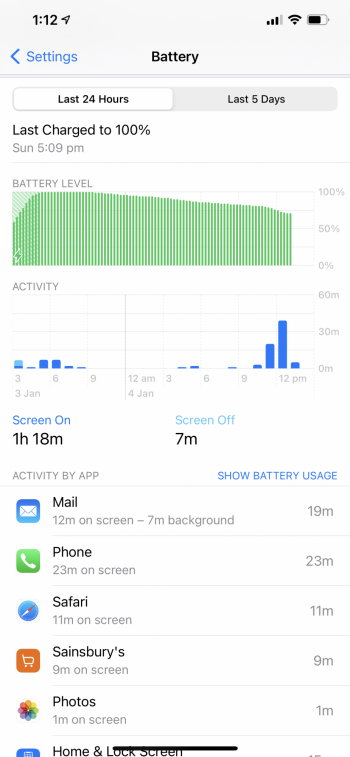

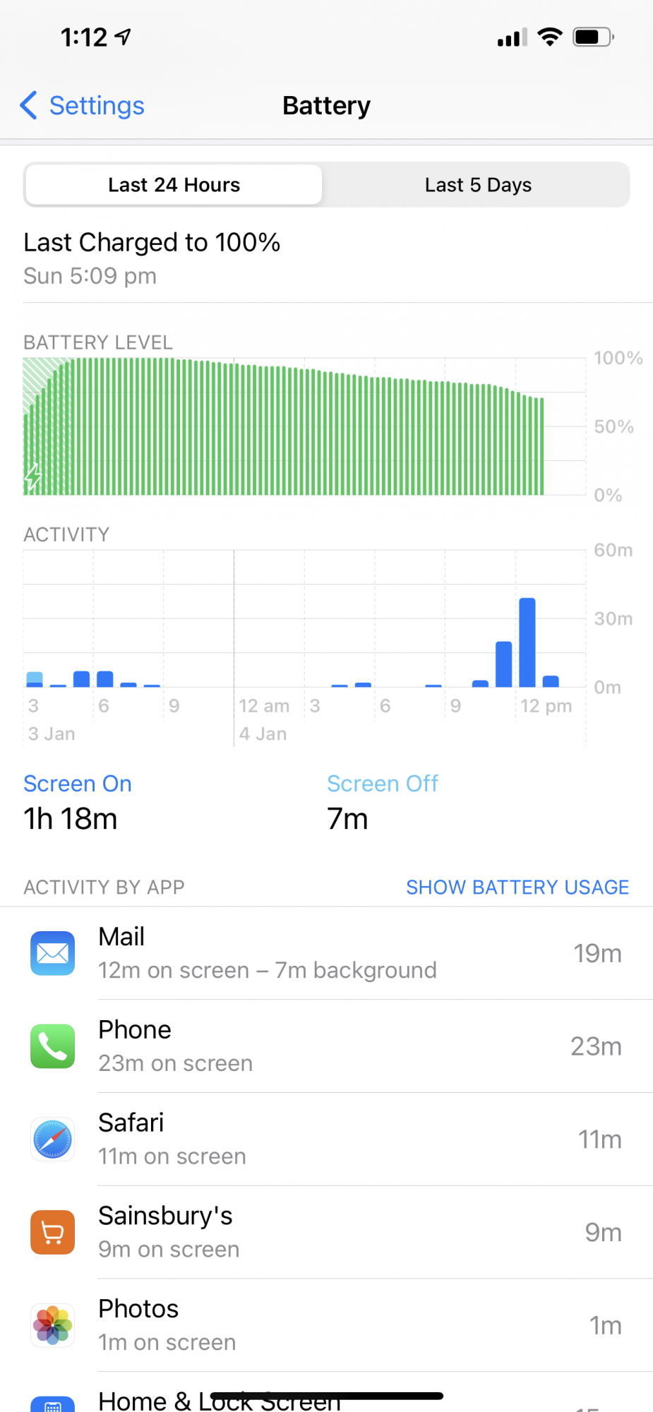

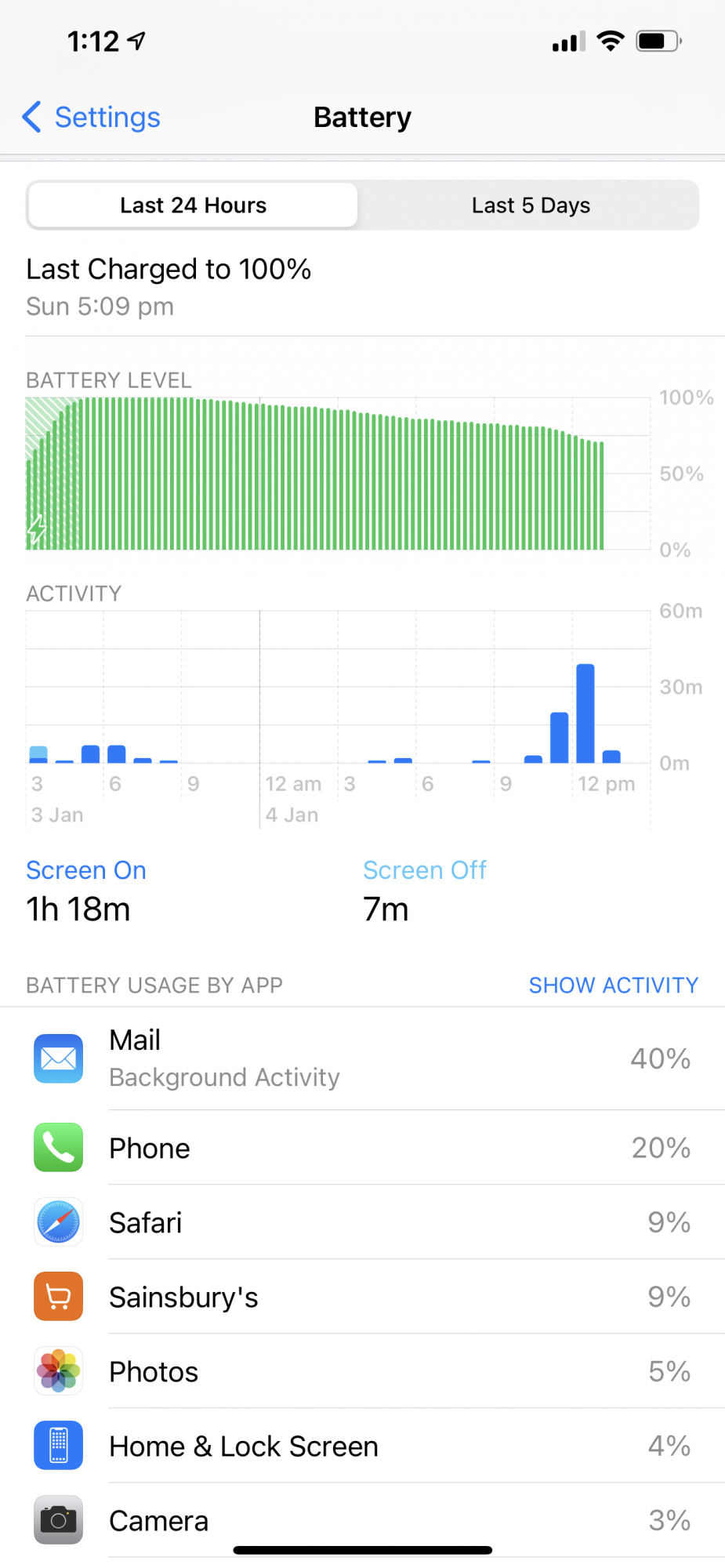

My 12 Pro Max battery drained from ~90% to ~10% overnight last night but turns out the culprit was the Photos app. The app tried to upload a photo all night in the background but probably was unable to do it and kept trying again and again. It was a one time issue though, hopefully.View attachment 1706511
