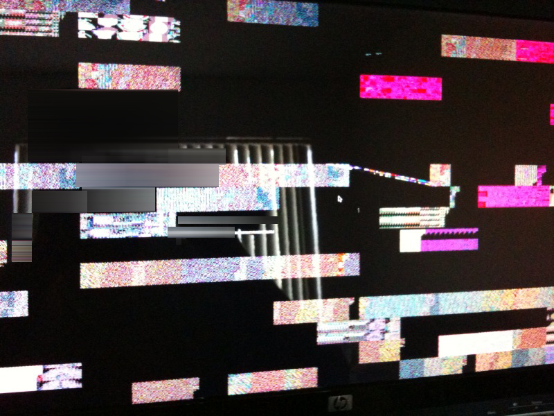

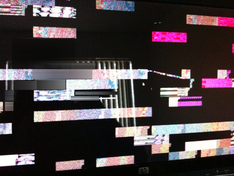

As I promised screenshot of pixels corruption:
I got this line by moving parallels window in last second before freeze. I remember that when i launched my mbp for the very first time i got sound but only black screen while playing the "Welcome" animation and afterwards. Reboot helped. I'm wondering if I'm having only the freeze problem or something else... Although on bootcamp everything seems to work fine.
