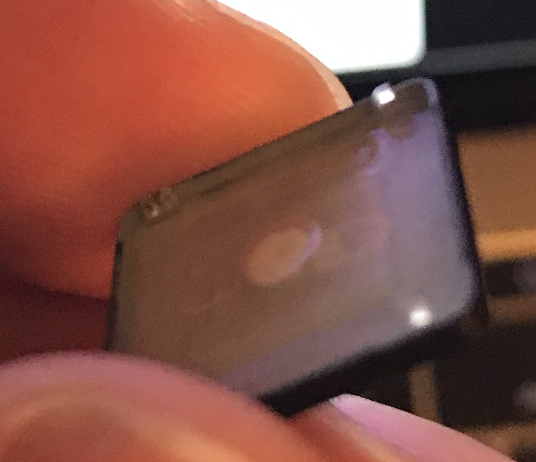

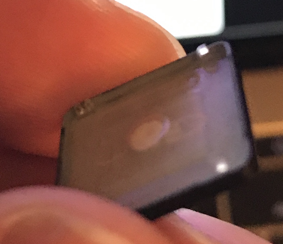

Well that lasted all of 10 hours. 🙁
The '0' key is broken. It was really stiff when I was pressing on on the bottom-left corner of the key, and then it wasn't. This has happened before, e.g. with the spacebar, but this time it appears I broke off the bottom-right pin on the butterfly mechanism while pressing the key on the bottom-left corner. The whole bottom of the key then came loose. I carefully took the keycap off from the still-attached top pins -- the little snaps at the top and the hooks at the bottom are still intact on the key itself -- and could see the little pin piece that had broken off in the key well. Interestingly, it appears that the bottom-left pin was already broken off since I only saw one pin piece in there but both were missing from the butterfly.
I would guess the missing left pin was responsible for the stiffness, which means the key was probably broken during the repair, and I broke the other pin while trying to fiddle with the key to "work through" the stiffness. Sigh. Aside from the key popping up when I press the top of it, the '0' actually feels pretty good when I type on it now.
So now what?
I have ordered a replacement key from ReplacementLaptopKeys.com as they say it comes with the butterfly mechanism. I will see if I can figure out how to replace it myself as I don't really want to go back to the Apple Store again, for what I'm sure will be a useless top case replacement.
On the positive side, I now know what the "shim" looks like -- it's a thin plastic circle that they just stick on the tab on the bottom of the key (see attached and look for the second ring around the tab). Seems like it should not be too difficult to fabricate your own if you were so inclined.
I don't know how Apple so completely messed up these keyboards to the point where they are sticking plastic circles under the keys. 😵
This is most definitely a serious design flaw IMO.
