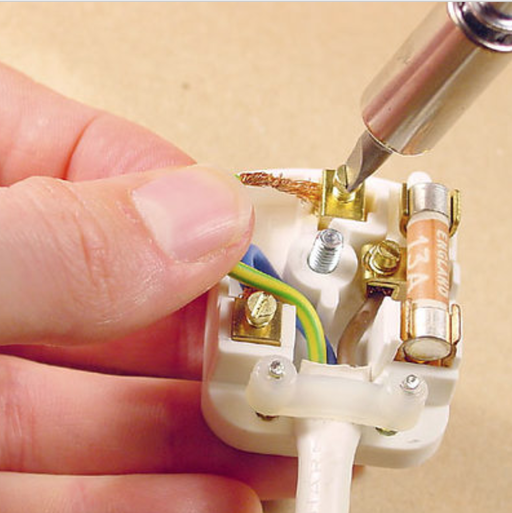

I found a simple solution that silenced my iMac noise (which was outputting over USB into an audio interface and then onward to powered studio speakers). The noise was especially noticeable when moving the Magic Mouse, or bouncing mixes in Logic.
The problem seems to originate in the electrical earth wire that connects the iMac to the wall socket (via the mains lead). I believe the proper term for this phenomenon is "ground loop".
My solution was to improvise a "ground-lift" mains lead by simply cutting away the earth (green and yellow colour) wire at the plug.
I would imagine any standard 2-core mains lead would, effectively, do the same thing. Just as long as it has the correct connector shape for the power inlet of the iMac.
Just to clarify - it needs to be a mains lead that DOESN'T have any earth wire, only live and neutral.
Below is a pic of my procedure, whereby the earth wire (Yellow & Green ) is being disconnected from the large earth pin ( this is a standard 3 pin European plug ). I subsequently snipped the earth wire right back to prevent it accidently shorting off either of the other wires inside the plug.
Clearly, if yours is a moulded plug, you won't be able to carry out the exact same procedure,
in which case I would suggest sourcing a proper 2 core lead ( with NO EARTH ).
Another option, along the same lines, is to modify an old trailing socket board - exact same procedure - just remove the earth connection from the trailing socket board ( either inside the board itself, or at the plug end ).
It's a good idea to label-up your improvised lead / socket board and mark it as "no earth".
Hope that helps.

Sumthin' tells me that having an UNgrounded computer IS NOT a good idea...
Depends on if the computer has an internal power supply or not, there is no earth wire from the power brick to a MacBook.
My Mac mini has no earth wire in the cord, therefor it must be fitted with double insulation, in the EU no earth wire is necessary if it is double insulated.
Here's the marking for it.
If this marking is on the iMac no earth wire is needed, at least not for the EU.

As above, you might find the above marking somewhere on the iMac, if it is no earth wire is needed.
But...as an electrician engineer I would be extremely careful cutting earth wire(s), they are normally there for a purpose.
Never ever...ever cut the earth wire off a malfunctioning washing machine (Earth fault pops), potentially deadly.

Why did you hack at the ground for your computer (which is very unsafe) instead of using a ground loop isolator at your USB audio interface or between the DAC to your amplifier?
And to be clear ... where exactly in the path are you getting the unwanted noise?
I already have a ground loop isolator on the USB cable between the iMac and the audio interface.
It does nothing to remove the buzz and hum and other audible garbage that the iMac produces at its USB ports. As noted earlier, it is especially noticeable where moving the Magic Mouse or when bouncing tracks in Logic.
My iMac is nothing unusual - I have heard this same noise on every iMac I've worked with.
Hacking a standard kettle lead is a simple solution and, as I mentioned, I'll accept whatever potential hazard an ungrounded computer might pose, in order to have a noise-free audio path.
I'm not recommending this procedure to all and sundry - just sharing a fix I found to the initial inquiry at the start of this thread.
OK ... I fully understand you find it acceptable.
So what you are hearing is an audible buzz to your naked ear at the USB ports? Does this happen without anything else plugged into the iMac? That's very interesting.
The noise is electronic, not acoustic. You have to either connect headphones to the headphone
port, or connect an audio interface to a usb port to hear it.
