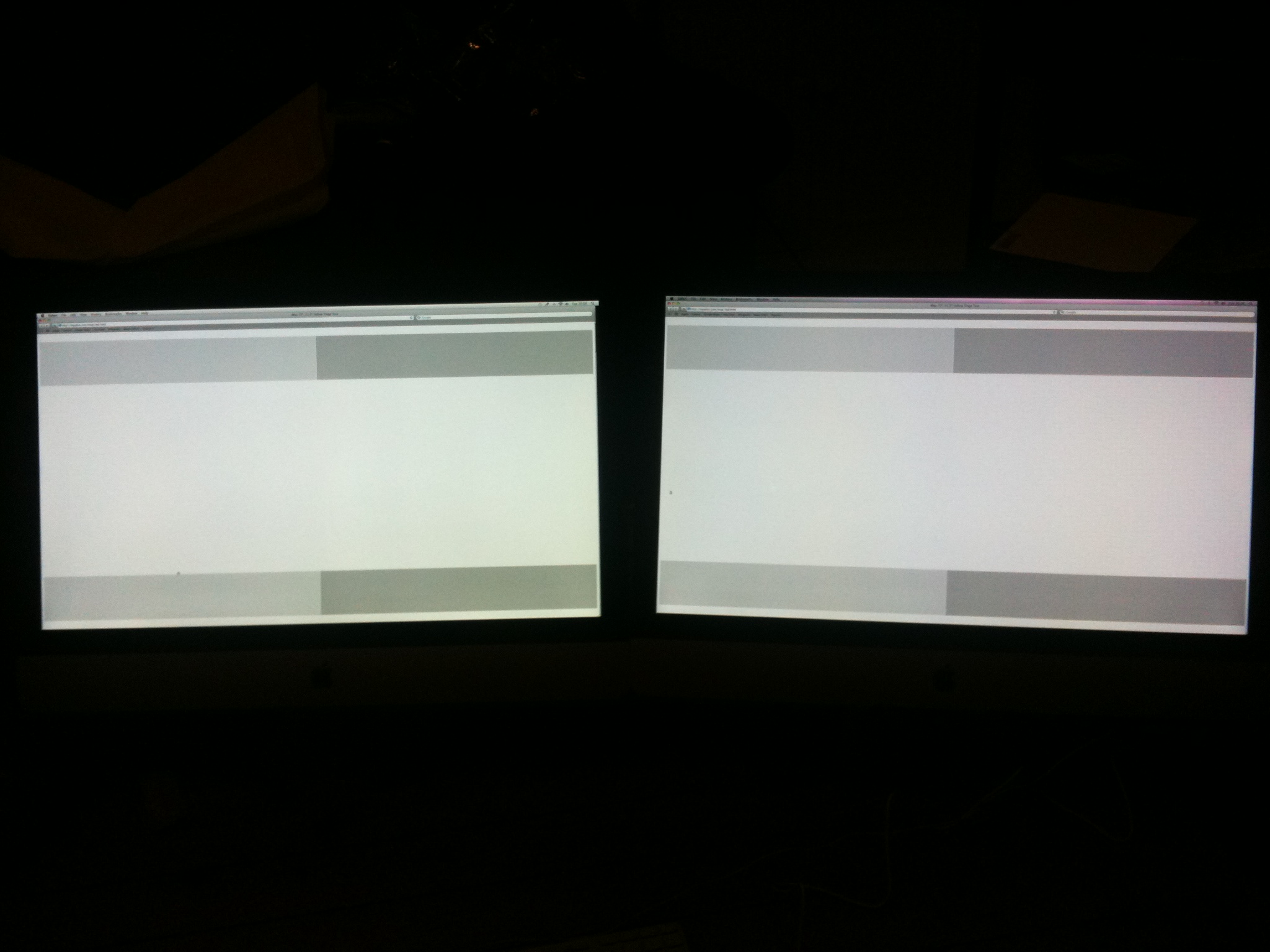

i didnt see the yellowing heres an old plus new side by side.

Yep, That looks awesome to me :) what is their week of production? When did you get the no-problem one?
well its no got the yellowing but.. really bad backlight..
i was watching starwars and space was floodlight lol..
it was a week 53 ??
its in the shop, hope its getting a new screen thats perfect. 3rd time lucky :rolleyes:
