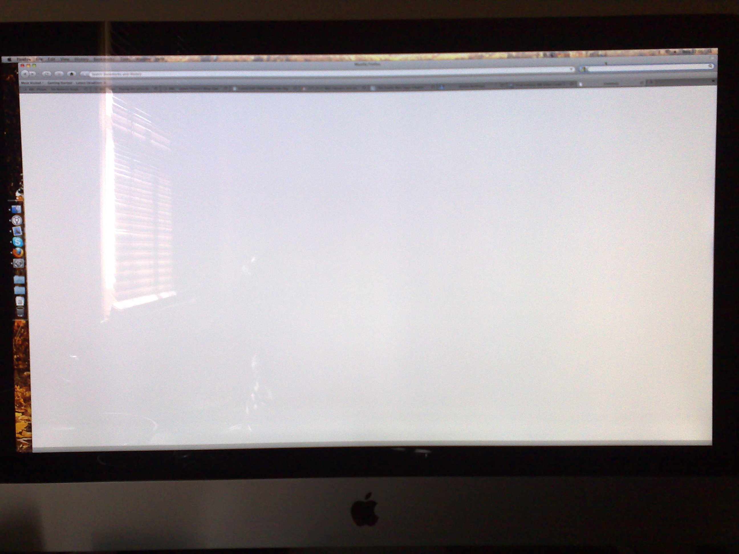

I agree.... boosting the saturation to riduculous, even stupid, levels proves nothing...
Do that with any monitor or any LCD TV and I bet you see variation... stupid "trick" if you ask me...

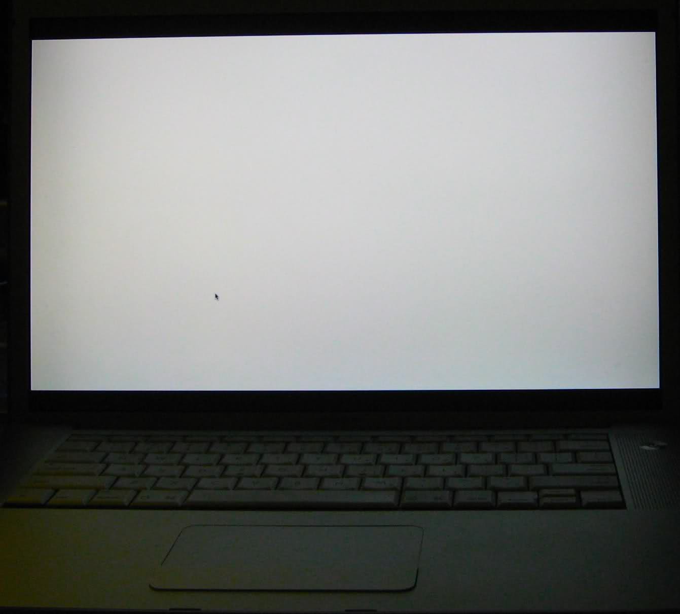

OK, try doing the same saturation boosting with this pic of my 2006 Macbook Pro 15 inch screen. Nothing you could do to the colors on this image would make it look nearly as bad as those images above.
Original:
Saturation Maxed Out with Preview.app:
The worst you get is slight "blue"ing at the bottom right corner, and that could be written off as an effect of the camera.
It is a sad day when an LED backlit IPS display has worse consistency than a CCFL backlit TN film display.

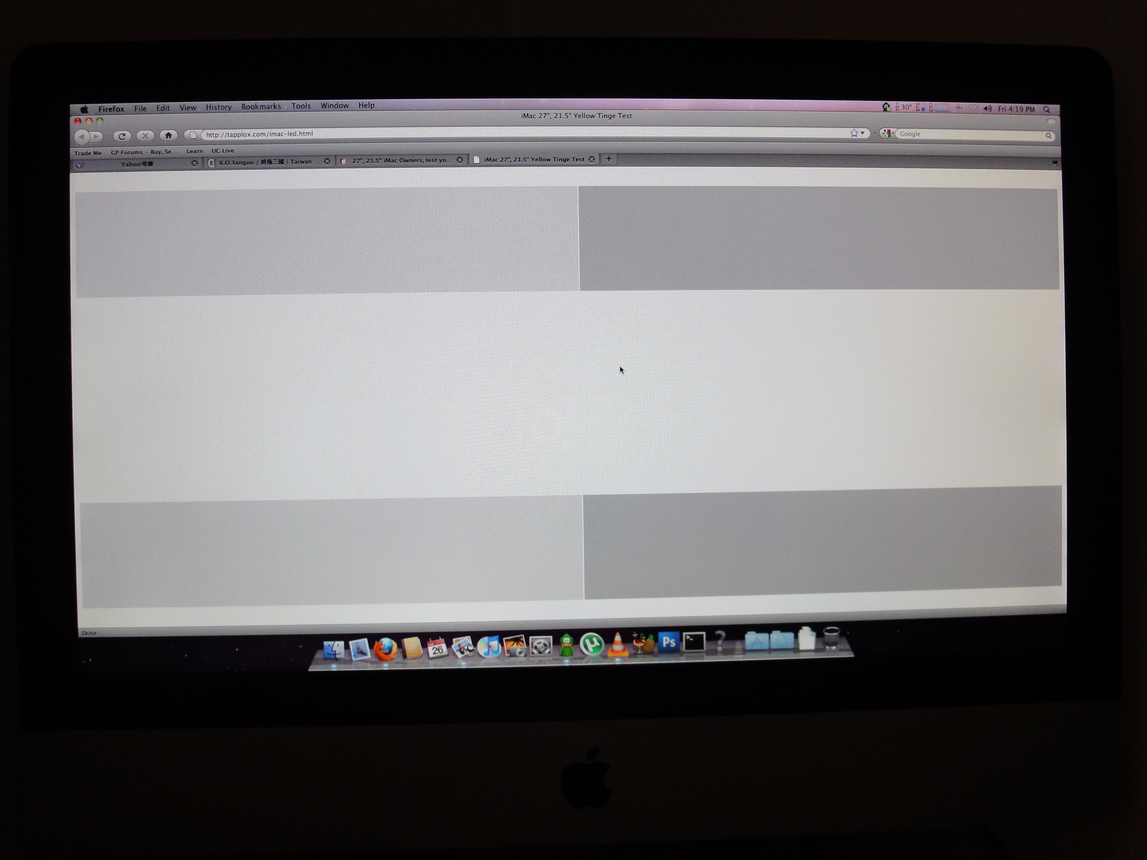

Can you please take a photo and post it here?
Close the blinds, turn all lights off, adjust the iMac so that he is 100 % vertical and take a picture.
I m starting to doubt that there are iMacs without the yellow tinting...
If you have to go as far as closing that dang blinds, turning off all the freakin' lights and adjust the bloody angle of the iMac in order for the tint to become apparent then it's a moot point. Creating this setting is not an everyday type of setting and if your eyes can't see it under normal use then what's the point? 😛

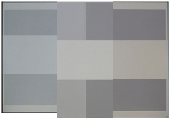

here is mine at full brightness, does it have the yellow tint issue?
The lighter gray bars (Left) both look pretty even. I can see some "warmth" to the right, but compared to the yellow going right up and down my screen, this is one of the better ones I have seen.
However:
When you pop this shot in photoshop and tweak the saturation, and curves (separately) you can clearly see more yellow emerge on the right vertical edge of your screen. It creeps in slightly.
This "test" to boost saturation/levels/curves is not useless by any means.
Digital cameras have sensors that capture light at specific wavelengths to reproduce a specific color.
Upping saturation and messing with curves just helps you see what you couldn't see CLEARLY without editing it. It's harder to see 40px wide of yellowing on a screen with such a high resolution like this one especially when that yellow is surrounded by white, for example. Our eyes need the added contrast to confirm what we thought was there all along.
Edit: avihappy shows how this applies to normal screens in the post atop this page.
The point is, that you have to do this in order to get good results. If you dont adjust the angle, you get even worst results. The more you tilt your display, the worse the yellow tinge gets. And closing blinds and turning of lights is neccesary to make sure that there is no yellow light comming from other sources than your display.

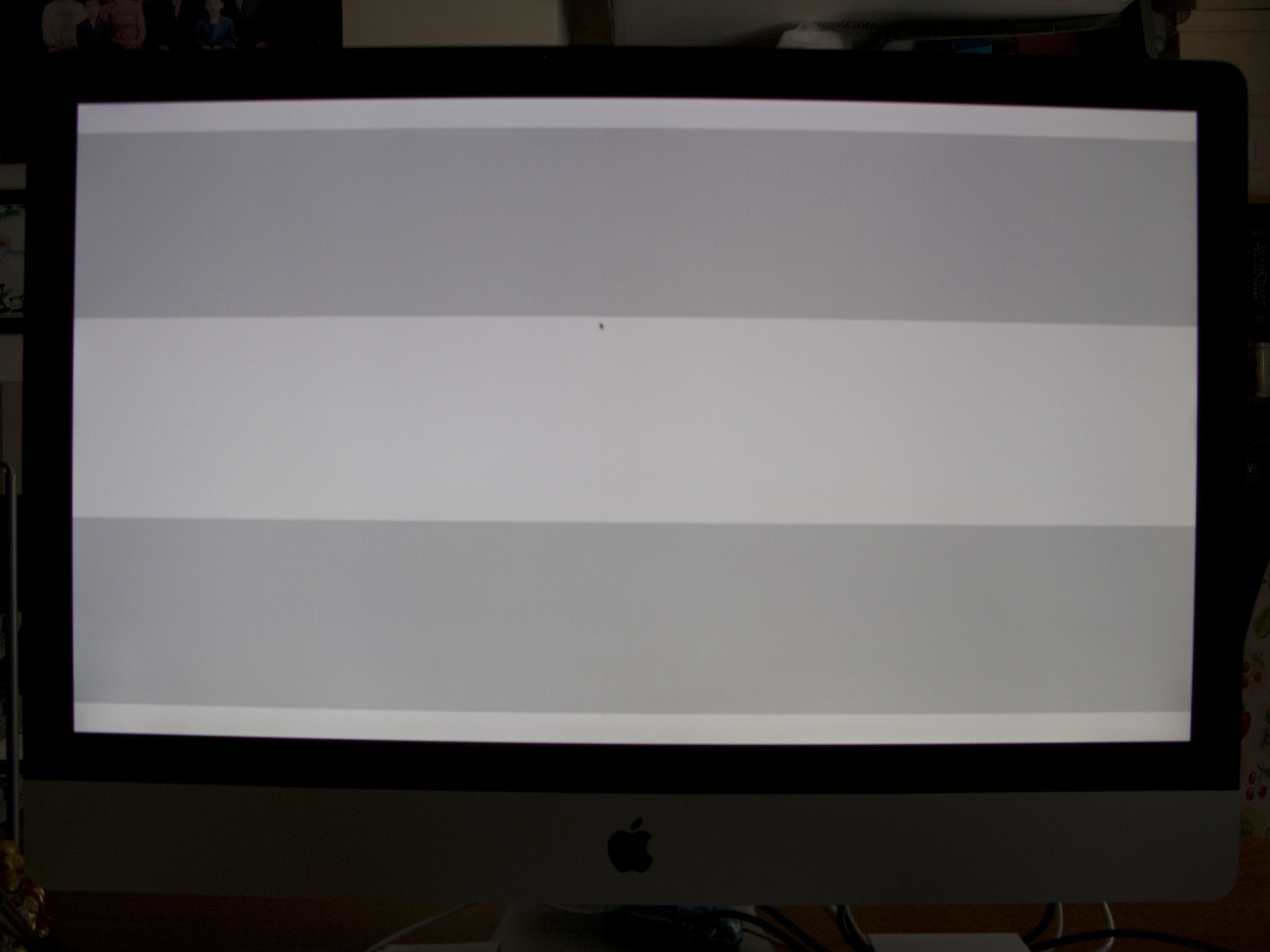

Are there any 27 or 21 that are ok if so I would love to see a photo of them to prove it, I starting to think there are none. People just aren't aware.

I think that aswell. I havent seen a good iMac Display aswell and I m scanning a lot of forums lately. I made a decision on how I m gonna handle the whole situation. I just bought a Dell U2410 for my photo work and I ll put the iMac under my table. I just did another test and split the picture into rows and colums. I then took the corners and middleparts out and put them together. To make a side-by-side compare.

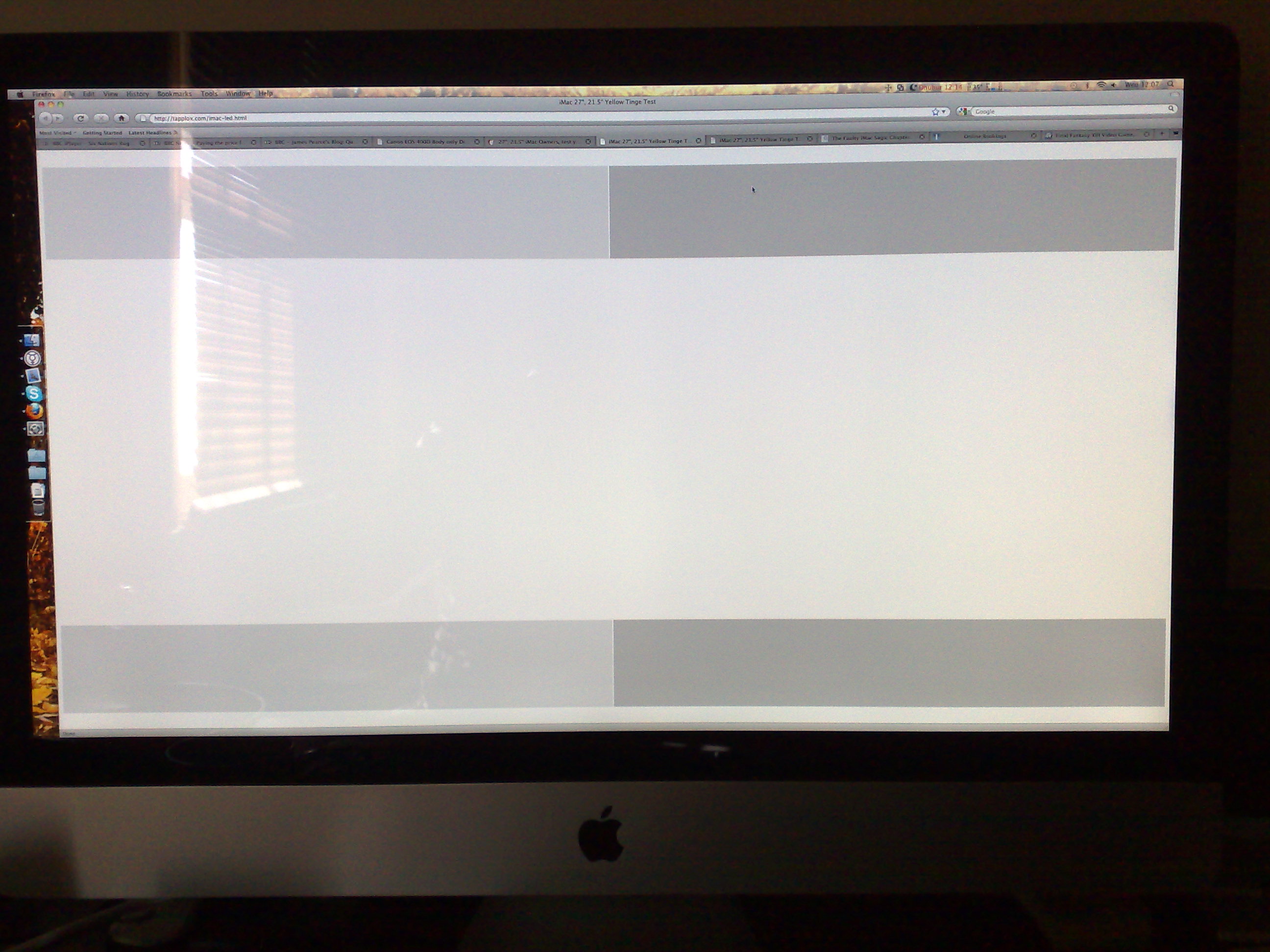

In order to take a good picture, you have to turn off any lightsources. Its not about making the yellowness visible, its about taking a picture of it under optimal conditions for taking a photo!
You can of course leave your lights in the room on, which have a color temperature of 6000-7000°K, you can have the windows open with some 5500°K sunlight and so on. But nobody with a minimum of technical knowledge will believe you that the yellow tint comes from the iMac itself. They will tell you that it is your desklamp or whatever.
Thats why you have to turn everything off.
If you look from a side or a tilted angle, the yellowness gets worse. Thats why you have to adjust the iMac to be perfectly vertical. Else the people will tell you that colorshifts are normal, due the viewing angle etc...
Again,
its not about making the fault visible or anything. Its about making a good photo which OTHER people can judge under controlled and repeatable conditions.
