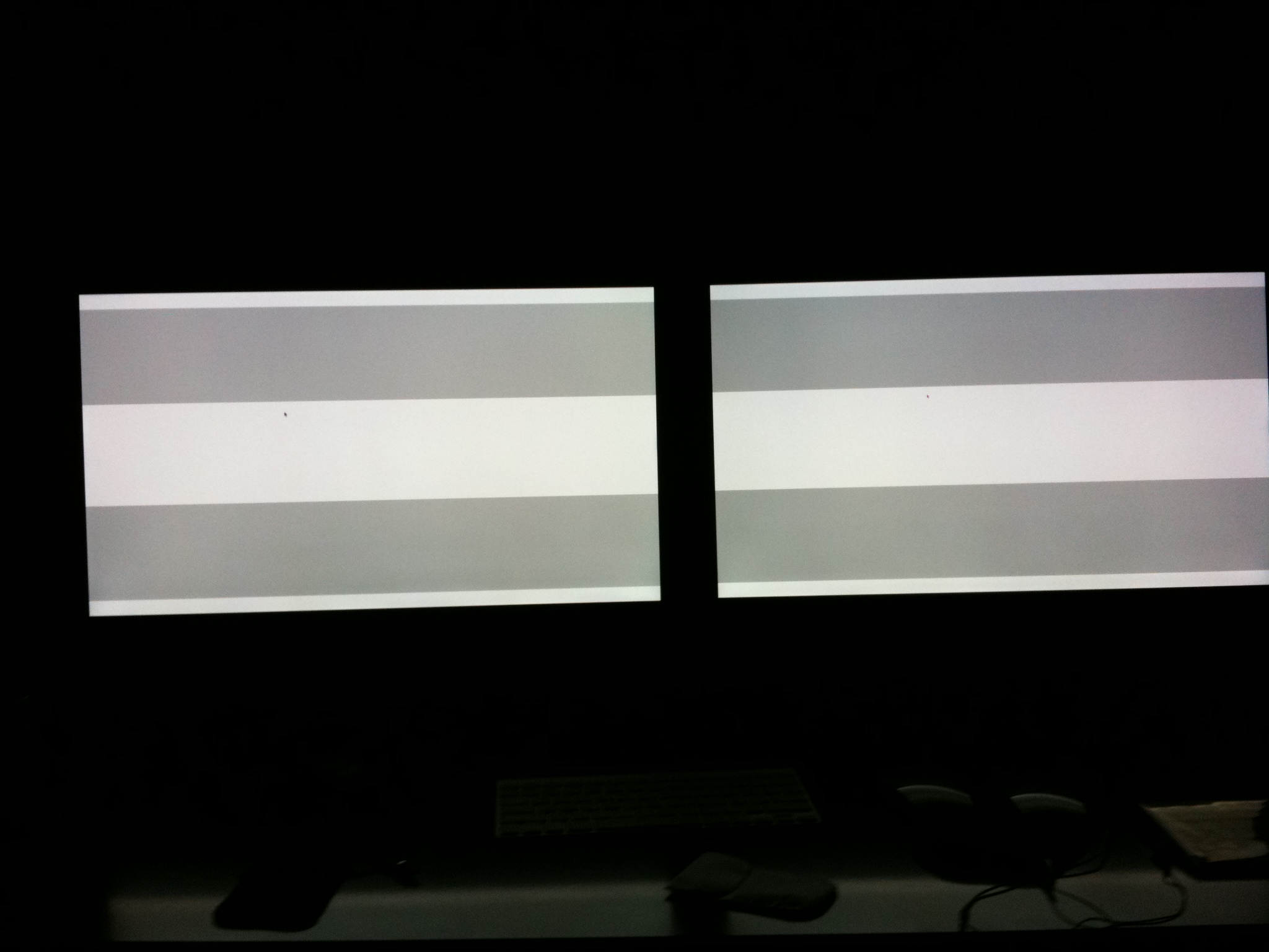

My 3rd iMac was delivered on friday as a replacement for iMac no 2. Since I have them both here, I took some photos side by side. Both are week 10 models made in China. Both @ 50% brightness, same color profile. Photos are unedited except crop/resize.
The displays have a very different feel. Left iMac (nr 2) clearly has yellow on the right side from top to bottom, iMac nr 3 (right) has a yellow tint overall.
Perhaps in looking for a solution Apple has increased the yellowness of the screen to prevent the spots from standing out? But even iMac 3 (right) seems to have an increased yellow area on the left of the middle.
I'm currently undecided on which one to keep, or returning them both.

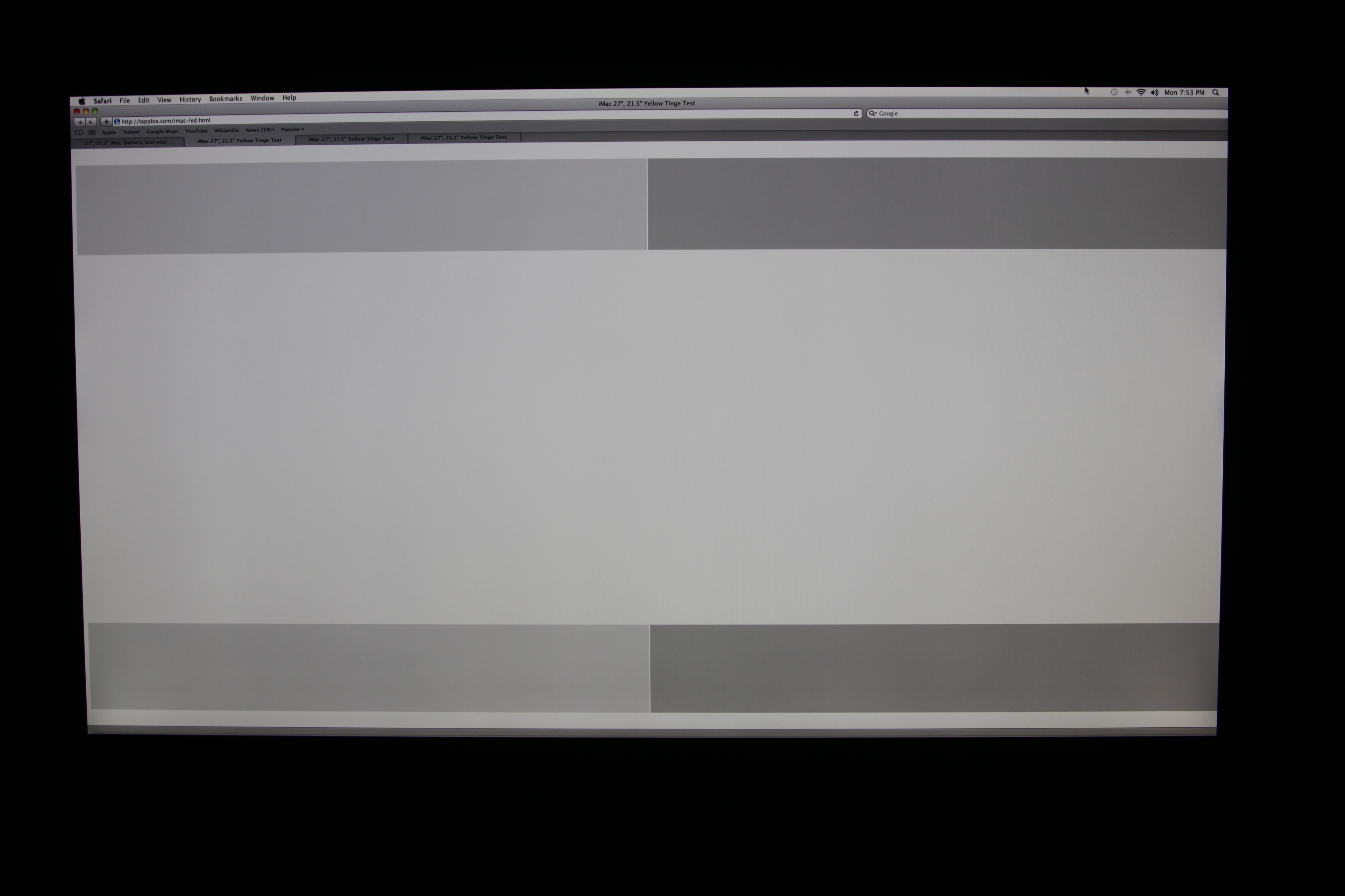

It looks yellow towards the bottom, but what's worse is the cloudiness of the grey strip -- brightness is not uniform, probably have something to do with light bleed.

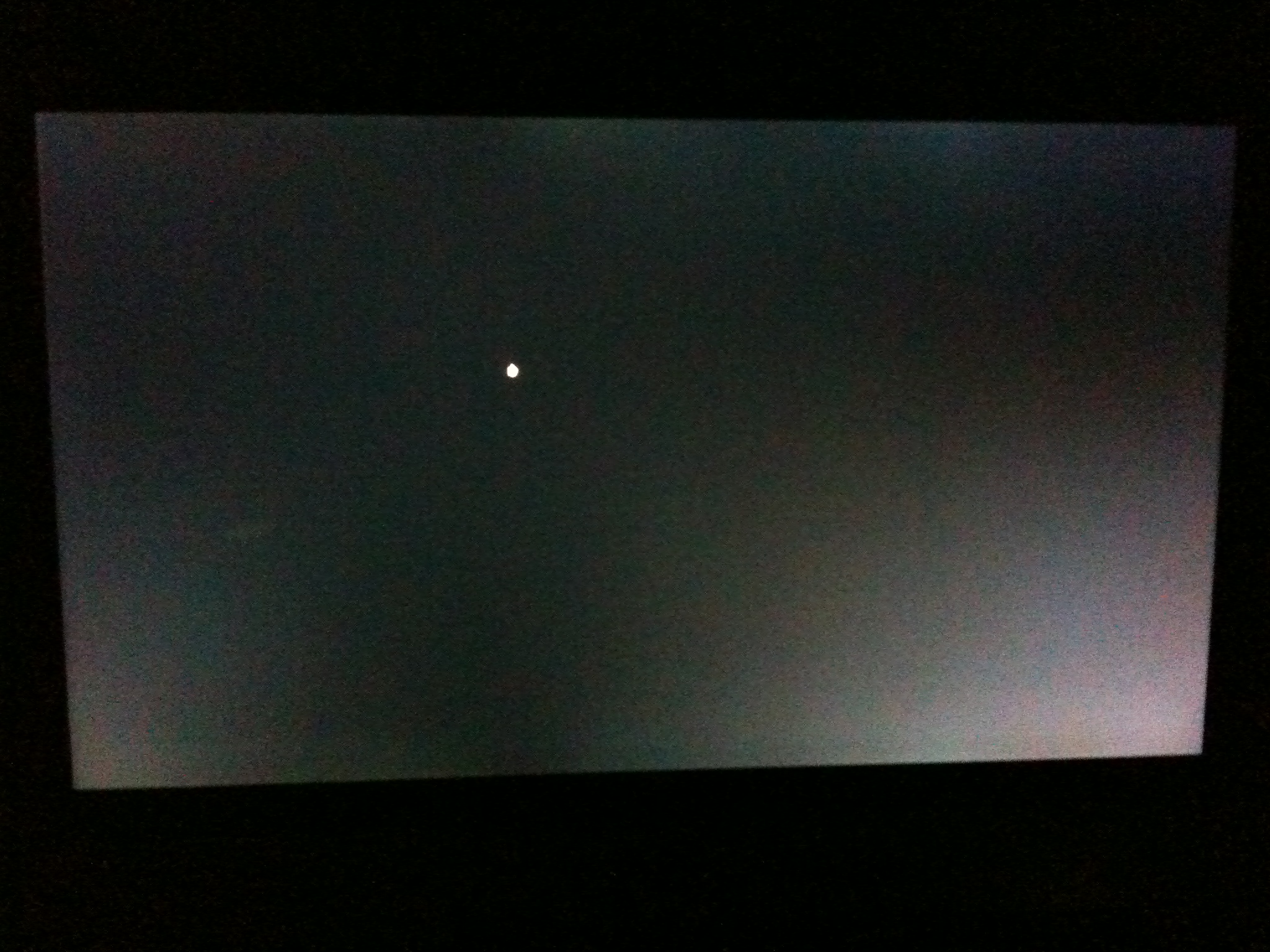

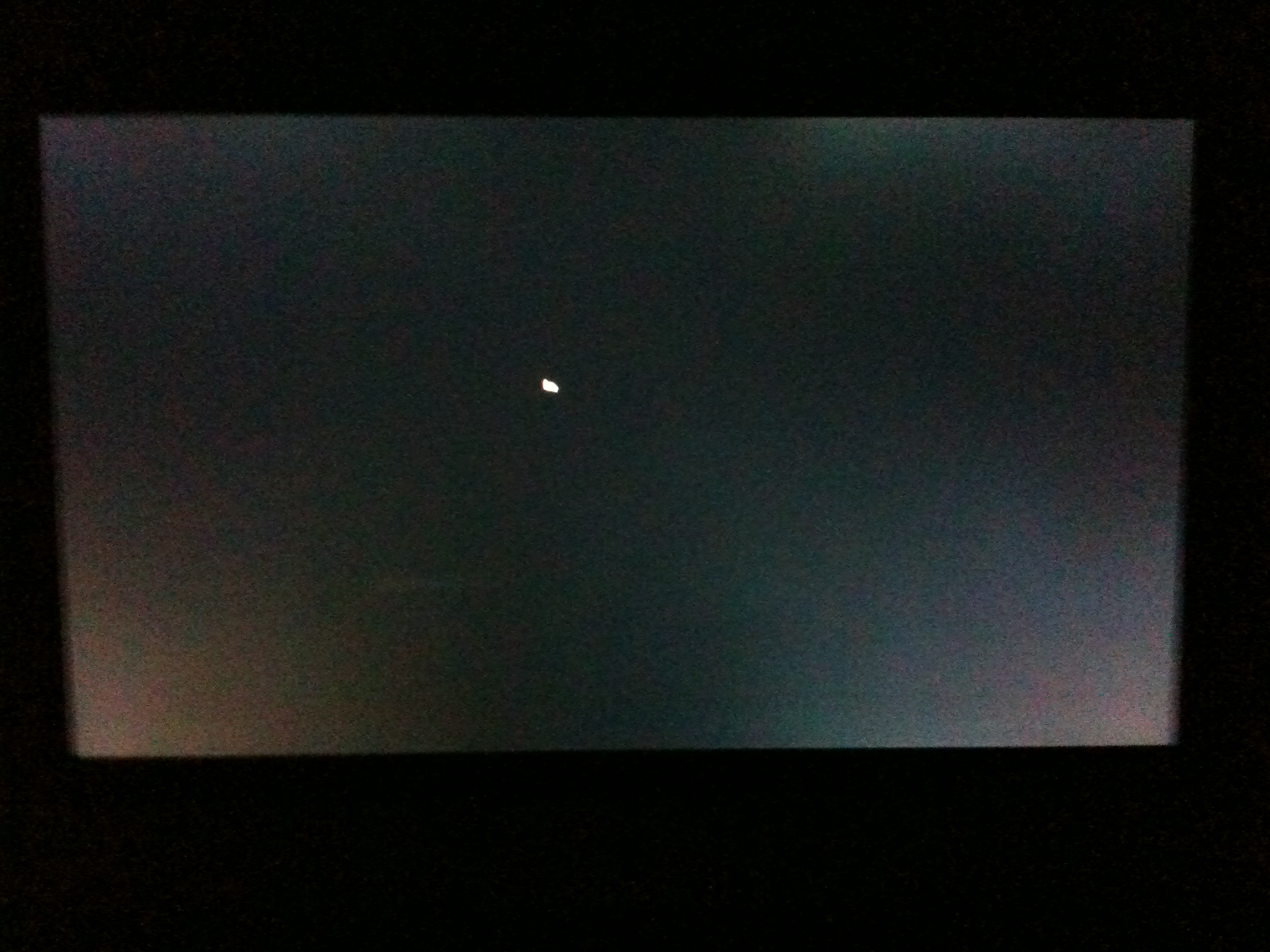

Just got a week 9 replacement.
Right now there are a week 6 and week 9 in front of me.( will need to return the week 6 later)
From all the testing i can notice the yellow issue had a great improvement. You can notice the comparison of both screen the grey area of the week 9 (RH) is darker, where the week 6 is a lot lighter and tend to be yellowish.
But not the backlight bleed, this week 9 is worst than the week 6.
Overall I am satisfy with the week 9, but maybe i will give another try to get one more replacement since i notice the quality is improving, I might be ending up with a perfect one.
For those who still worrying, I think you can buy it safely now, at least it reaches 85% of perfectness.
P/S: please request if you want some more comparison, while I still have both of it.

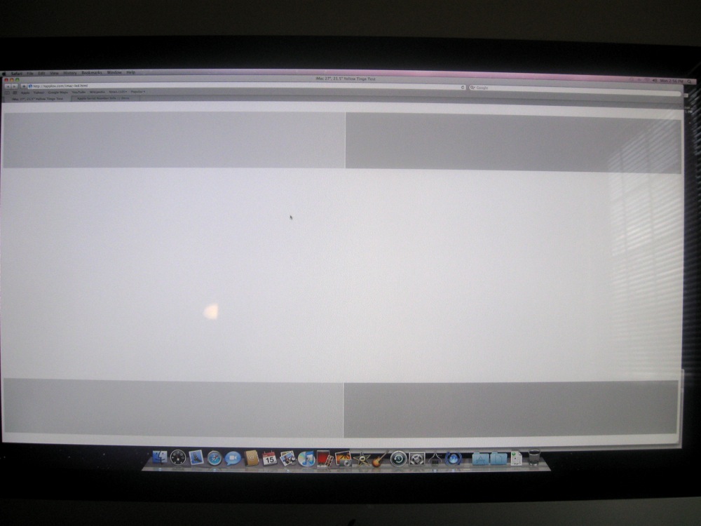

Not only is my screen still yellow, but the band of tiny rectangles in a big smudge across the middle of the screen is still there too.
It looks fine to me. For the back-light bleeding, it seems nothing if compared to mine. I got it every corner of the screen and all are bigger than yours. I posted my screen pictures in few pages back. Page 63 I guess
Anyway, It's a keeper to me.
Thanks. I'm not sure if there is a bleed - when in full screen black it looks fine from a dead on straight angle. At angles other than straight on, the corners and sides look a little lighter, but they look consistent as I move around.. seems normal to me..?
Will have to take a picture tonight when it's dark.
