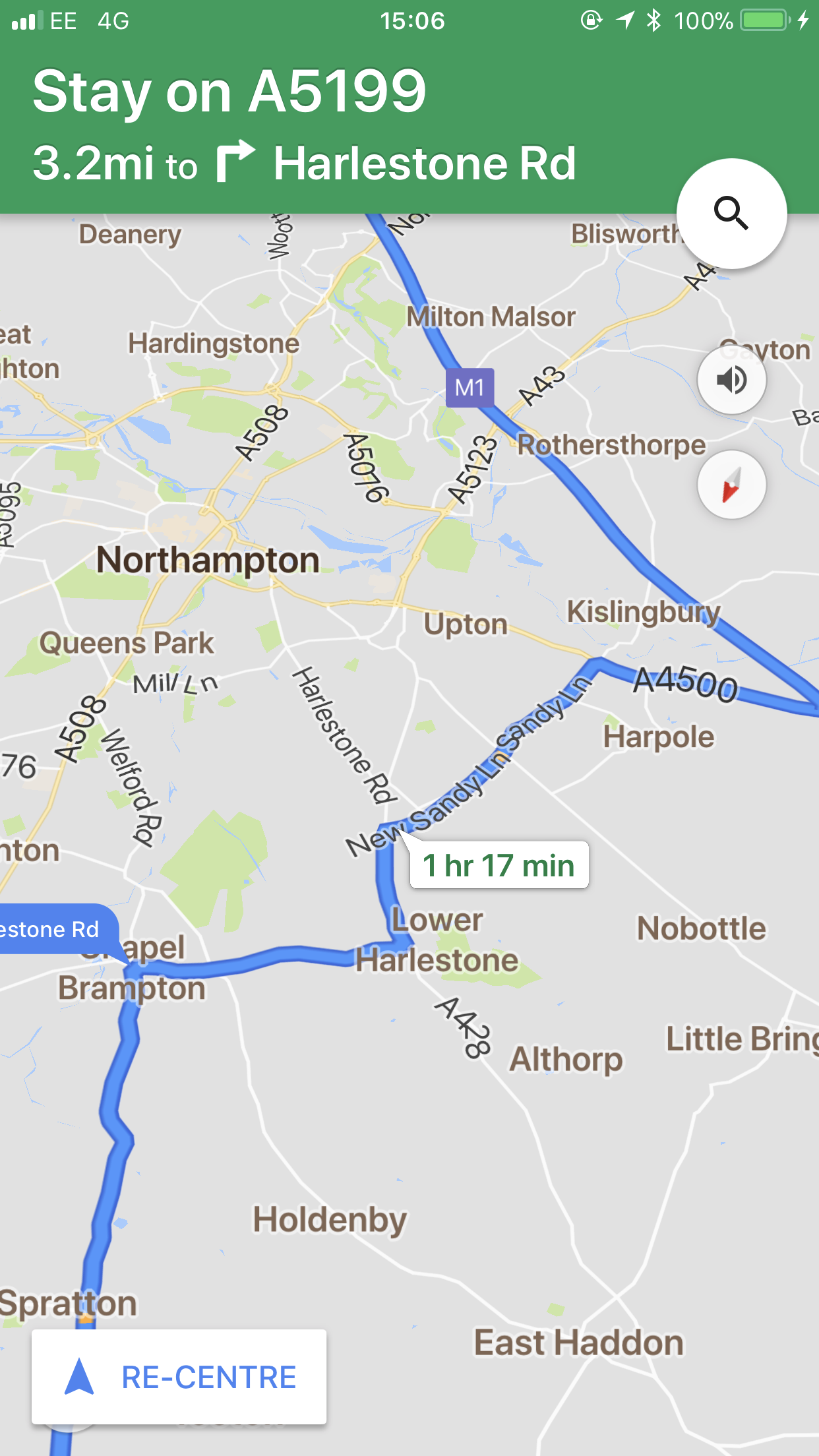

I don’t know if this helps but I turned my phone off and had steady connection all the way to the M1
