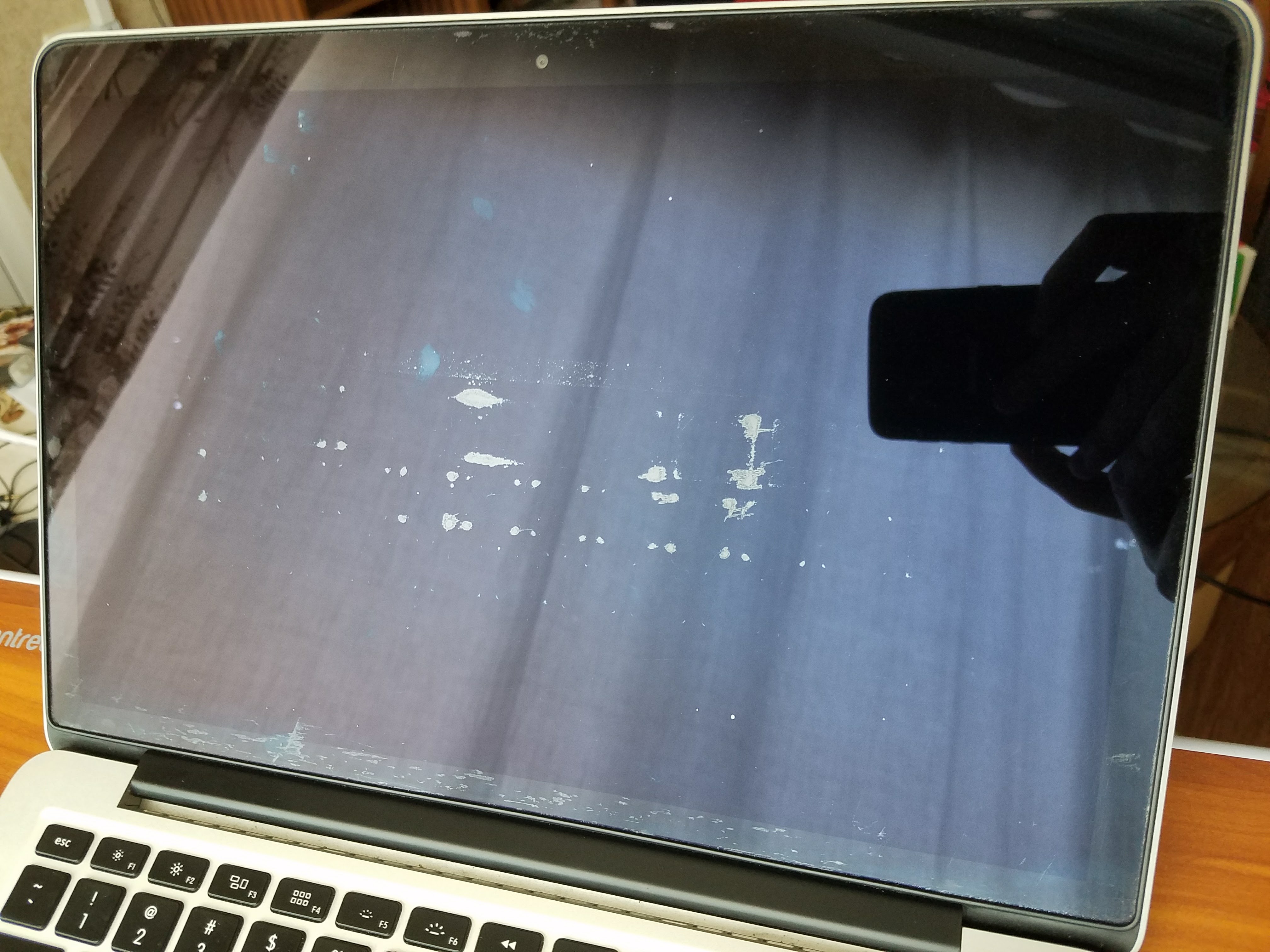

My 13" late 2013 MBP screen got replaced yesterday! It took less than 30 minutes to replace.
The replacement screen arrived in exactly a month to the AAD in Armenia.
The old screen got dozens of small dots thanks to key corners after around a month I purchased the laptop in June 2014 and during last few years the coat got ripped off in few areas in the center of the screen. It was noticeable and annoying. ( look to the attached photo ).
The new screen not only looks crisp with undamaged coat in place, but it also fixed the "image retention" issue I had with the other screen. No matter how long I keep the same image in the screen it doesn't persist. With the old one after around 5 minutes of keeping the image on screen it was "printed" and was clearly visible on gray background. As there is no way to check, is it possible to say with certainty who is the manufacturer of the screen? Like the old one was from LG and the new one is Samsung?
Also wifi antenna got replaced too as it's inside the clutch in the bottom of screen lid. My wifi connection was dropping occasionally at least once per day with the old one. Seems to be fixed with the new antenna as it didn't happen until now!

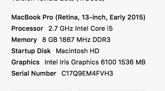

thank you macrumors for this notification. upon reading this on your front page, i noticed that this was an issue on my MacBook Pro (Retina, 13-inch, Early 2015). after going to their chat, i made genius appt last week and got it fixed at zero cost.
