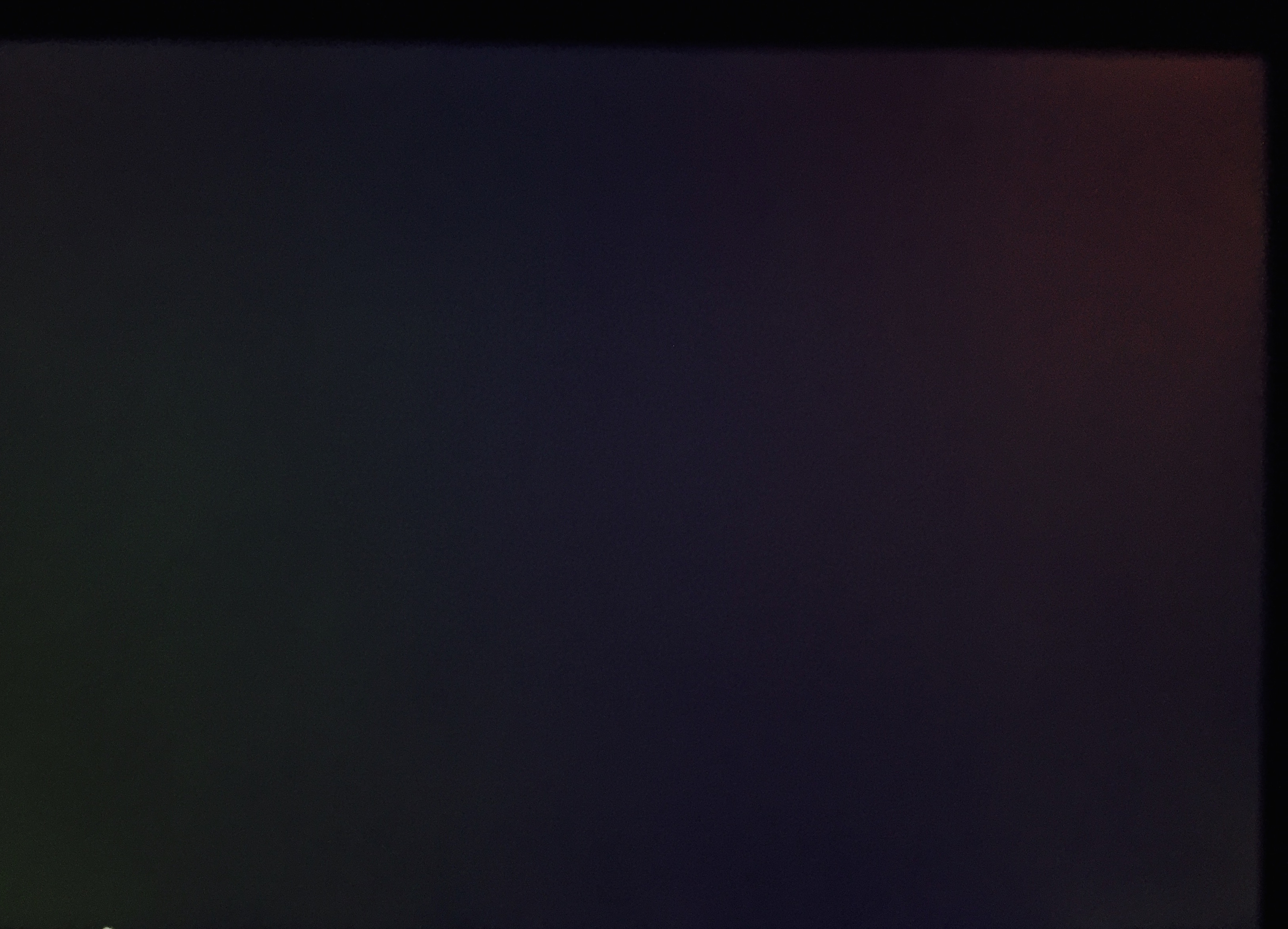

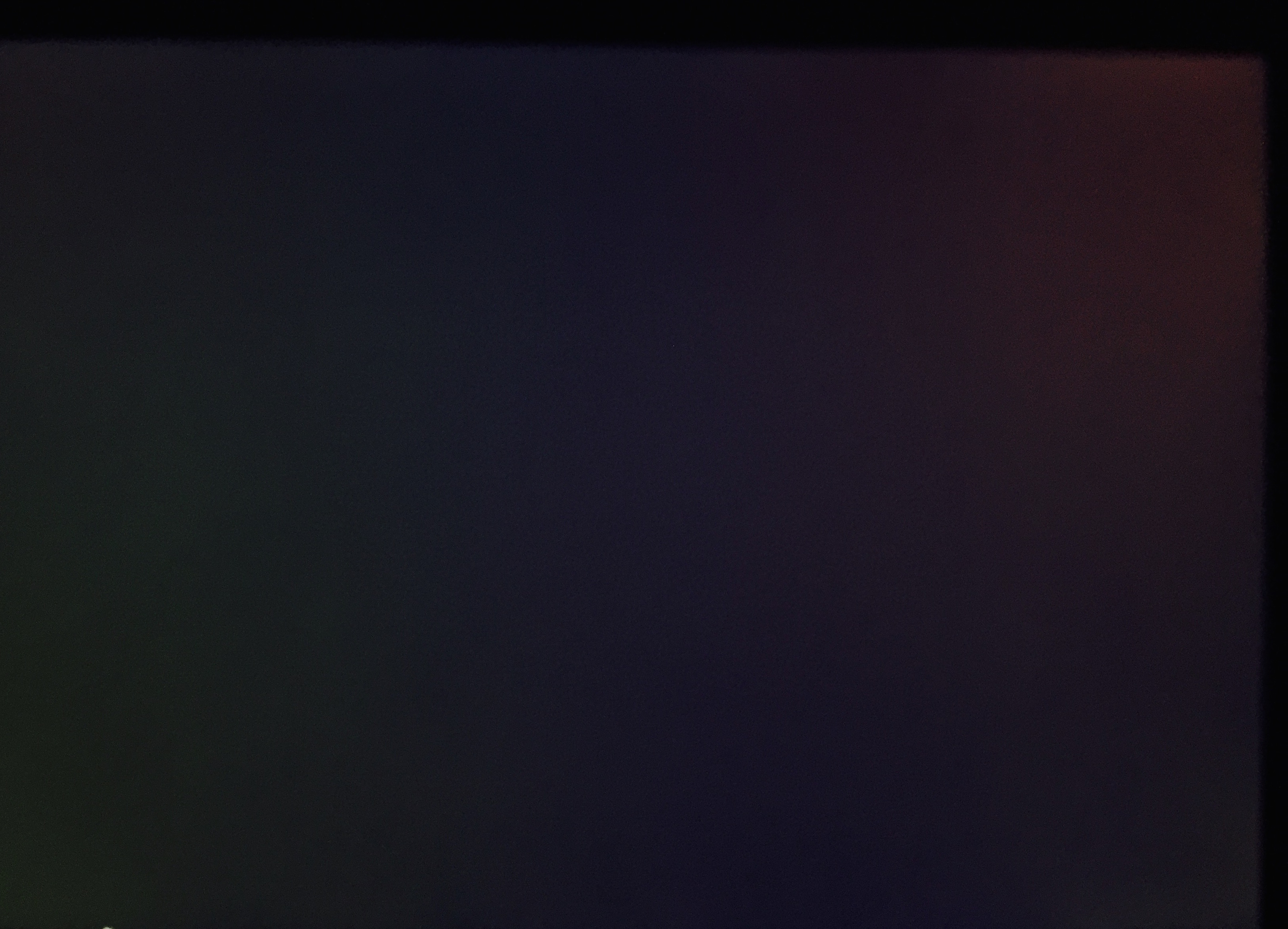

So after they replaced my PERFECT retina samsung display - due to "insufficient documentation" provided by the person who inputed my repair order - I'm on my 2nd LG display this week.
Color LCD
LP154WT1-SJA2
DCN505300EPFDR3A5
Color LCD
Attached is screenshot of uneven color - Should I have it replaced ?
No IR as I can see -
It's green on bottom left - Red on top right
I had my LG replaced by LG rev. II due to retention issues and some say it is even better than Samsung (better blacks).
They replaced my screen without consent (perfect screen) replaced with Samsung rev 2 - ****ing yellowed
Sent in again and now dealing with bleed - I regret even sending it in !
I'm going to see if I can get replacement... This is unbelievable ...
