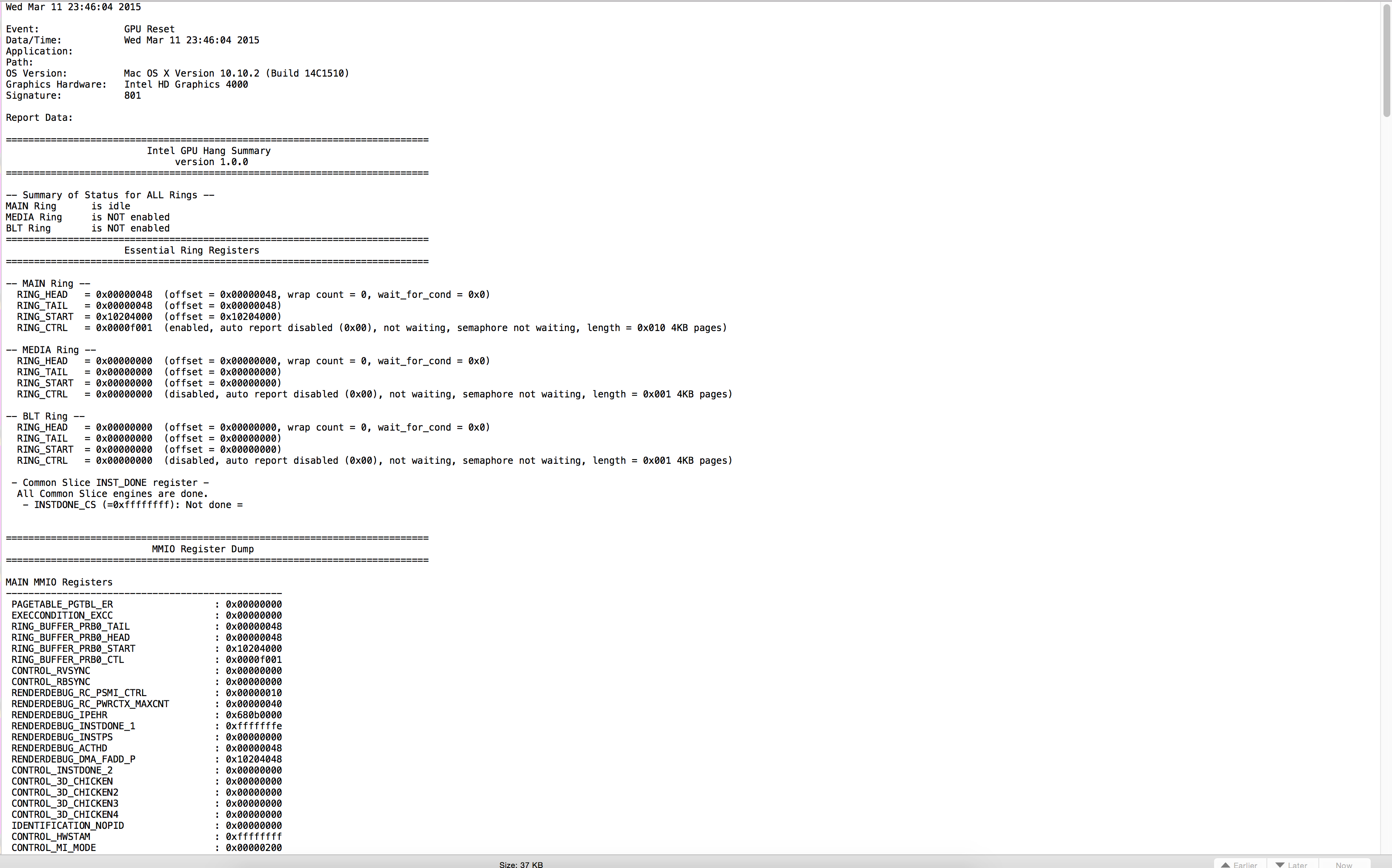

Early 2013 MBPR 15 distortion problems
I have been lately having problems with the video distortion and the system seems to be reboot automatically.I went in to the store but strangely the system has passed but i am pretty sure that the problem exists.The Genius guy has asked to drop in for a 48 hr extensive test.I am not sure if i have to payout of pockets for any repairs? I however see some GPU in the logs.Does any one have an idea about this.
You shouldn't have to pay out of pocket. If they were going to charge you, as would be the case with any third party retailer (note they didn't make anything when you purchased that notebook) you would sign off on a repair estimate. It's likely that they just want to verify the problem. Note that extensive testing just means set it up in the back where no one will disturb it and allow tests to run until they either complete or fail out.
Thank you. Do you know what the error on the logs means.Is this related to GPU or logic board ?
GPU is part of the logic board. This appears to be a 2012 or early 2013 15". It's a core dump, and I'm not an expert when it comes to reading them. There aren't any obvious points jumping out at me, but if it was trying to switch to discrete graphics right when this happened, that would be a good indication of a gpu problem, which is also a logic board problem as the two are soldered. Apple has a repair program for these if that is the case. If they didn't have one, I would have suggested depot repair ($330 flat to fix any and all problems).
