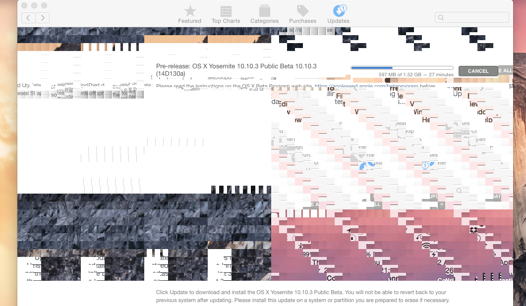

I have a 2012 15" MacBook (not retina) so technically it's not covered (I think) but I've been having the issue seen in the screenshot (sometimes the whole screen, not always confined to one program window)
Can anyone advise?
Can anyone advise?
I'd take it into an Apple store and see what they say?
