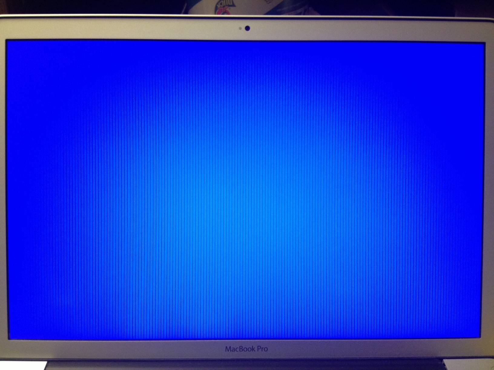

Also, I've posted about this before. I attached a photo I took of the vertical lines that would appear, back when the computer actually booted up. People said that's definitely the GPU problem covered by this program. Unfortunately I wouldn't be able to reproduce that now, since I can't boot past the white screen.
If it does that, they'll be able to verify it. The only way you can get past that is by disabling your gpu kernel extensions in single user mode, but that certainly won't facilitate testing. I would only suggest it if you needed to back up stuff.

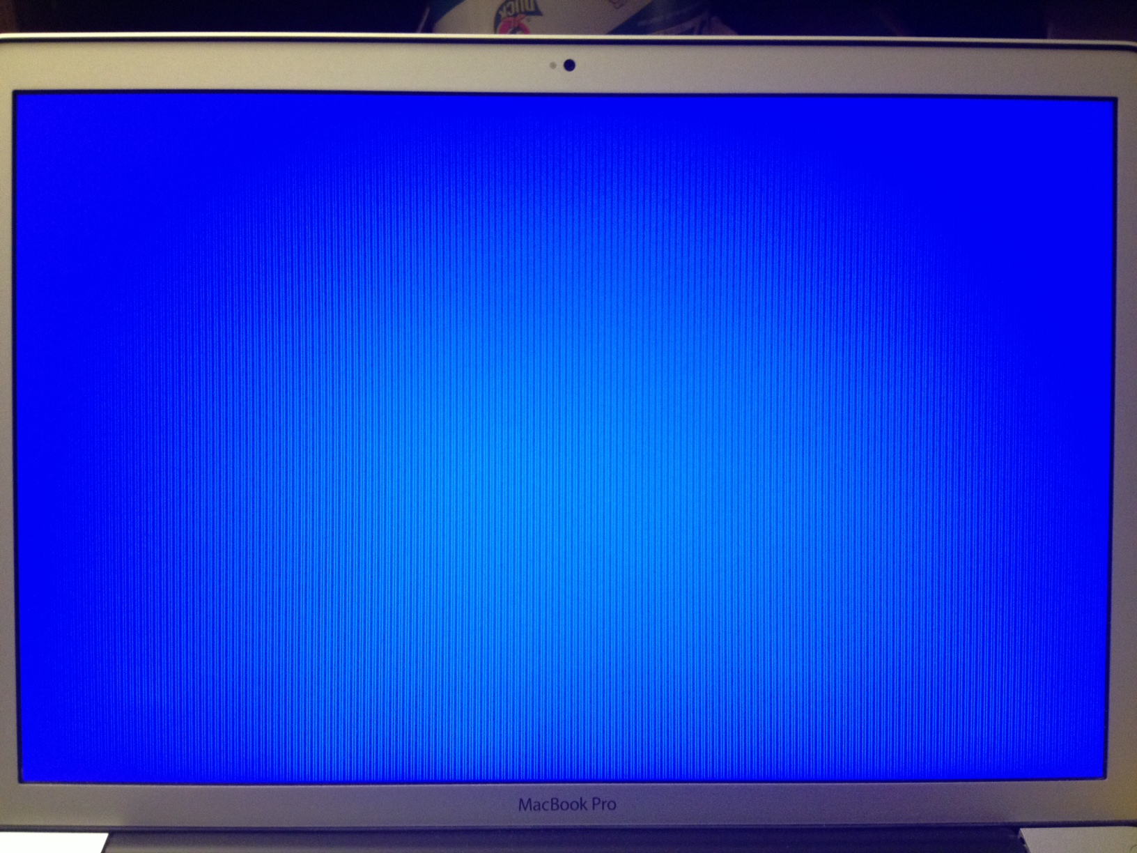

If it does that, they'll be able to verify it. The only way you can get past that is by disabling your gpu kernel extensions in single user mode, but that certainly won't facilitate testing. I would only suggest it if you needed to back up stuff. Also that looks identical to my own. It just crashed one day without warning... so much blue 🙁.
