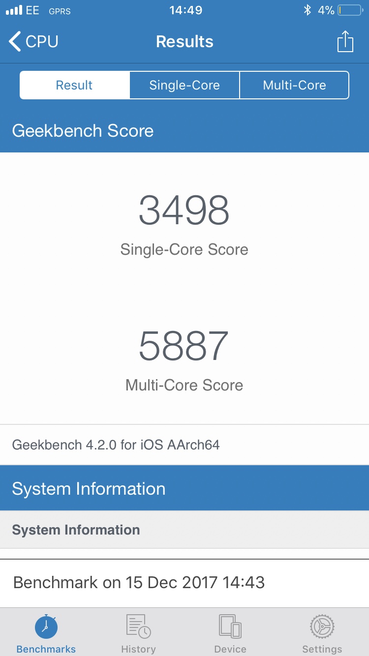

Just had my iPhone 7 battery replaced at Apple. I had to pay because it passed their tests despite it losing 15% in 10 months. I tried to explain about this thread and benchmarks but wasn’t having any of it. Anyway here is the benchmark taken when battery was at 6%! All back to normal. I will be complaining to Apple as I believe I shouldn’t have had to pay.
Glad you are back to full speed!

Cost £79. I’ve been onto chat support raising a complaint and trying it get across that losing 15 percent in 10 months mean battery is defective, my cycle count was 323 which they said was high, anyway they are requesting a refund for the charge.

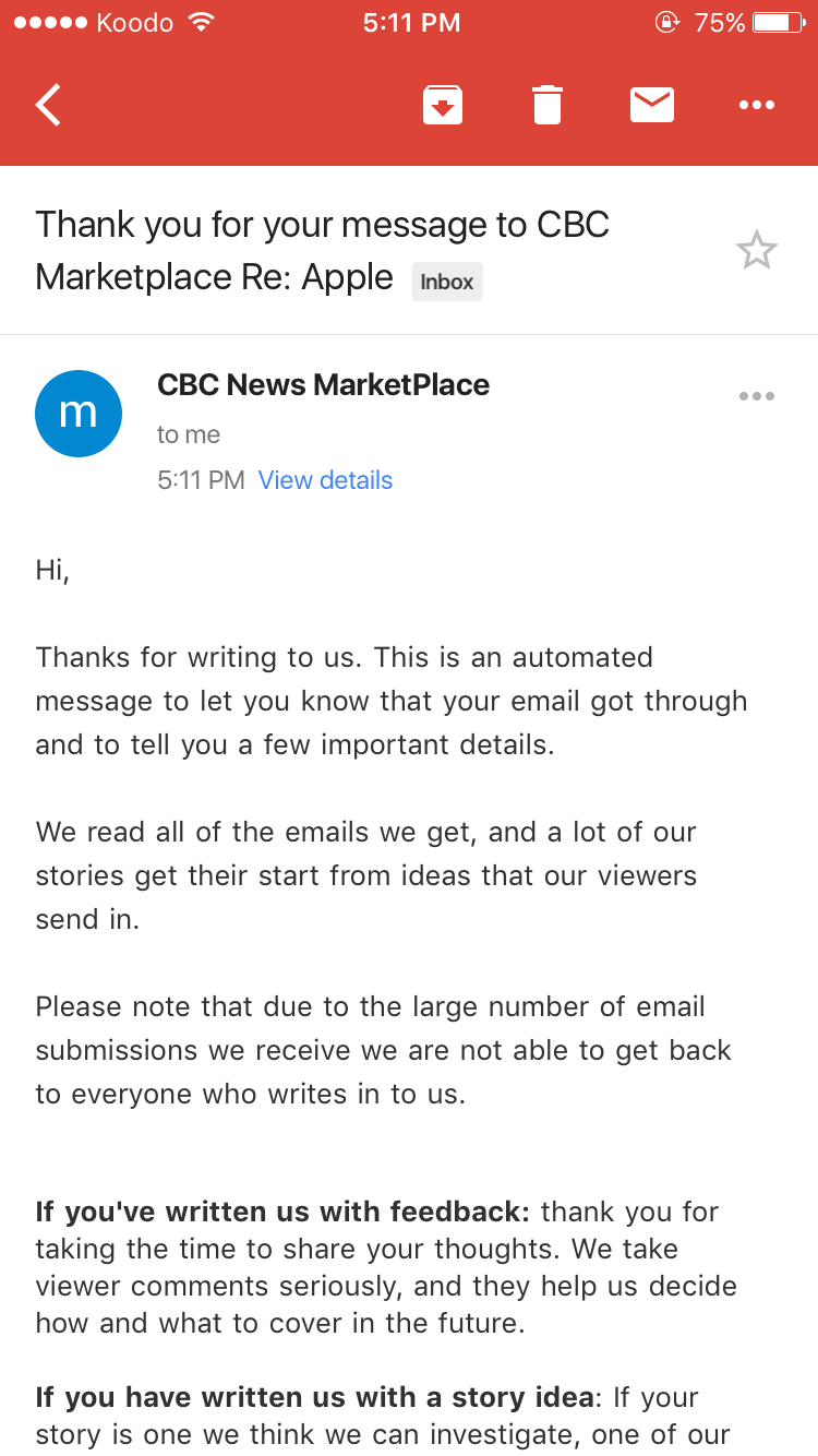

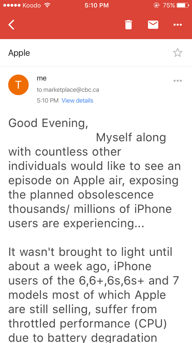

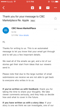

Has anyone contacted the media about this? Maybe if most of us send an email to the same network we all could get the ball rolling and all it would take is a couple minutes.
My theory is if they recieve enough of the same complaint it would be beneficial to do an article, even Canadian media (CBC marketplace) seems to be always hungry.
I myself have contacted CBC Marketplace (it is like an investigative report that offers the customer transparency on what is really going on) I have not received a response as of yet.
Edit: added link
http://www.cbc.ca/marketplace/m/contactus/
Here is a copy of what I included in the email, forgive me as I flunked English class
Good Evening,
Myself along with countless other individuals would like to see an episode on Apple air, exposing the planned obsolescence thousands/ millions of iPhone users are experiencing...
It wasn't brought to light until about a week ago, iPhone users of the 6,6+,6s,6s+ and 7 models most of which Apple are still selling, suffer from throttled performance (CPU) due to battery degradation which can begin at any given time from 91% downward which can be as little as 9-12 months of use. The only way to correct the issue is a battery replacement (see articles below) however Apple 99% of the time will refuse to do the battery replacement if "their test" shows the battery wear level 80%+ EVEN IF YOU OFFER TO PAY 100% OF THE COST! Forcing users (if they suffer) to upgrade to the newest phone!
We are trying to call on Apple to admit what they did was wrong (inserting code into the mobile operating system) to slow down older models with battery wear less than 100%. Along with allowing us to pay to replace the battery when we choose at the proper cost.
https://forums.macrumors.com/thread...s-based-on-battery-wear-level-merged.2094218/
https://www.reddit.com/r/iphone/comments/7inu45/psa_iphone_slow_try_replacing_your_battery/
https://9to5mac.com/2017/12/10/iphone-6s-slow-down-battery-fix/
However we do realize Apple' power over the media, And ask you not to allow this to influence your decision.
