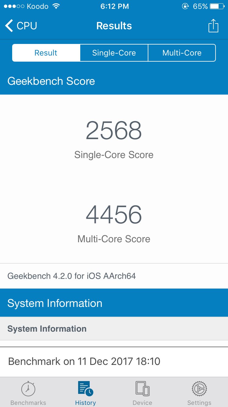

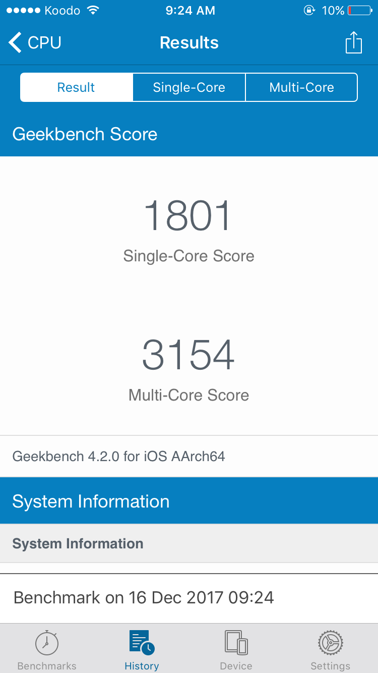

It seems I am affected! FFS!! iPhone 6s 32GB just and I mean just passed the 1 year warranty.
Edit: added screen shot above 50% so the lower score is below 50% the higher score is above 50%. Battery wear level is at 91% as of yesterday.
