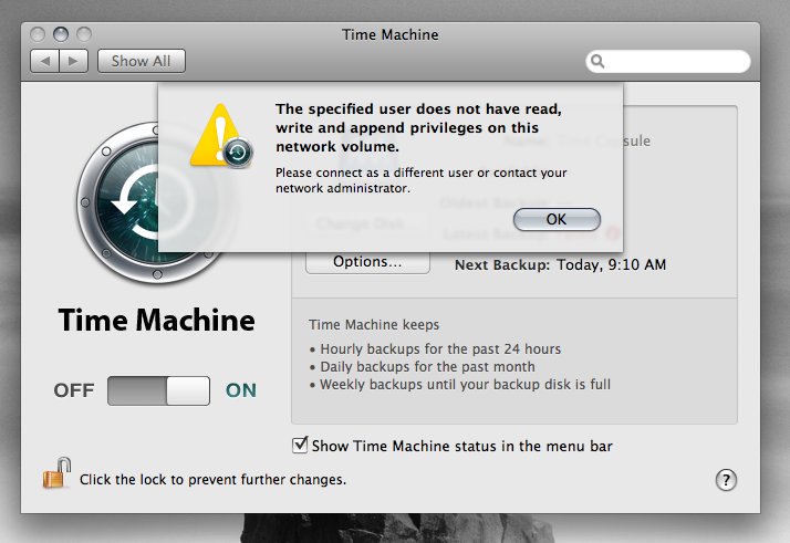

Problem with firmware update
I get this error when my Time Capsule tries to back up - after I just updated the firmware. I reset the TC and tried again. Tried rebooting - everything... Nothing works. Any ideas?
Do you go into the settings in TM and select what drive to use for backups??
Just messed around with mine... to fix this
Open up TM
Options
Select disk
May ask for a password if you have put a password on the TC
