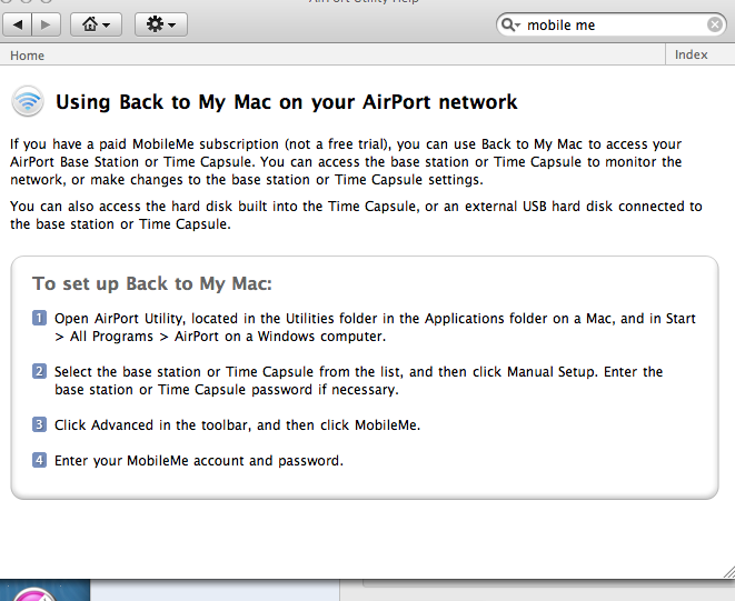

Time Capsule and mobile me
I have been trying to set up my TC so that I can access files when away on business with no luck
I have just come across a not in airport help the says that you need to have full Mobile me subs rather than the free trial.
I would buy Mobile me if it works with my late 2008 TC but don't want to spend £60 if it does not
Can any one confirm that they have got this to work before I get the credit card out.
It should, but why don't you call Apple first to be certain.
