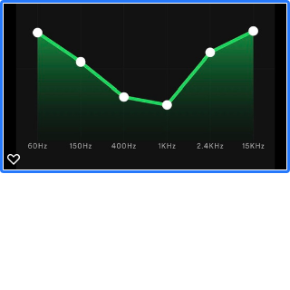

a tip for whom that are not satisfied about the bass performance and are using Spotify.
Try this EQ settings and then tell me ;)
(taken from reddit and then slightly modified)
Thank you, appreciated!Frankly speaking, good Earbuds, AirPods or Headphones should sound perfectly without tweaking EQ. The problems with AirPods Pro by default the bass is not in line with professional lineal sound standards.
Thank you, appreciated!Frankly speaking, good Earbuds, AirPods or Headphones should sounds perfectly without tweaking EQ. The problems with AirPod Pro -by default the bass is not in line with professional lineal sound standards.
totally agree.
Many feedback says that the overall audio quality has slighly improved, i can't confirm or not, using the equalizing mod.
