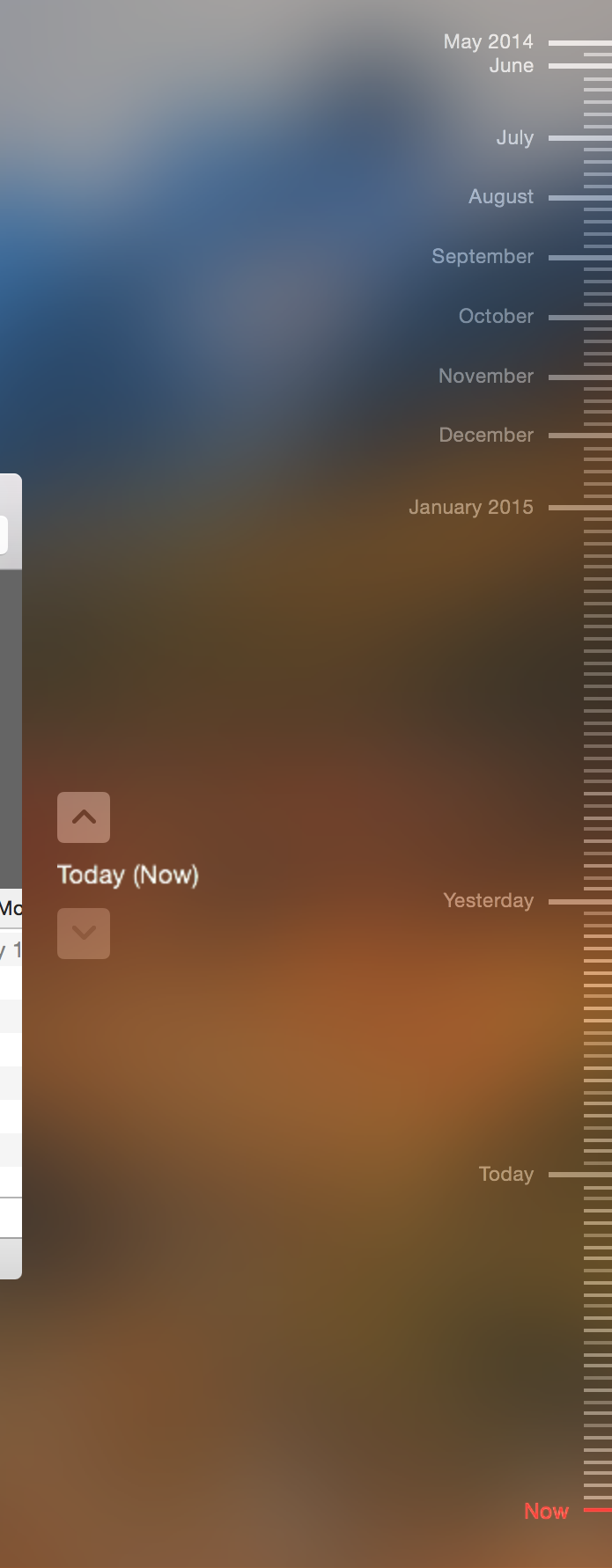

Has anybody else noticed that some apps are now displaying non-retina graphics (Steam for example)? Also has the date next to the finder window in time machine always been in non-retina (see screenshot)?
