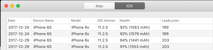

Coconut battery, all over the place.
It was even down to 80.3% earlier today.
Reactions: BigMcGuire
My wife's 6s+ was going nuts with the ratings when she had her restarting 6s+ with the bad battery. No, Apple won't take it as evidence that you can get a replacement. They rejected us because her battery was green.
With an iPhone with a good battery, the design capacity should be very consistent. My wife's 6s+ with the bad battery was all over the place (60%, 80%, 90%, etc...) and restarted whenever load was put on it.
Do realize that you must take the % reading at the same charge percentage (usually full charge) to get an accurate design capacity reading.

Earlier, in post 1801 it was at 80.3%, then 86 something %, so mine isn't that accurate.
I'm very very curious as to how Apple will do their battery health info. My guess is it'll just be a "green" light "red" light type of thing. Would love to see the actual data tho, like the one that coconutBattery reads from the phone. I do wonder if batteries have that much variance in real life, or whether it's a coconutBattery thing?
But agreed, you all are showing that there is something up with the "accuracy" of this!
I will do it again tomorrow after a 100% charge, see what's going on.
Just checked, it's at 93% charge and 81.1% health.
Now back to 96.2% charge and 91.4% health after I closed all Apps and locking the iPhone.
