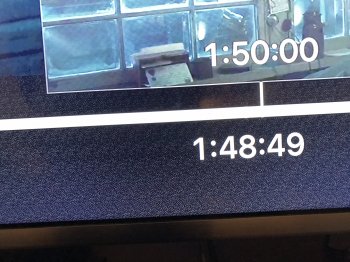

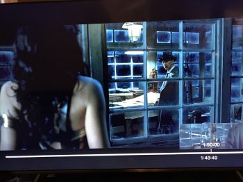

Hello! New to the forums here as I’m in the process of setting up a new 4K Apple TV on my UN55MU8000 and am running into some grain issues when HDR is enabled.
As per the attached pictures, whenever I pause a movie with black bars there is a significant amount of noise/grain at the bottom of the picture, from the progress bar overlay effect. This only happens when HDR is enabled and I've tried changing chroma from 4:2:2 to 4:2:0 with no luck. When in 4K non-HDR the progress bar appears as normal with the shadow effect being processed correctly.

I should also add that depending on the scene, the grain at the bottom isn't always as noticeable. Usually dark scenes show it more but in many well-lit scenes it will also do it. The odd time when I check, depending on the scene, it may be gone almost altogether.
Is this perhaps a normal expectation of HDR on the ATV, or if not would anyone have any suggestions on how it can be eliminated? Thanks in advance!

Glad to see someone else with the same series Samsung. Are you by chance experiencing the grainy effect during pausing/scrubbing HDR content? It only occurs over top of the bottom black bar, or if 16:9 HDR content, if there are dark areas where the shadow effect is overlaid.
Trying to determine if my ATV or Samsung TV are faulty, or if it’s just a glitch on the ATV software 🙂

I believe that your TV is an LED LCD (last years 8000 series was QLED). This tech will struggle with HDR since the backlight will be a max brightness will have more bleed through.
When you bring up the menu, the grid array on the backlight will brighten the bottom edge in order the illuminate the bright white progress bar.
You can try reducing the backlight some, but this will hinder the HDR effect, you can also try playing with the local dimming strength.
Keep in mind that your picture setting for HDR and SDR are independent from each other and need to be calibrated separately. HDR can make the image seam dark. If you raised the brightness (aka black level) to compensate, you may have brightened the black level to a dark gray. Try reducing the brightness and instead increase the gama to compensate for the darker picture.
I hope this helps. This may just be something that you will have to live with. Hopefully it is not too distracting when the film is actually playing.
Thanks for the response! The TV and Apple TV were both new so I didn't realize that HDR had its own independent settings to be changed. I originally tweaked Natural mode to look great for SDR content but didn't realize that the Natural HDR mode had dynamic contrast effects turned on, etc. Set HDR pictures to movie mode, dropped temperature back to Warm1 for preference and now there are zero issues with the shadow effect. HDR content looks even better as well.
