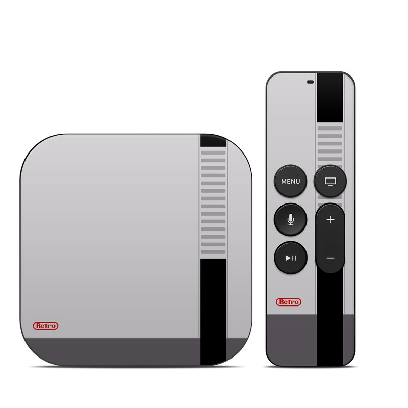

I purchased this
https://www.decalgirl.com/skins/287325/apple-tv-4th-gen-skin-retro-horizontal
I'll report back when I Get it with a mini review
I won't be using the remote skin
I posted in the other thread by accident
