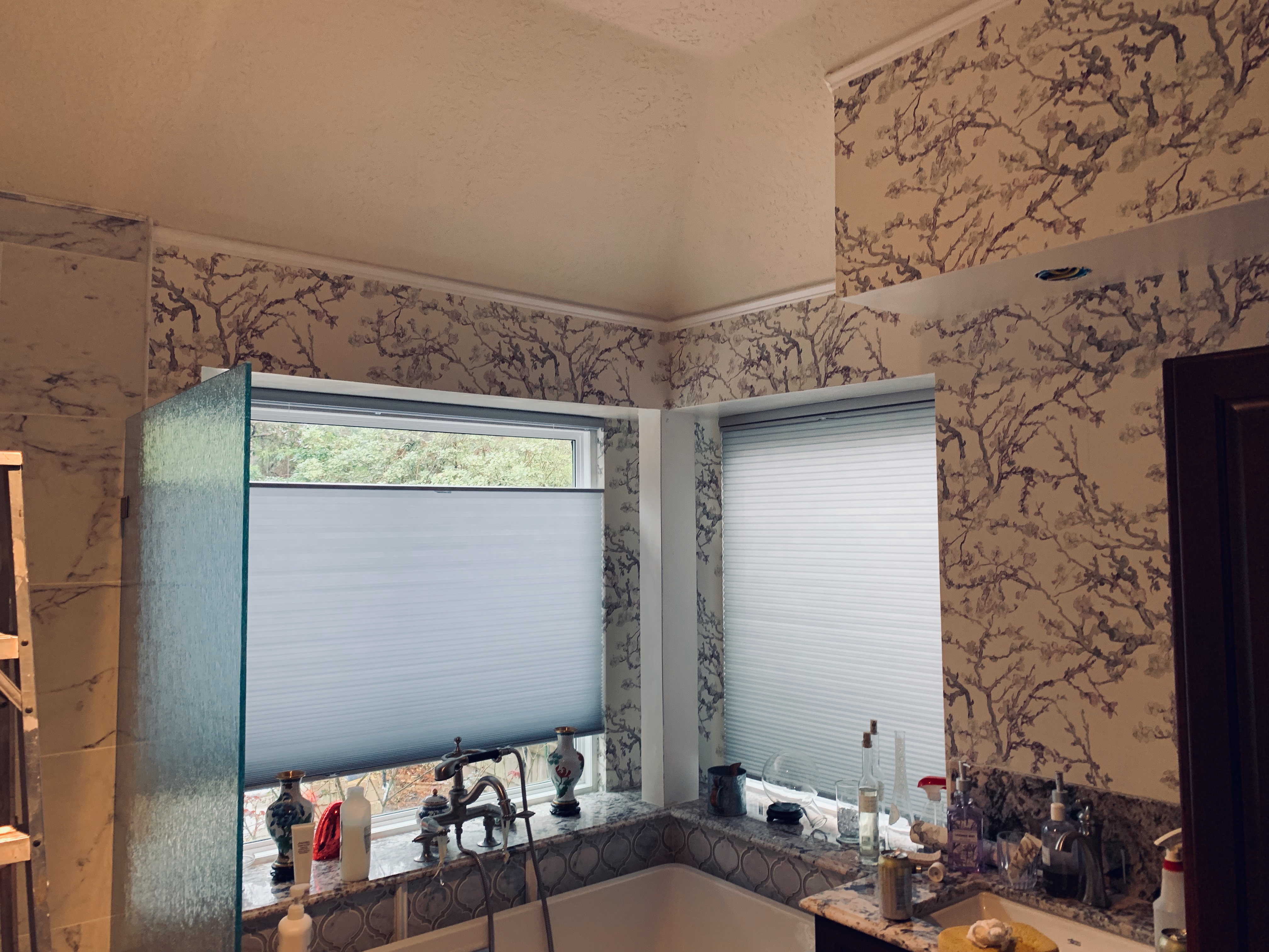

Wallpaper- Since the last time I hung wallpaper, it has changed a bit. I have a nonwoven wallpaper. No longer is the paste on the paper itself, no more soaking the paper in a water tray to moisten the glue. Now it is apply the paste to the wall, with a micro-fiber roller and hang the dry paper. As I’ve not done this before, any tips for installation? I watched the following video:
My impression which may be incorrect, is that when you soaked the paper, it was more flexible and easier to adjust, than this will be. For anyone with experience, is this a true statement?

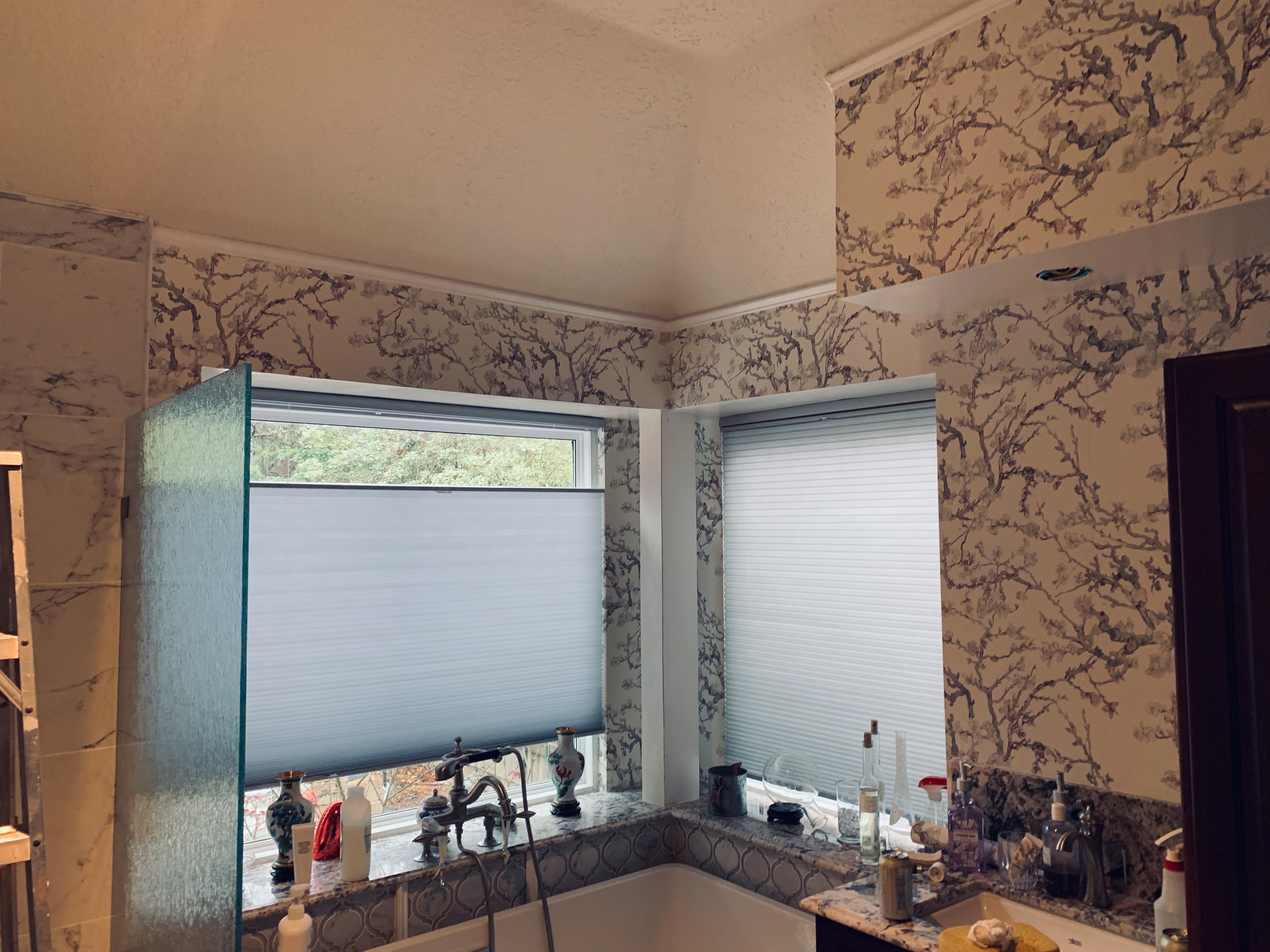

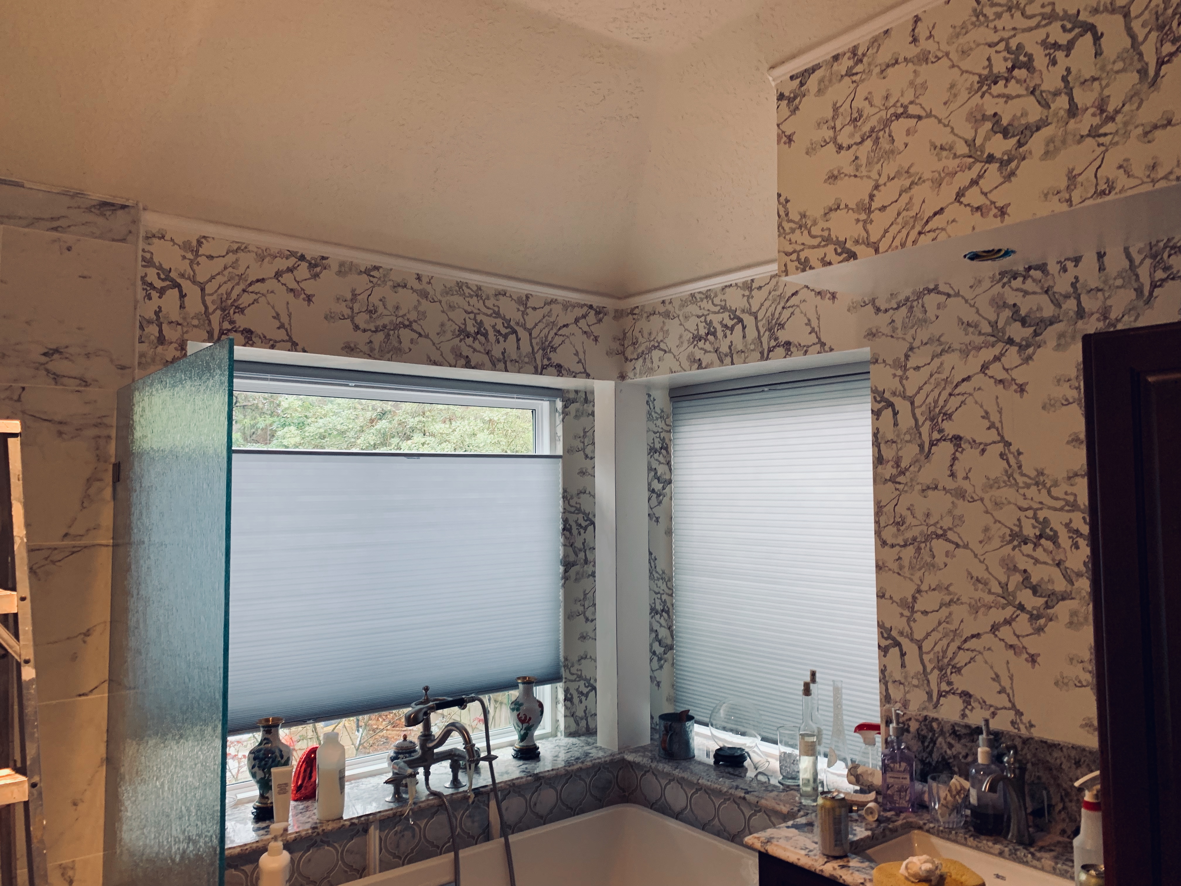

Now that Christmas/New Year’s is over, I’m actually going to hang some wall paper. Regarding inside corners, in the past, I just wrapped around the corner and kept going. However this video discusses if your walls are not square, which I thought was interesting.
Lay the paper so that it stops about 5” short of the corner, measure the widest distance to the corner top to bottom add an 1/8” and wrap around, then cut the entire edge, so that it is all 1/8 overhang on the other side of the corner, then overlap the next piece butting it into the corner. It sounds reasonable to me:

Wallpapering- I have become a convert to using unpasted non-woven wall paper. It is much easier to work with, you don’t have to soak it in bathtub first, you can apply paste on the wall conviently for each piece of paper The only thing I did which was not mentioned in instructions was to spritz the back of each piece of wallpaper with a mister, before hanging, because it adds just a little more moisture to the situation making it easier to adjust the paper right after it is put on the wall.
I still have to finish the drywall in the toilet stall, hang a cabinet and wall paper in there, and put baseboard and crown modeling on the cabinets, hang one more light fixture And I think I’m done! Once the bath is finished and cleaned up I’ll post a pano shot. :)

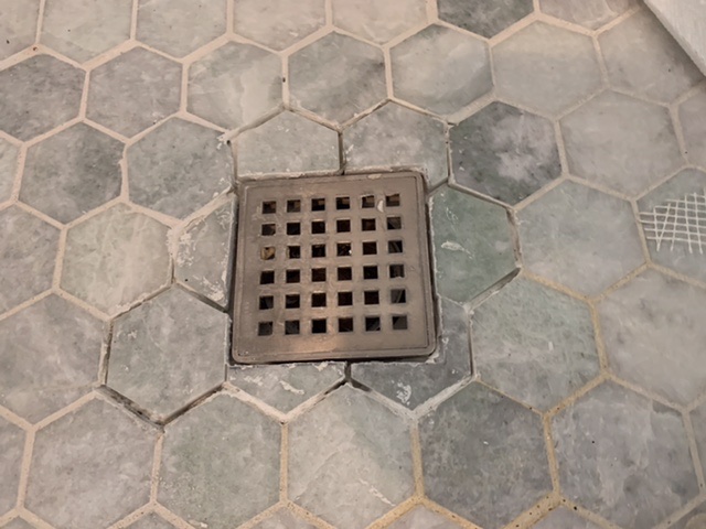

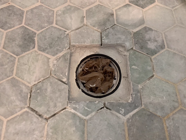

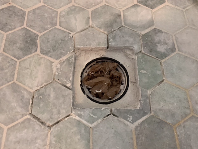

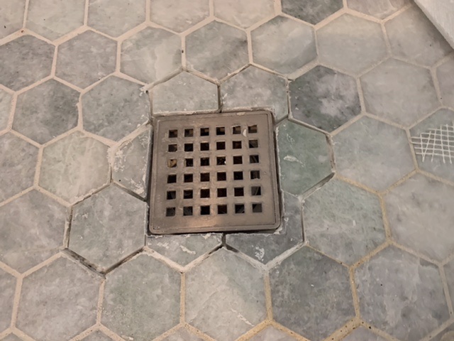

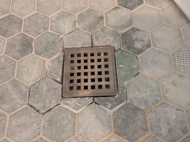

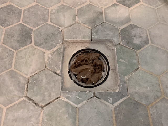

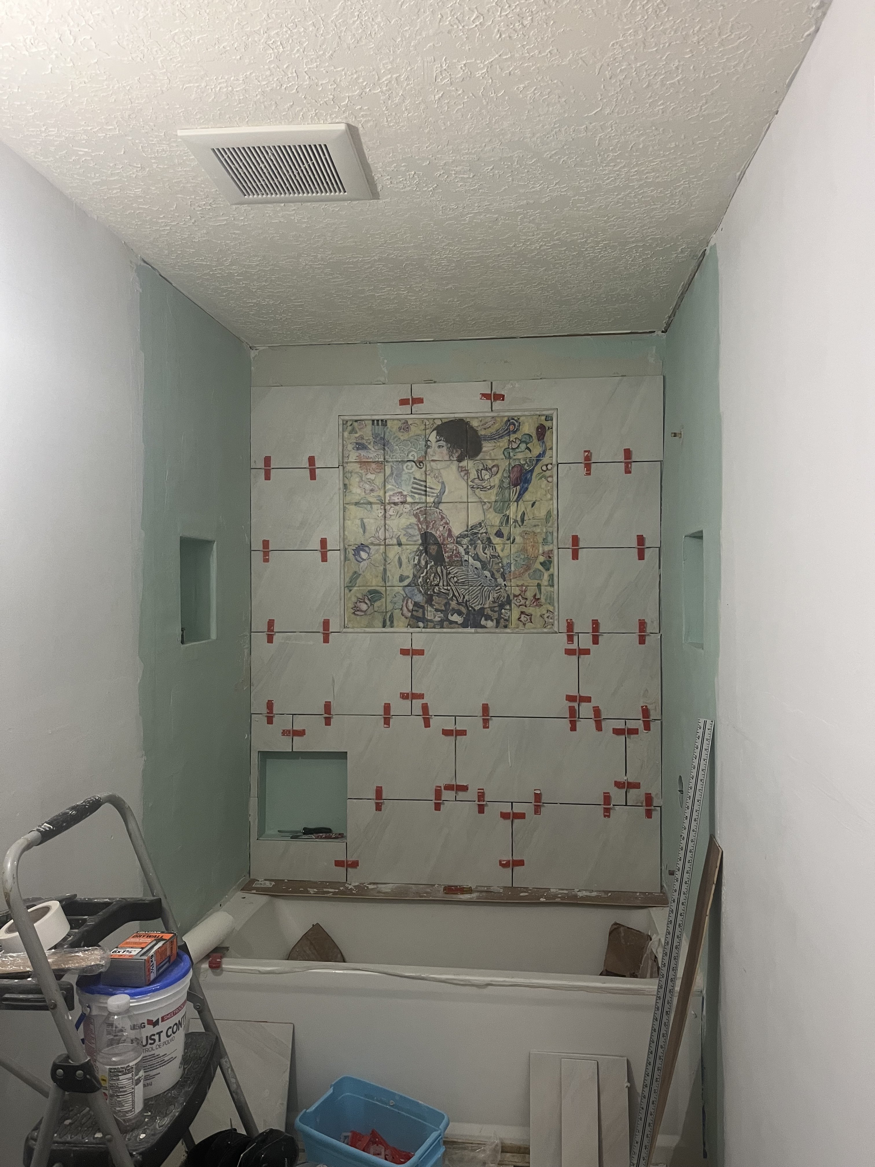

When I cut the shower floor tile, I tried to cut the tile still on the sheet around a square drain that was not in place. No surprise the end result was on the shabby side. I forgot to take a picture before I redid this area, but I cut out the marble tiles adjacent to the drain and have replaced them.
Not yet grouted
Not yet grouted
My question is should I secure this drain in with mastic, grout, or something like Liquid Nails or should I just let it sit in the hole for any future scenario where I need to run a snake into this drain?
Thanks!
Not yet grouted
Not yet grouted
Thanks!
I could see you needing to lift the cover so I’d not seal it in. Doesn’t it have a bottle trap for hair etc?
I agree. Just the little squares which may not stop hair. On a traditional tub drain, I have a hair trap that fits over the drain. Not sure what they make for this kind of a drain Without research.
