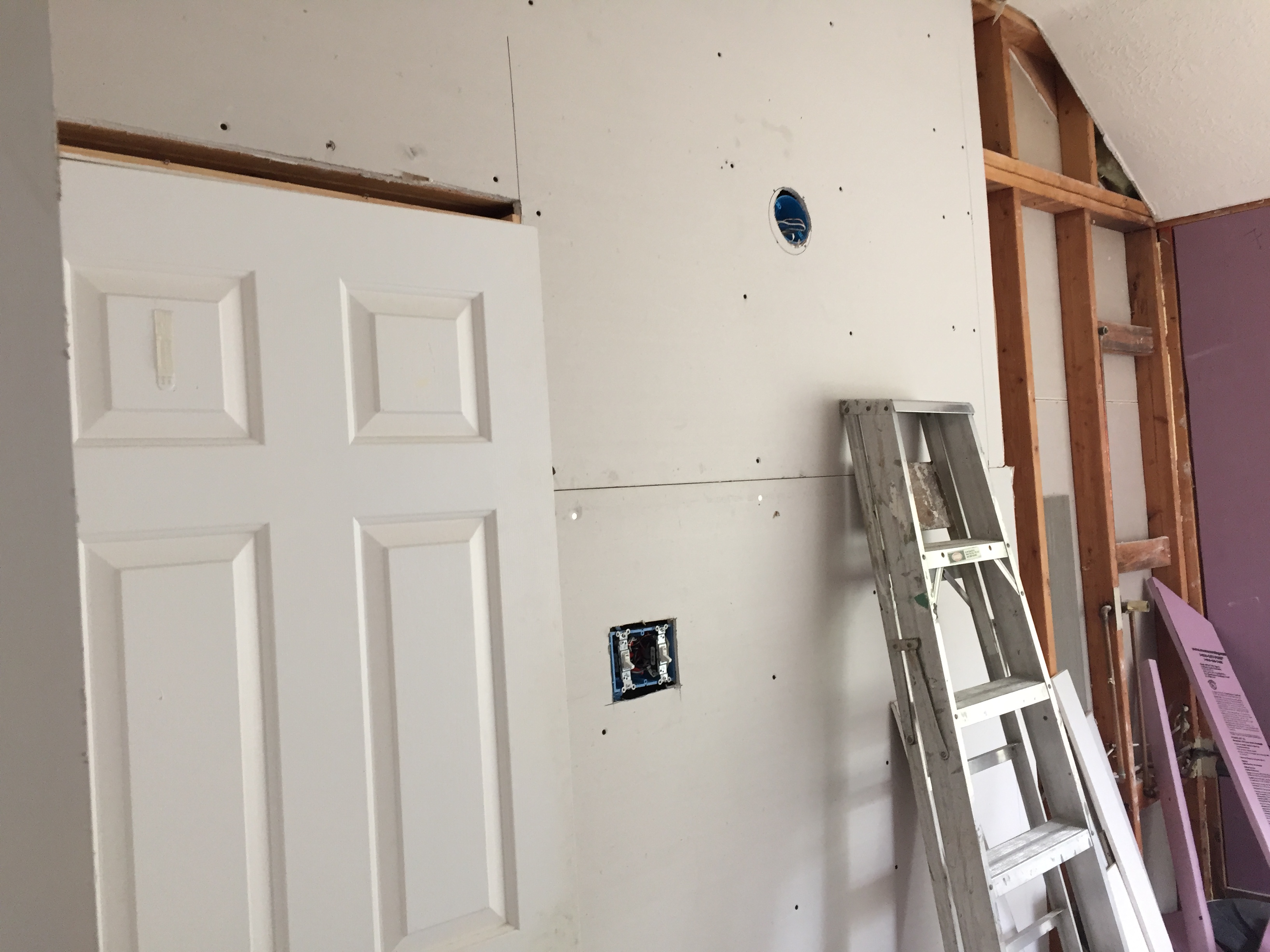

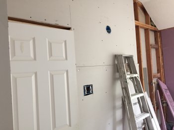

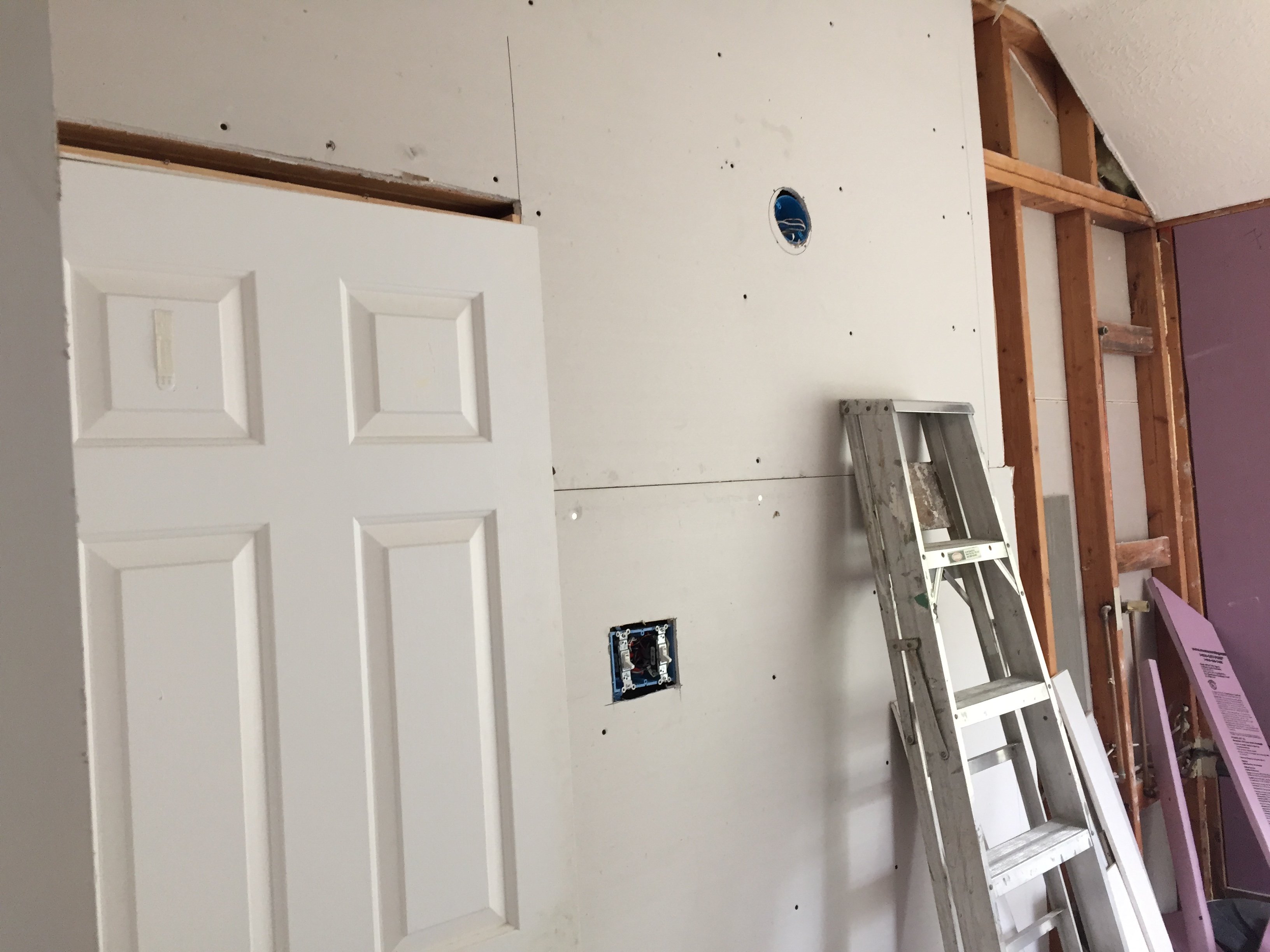

[doublepost=1529065889][/doublepost]14Jun- Hung most of the remaining drywall. If not already mentioned, if you are hanging drywall solo, for a high piece, screws piece of wood into the studs to support it while placing. Drywall should be screwed in, but for the initial hanging, use a couple of drywall nails, easier than trying to hold and screw in.

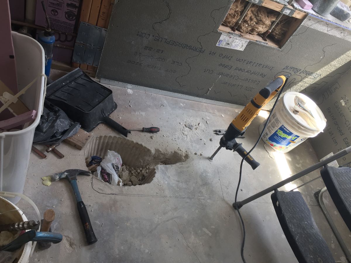

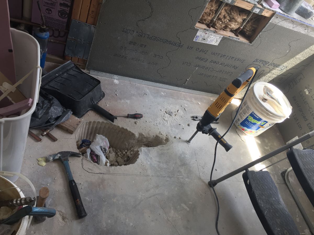

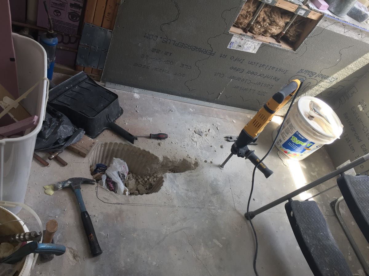

Cutting the foundation for the new tub drain using a Dewalt Rotary Hammer. It’s working, but slow going. I’ve learned don’t lean into a rotary hammer for a tough job because it hinders its hammer action.
The studded area is where the shower goes.

I was going to suggest buying a $20 homeDepot mortar blade to mount on a small grinder but looks like you have >8" of cement to cut through. Looks like you did a better than expected job tho
i lived in the foot hills Albuquerque than west Denver. During which time I acquired a country motif. We moved back into the city and was required to hide these items for the new house.
It’s not really 8”. That is an illusion, because where they brought the pipes up though the concrete they placed a cone of concrete 8” down, everywhere else, it’s 3-4” thick.

years ago i bought a craigsList "Bosch BullDog X" hammer drill
-there are 3 or 4 size spline drill sizes, one drill size not fitting all
-it has a chisel attachment and this works well
-if I have to drill a floor or wall i drill several 1/2" holes than use the chisel
-process takes longer but possible lower structure damage
-the diamond grinder blade works too but will not completely cut a 4" slab
the interface between the cement patch and your new pipes out a paper or plastic sleve to protect the pipe.
