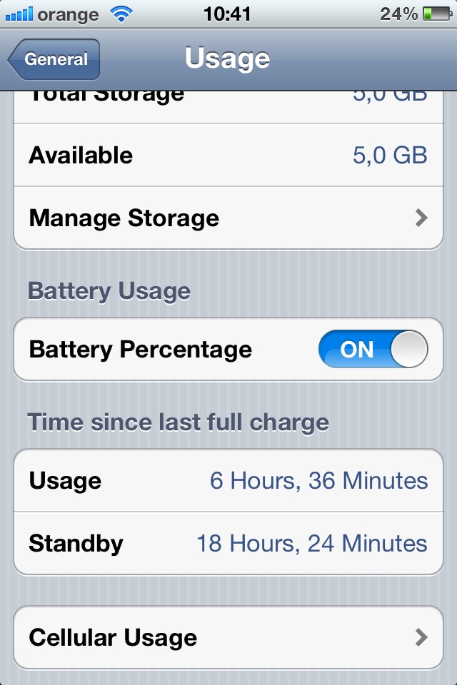

What do you think about this result:
Several calls, listening to music and surfing on web. Everything on exept iAids, Time Zone , Camera and Ping.
After a few days, I'm pretty satisfied with my battery life. Some gaming, surfing, streaming pandora for more than an hour, iMessaging and normal SMS, talking about 40 min or so... Pretty ok, about same as on my late 4. But i did turn off Siri and location.

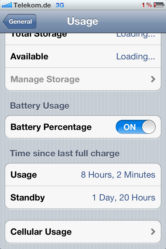

Mines just took a turn for the worse.

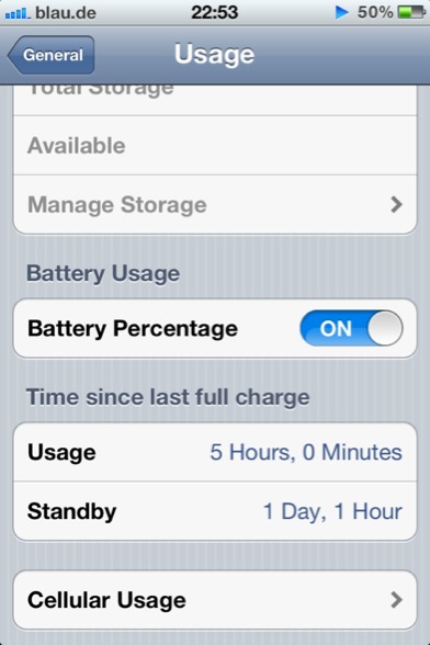

Gentlemen,
I'm cummin from the Original iPhone/ iPhone 3G Gen. Bought myself a nice white 4S and read about this battery problem.
As you can see on my screenshot, I nearly get 1 day+. Is that okay?
Some texting with SMS/whatsup, phoning, surfing, music listening, and playing around with the settings.
I am just asking, because I remember having 3 to 4 days battery with my older iPhones. 1 day is not that convinient.
Thanks
PS: Also here. No iAids, etc. All turned off.

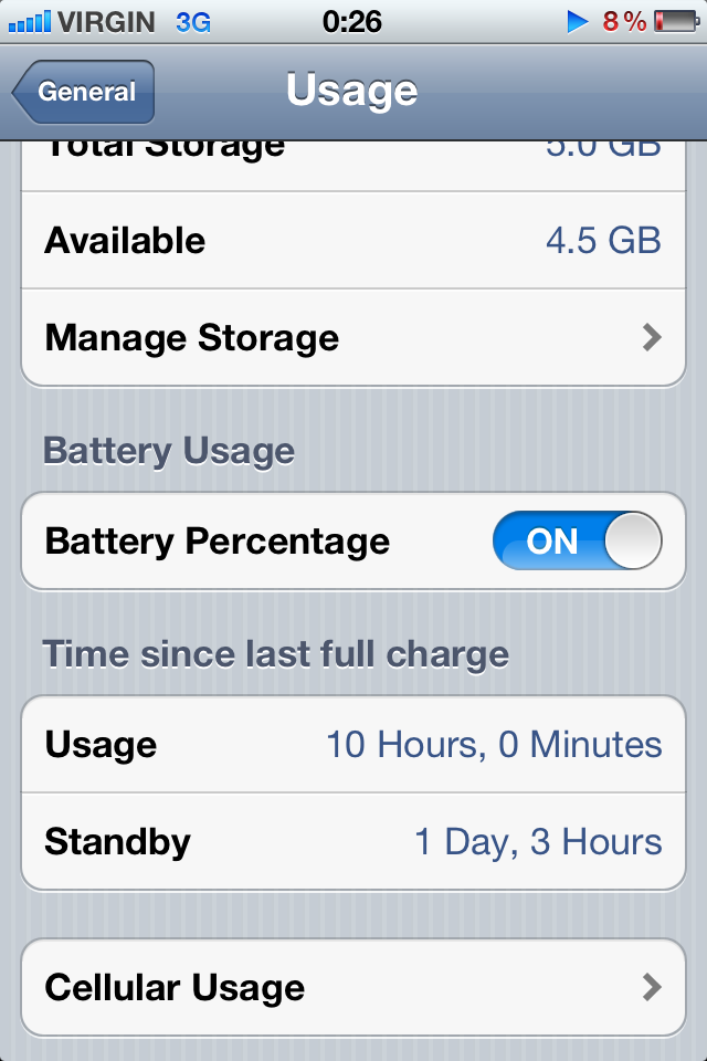

Batterygate cause = Bad Reception
First screenshot is after arriving home from a full weekend vacation at a friends house (more than 6hrs on battery). Second screenshot is after being home a full day. At my home, I get poor reception. When I was at my friends house, I always had good reception. On my case, "batterygate" is related to signal strengh.
I have an iphone 4s with ios 5.0.1
Low 3G reception does reduce battery life. I am assuming the phone is boosting power to get reception and/or losing packets and needs to resend etc But this is also an issue with previous iphone models since 3G was added.
There are a many of other causes of battery drain such as exchange calendar invites looping forever or location services which would exacerbate 3g low reception battery drain. etc
