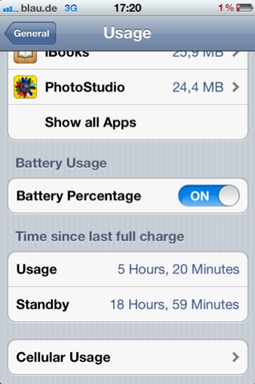

My god, that's an amazing result. It's twice my usage amount!
Are you running the latest beta?
@Reach9-Nope still on iOS 5.0 strangely, I was quite shocked myself, the GPS usage alone should have killed a lot of it.

So, this is it- 3G internet only as a usage:
Good or bad?

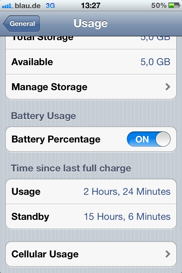

Posted the stats above right before going to bed, these are my stats when waking up:
Usage 1hr
Standby 16,5 hrs
Battery: 38%
Got 3 sms during that period and sent one, that's it for usage.
