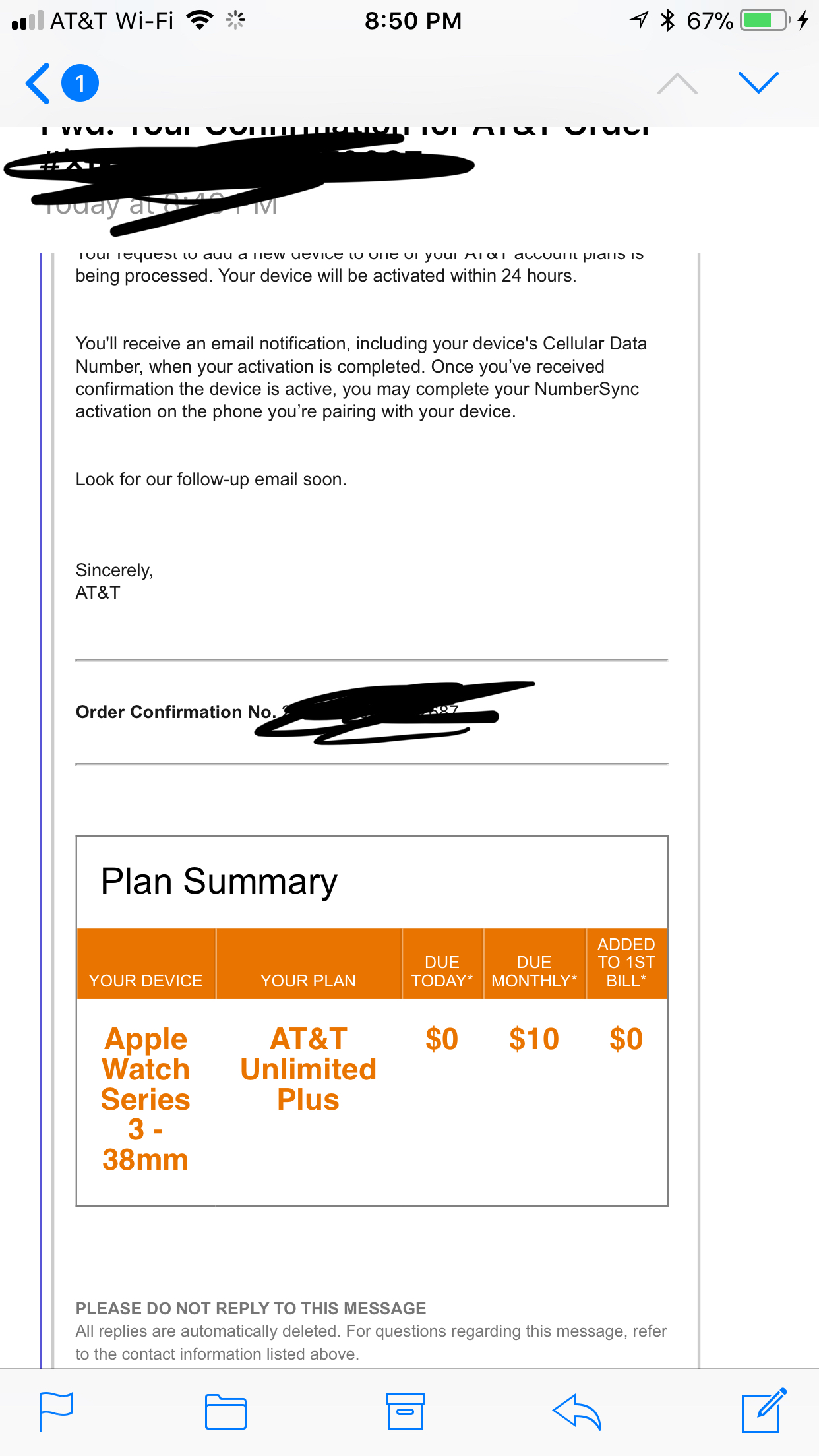

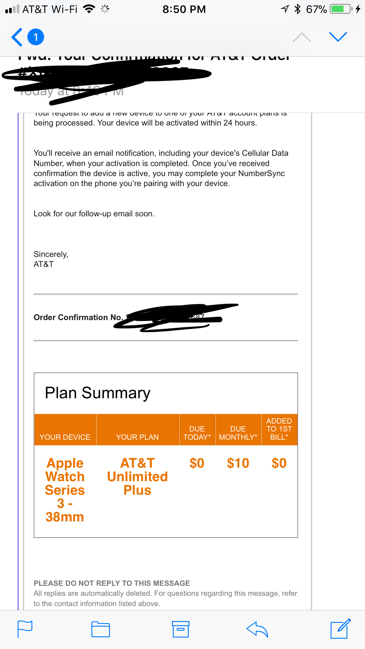

Dave thanks for all the help you are giving. Here is my issue. I don’t think it’s unique but has anyone fixed this issue?
1. Clicked on cellular and entered information.
2. Received confirmation email from ATT but it says wait 24 hours. It has been more than 24 hours now.
3. When I try to click cellular I get error something’s not right error code EDS4007.
4. When I try BYOD it says the number you entered is already active.
Thank you.
The BYOD method is not going to work for you since your device / line is some where in the process and is blocking you from reusing the device information.
What exactly did your confirmation say other than waiting 24 hours?
Dave[/QUOTE]
