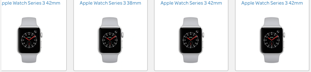

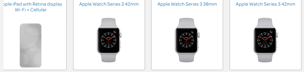

Update 1
Working now! The original number assigned to my watch on Friday was stuck in the ATT activation queue. The rep yesterday provided the watch number and advised continued waiting. The rep today used my EID (and maybe IMEI) to reassign a new number to the device, basically starting the process over. I was able to go through the activation process from the beginning without issue this time (just like with the other there watches I activated for my family.
Update 2
Upon logging into my account, I noticed the watch was listed at an iPad ($20 vs $10/mo). So I had to make another call... The reps today were actually pretty decent but ATT does suck.
