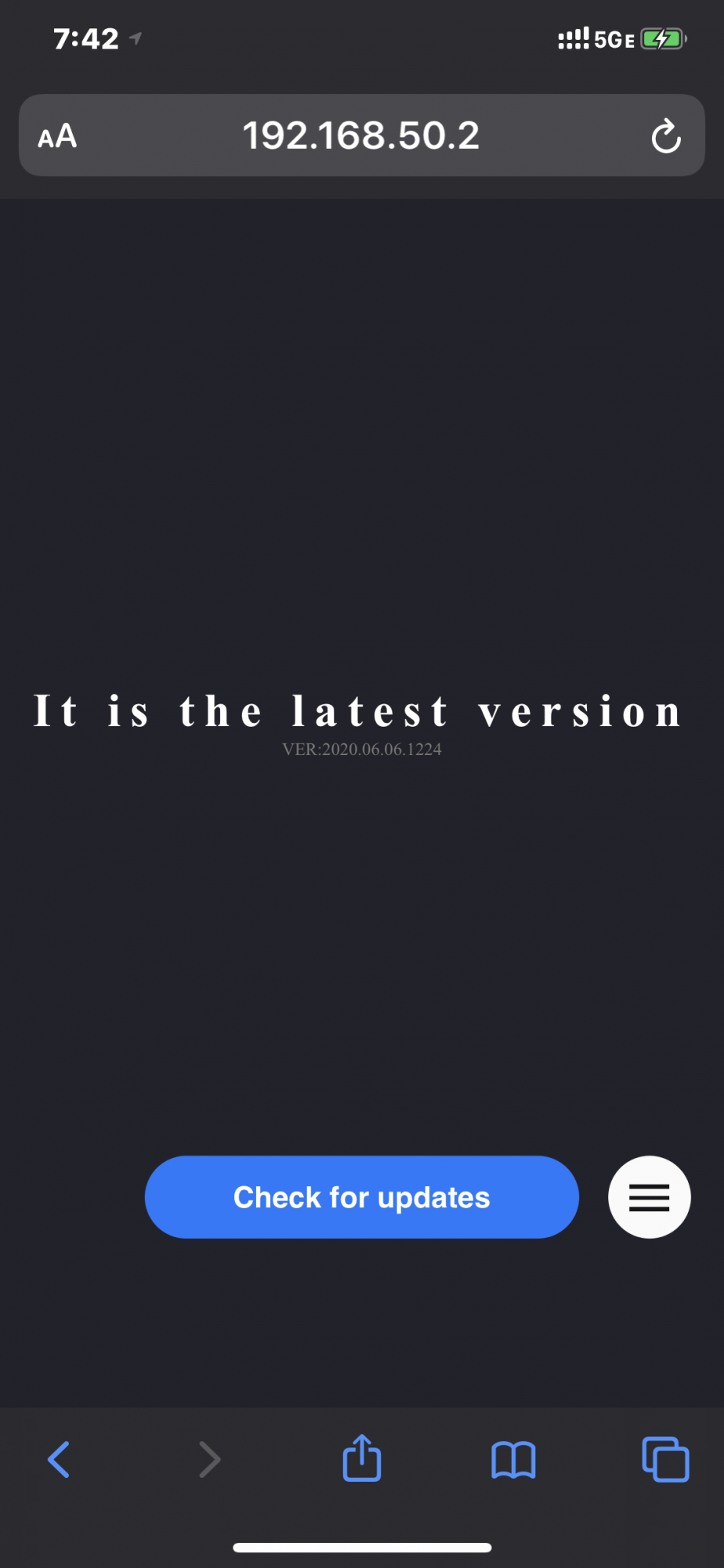

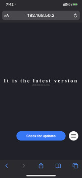

Quick update. I purchased the Carlinkit 2.0c dongle that came with 3-18-20 firmware on it for my work 2017 GMC Truck. On 3-18-20 firmware the sound would start glitching in around 5 minutes of music streaming. A quick pause and un pause would fix it for another 5 minutes or so. I also have the CarPlay2air on my personal truck 2018 GMC truck on 3-6-20 and that firmware works great on both trucks. So I manually downgraded the firmware on the Carlinkit 2.0c to 3-6-20 and causes problems it would not activate anymore even going back to 3-18-20 or the official 1-22-20 firmware. Carlinkit offered to replace it for me if I sent it back as it wouldn’t activate anymore, but I felt I caused the issue by doing the unofficial manual update so I figured I’d bite the bullet and just keep it as is. But today I got the idea to manually update it to 6-6-20 firmware and was easy but this time it activated by itself. 👍👍 so I’m happy to say my bricked Carlinkit 2.0c dongle Is back to life but still has the audio glitching every 5 minutes or so.
Nice find. I would have thought you would have known flashing the USB-C was resulting in bricks before trying it. However, you discovered something, although I heard that 6-6-20 was garbage. But yeah, it's technically not a brick anymore.
I wonder if you now tried to downgrade it to the FW of your choice if it would brick it? You know you could always go back to 6-20 if you wanted to try?
So I just tried to Downgrade the firmware on the Carlinkit 2.0c to 3-6-20 but it wouldn’t allow it to downgrade anymore. It’s like they blocked downgrades somehow with 6-6-20 firmware.
