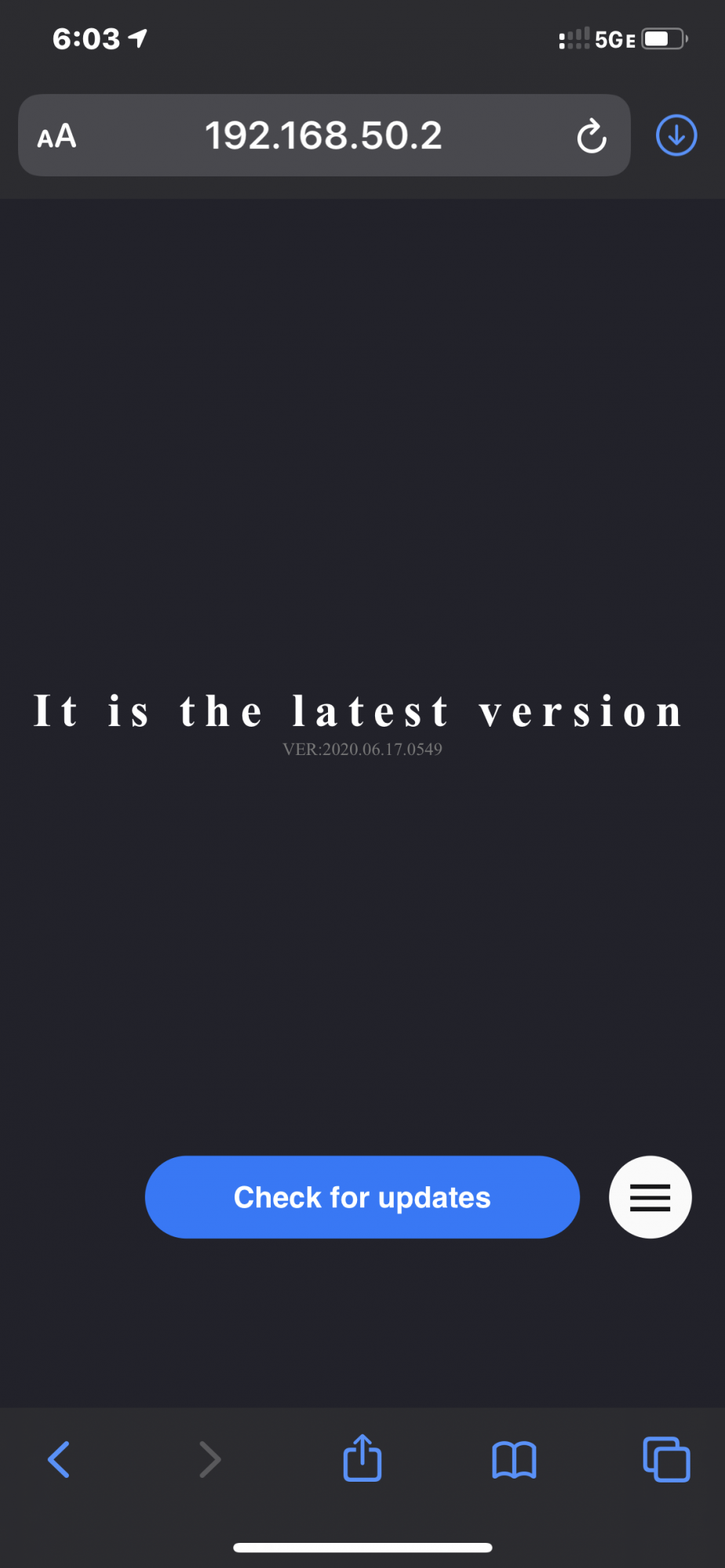

Let’s see how firmware 6-17-20 does. Hopefully the audio glitching goes away.

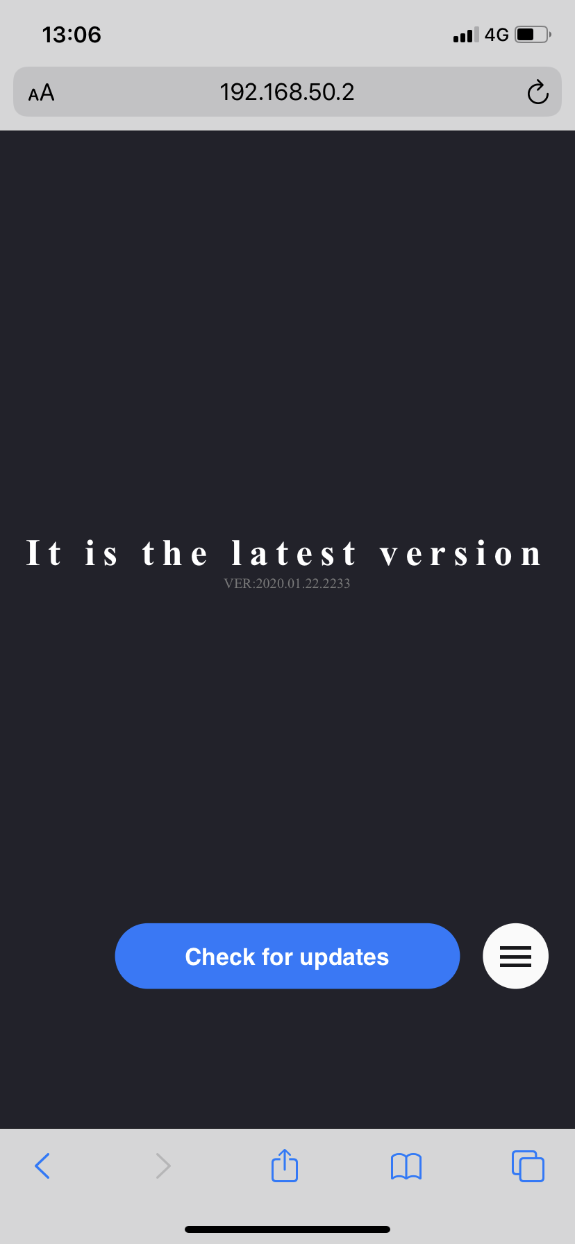

Same for me. I don't think a file will be downloaded at all, because the green light on the adapter continues to flash during the download. When I click the "Check for updates" button, an update is tried again and remains stuck at 90%.
Version 01-22 is displayed again today during the update check (Carlinkit USB-C version). So no update was installed.

Something new with 2020.06.17. When my phone connects to the adapter, CarPlay does not automatically take over my Pioneer HU. Instead I stay at my sources screen until I press the CarPlay icon.
