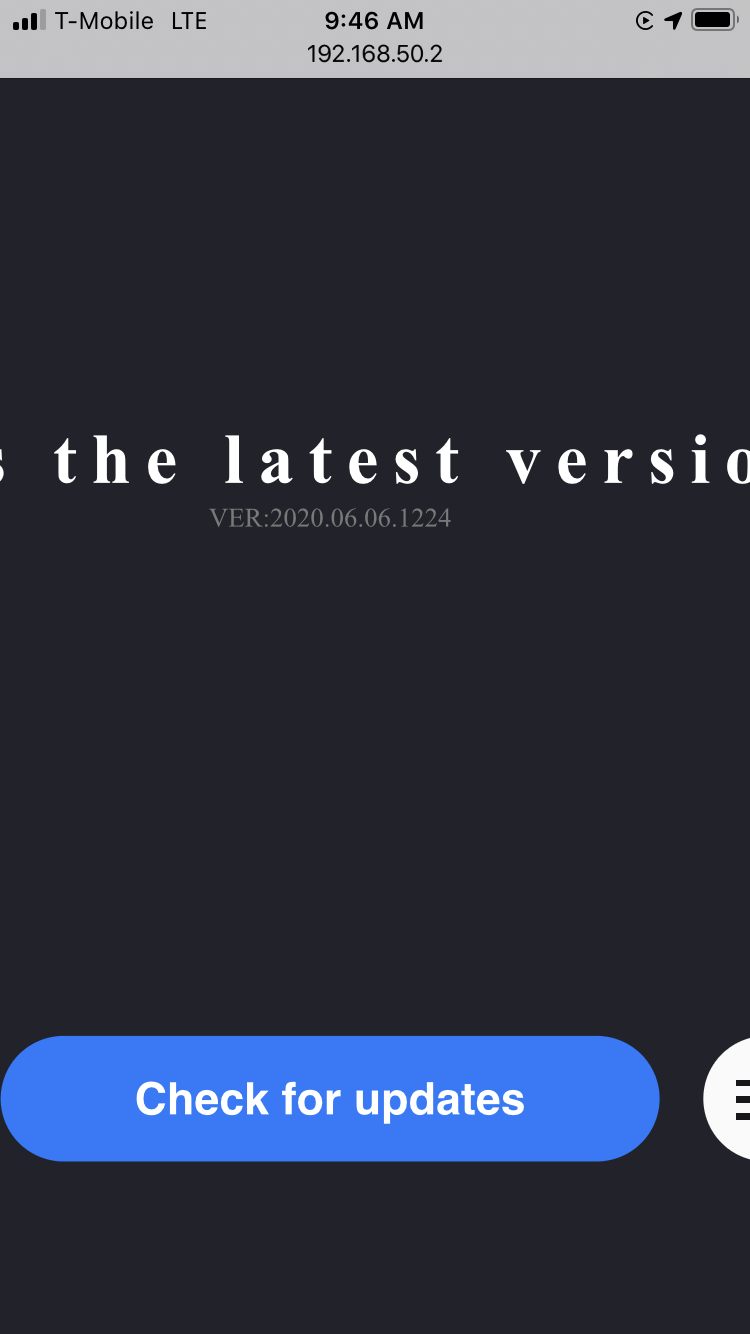

2020.06.06.1224 officially popped up this morning here in the US (Missouri anyways). Doesn't seem to fix any of the issues I had with the USB-C 2.0 model and my Pioneer head unit.

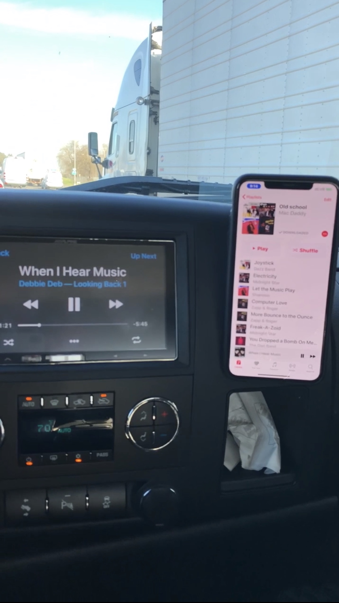

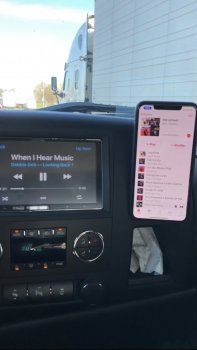

Yes my truck disconnects in the same 2 places every day on my 45 minute drive to and from work. Both places have cell towers real close to the area it disconnects. It’s not just a CarPlay2air or Carlinkit issue. We have 2 other cars with an Alpine ILX-107 with built in Wireless CarPlay that disconnect in those same areas. So all I can think is there is high levels of radio frequency from the cell towers causing the issue.

Mine did the same. I gave it 10 minutes of being stuck at 90% installing and hit refresh on Safari, and it said I had the latest version 2020.06.06.1224 . I was expecting it to never boot up again. So far it's working fine, but this things been an adventure a minute, so, we'll see.

So I went through the update. When I first plugged it in, it said my device was already up to date to the 6-6 firmware. Which seemed strange.
I clicked the “checked for updates” button and it said “upgrading” and got stuck at 90%.
I waited a few minutes and everything seems to be working still, but now every time I click “check for updates” I get the “upgrading” screen. Is that normal? Always getting the "upgrading" screen when clicking "check for updates" makes me think the update never actually applied. Do others get the same behavior?

I had same experience with my CPLAY2AIR device. Upgrading process stacked at 90%. But after opening 192.168.50.2 in Safari I have message tha actual version is 2020.06.06.1244. Every time when I press Check for update upgrading restarts and block at 90%.
