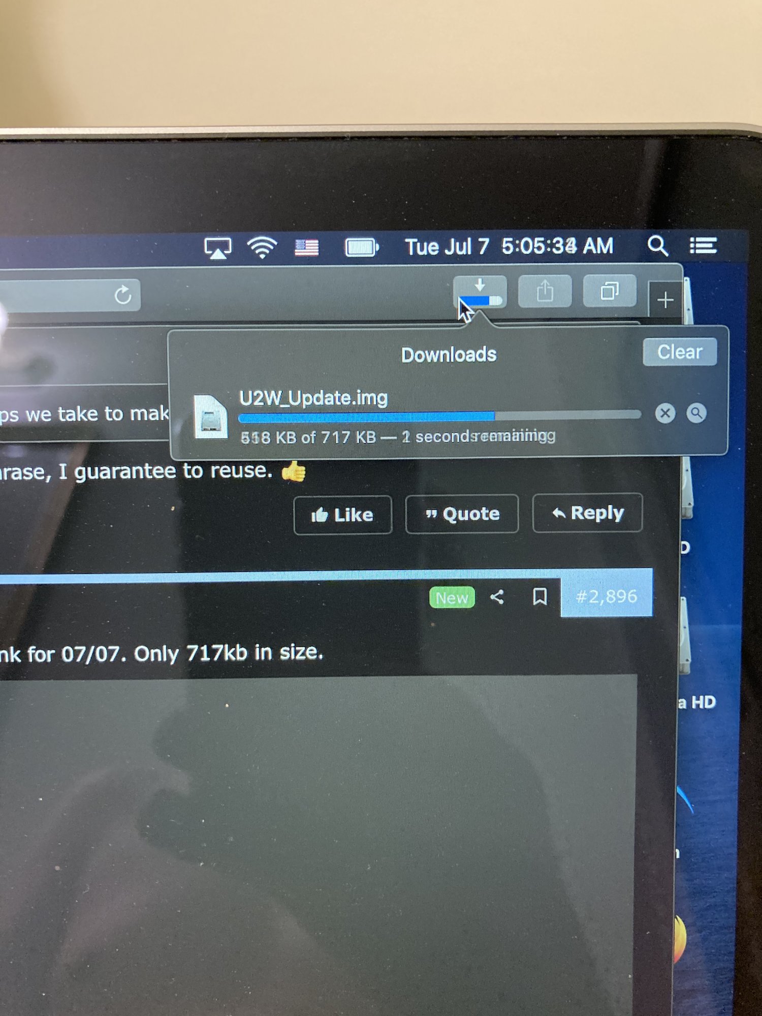

Looks like another bogus update on the direct link for 07/07. Only 717kb in size.
Now thats definitely weird micro update.
