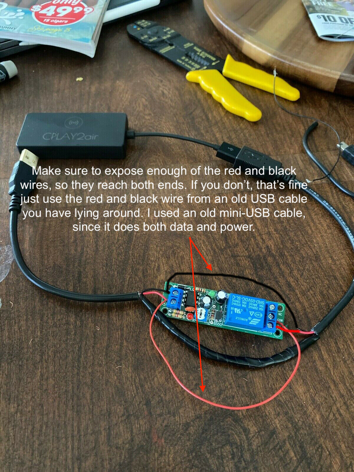

On my 2018 GMC Sierra like on a lot of other Cars/trucks the USB that I connect the Carplay2air adapter would power on every time I unlocked the doors, closed the door but the stereo/screen would not power on till the splash screen was loaded. This would cause the CarPlay2Air adapter not to be recognized every time.
@2018 Denali
Have a 2018 Suburban and have my carlinkit on order from China. Was looking at your 10 second adapter and had a couple of questions.
It looks based on the diagram you are feeding 12v from the cigarette lighter from the relay into the USB power line carplay adapter. Am I misunderstanding the diagram?
A simpler solution might be to use a 5v relay from the car USB directly that is already accessory controlled. That way there wouldn't need to be a need to tie into the 12v power.
Car USB -> 5v time delay relay -> carplay adapter
You would need to cut a usb extension and put the time delay module in the middle on the power and ground lines.
I have used this module before on some Christmas lights for a similar use case. It is a bit of overkill for this but it is easy to use: https://www.amazon.com/UCTRONICS-Programmable-Multifunction-Segment-Automatic/dp/B07BT32T1M
I have my parts on order to give it a shot.

The mod I have posted does not feed 12v to the dongle. The 12v from the cigarette lighter is the trigger to allow the 5v from the usb to pass through.
I used the switched usb extension wire because the 5v power was already cut and was a thick wire. No need to do the ground wire. That is where the relay was tapped into it.
The relay I posted does a 10 second power on delay of the 5v usb power and the relay is completely sealed so no internal parts are exposed for a nicer finish product.

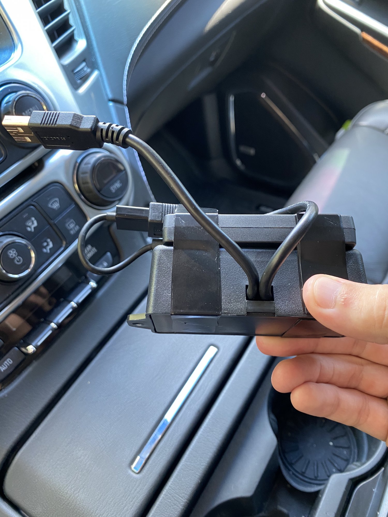

@mammut3 I can confirm that this does work. I also found an enclosure on eBay that the relay board fits in and it works perfectly. I bought the 0-60 second 5v delay on relay and have it set for 30 seconds. I have found that's the best time to activate it without running the risk of having to unplug and replug in the future (this is mainly due to having to load my kids into the car so I needed to extend the time). If you are the only person getting in the car you could do 10 seconds and it would work fine. Like you mentioned above, I am only sacrificing a USB port and not both the cigarette lighter and USB.

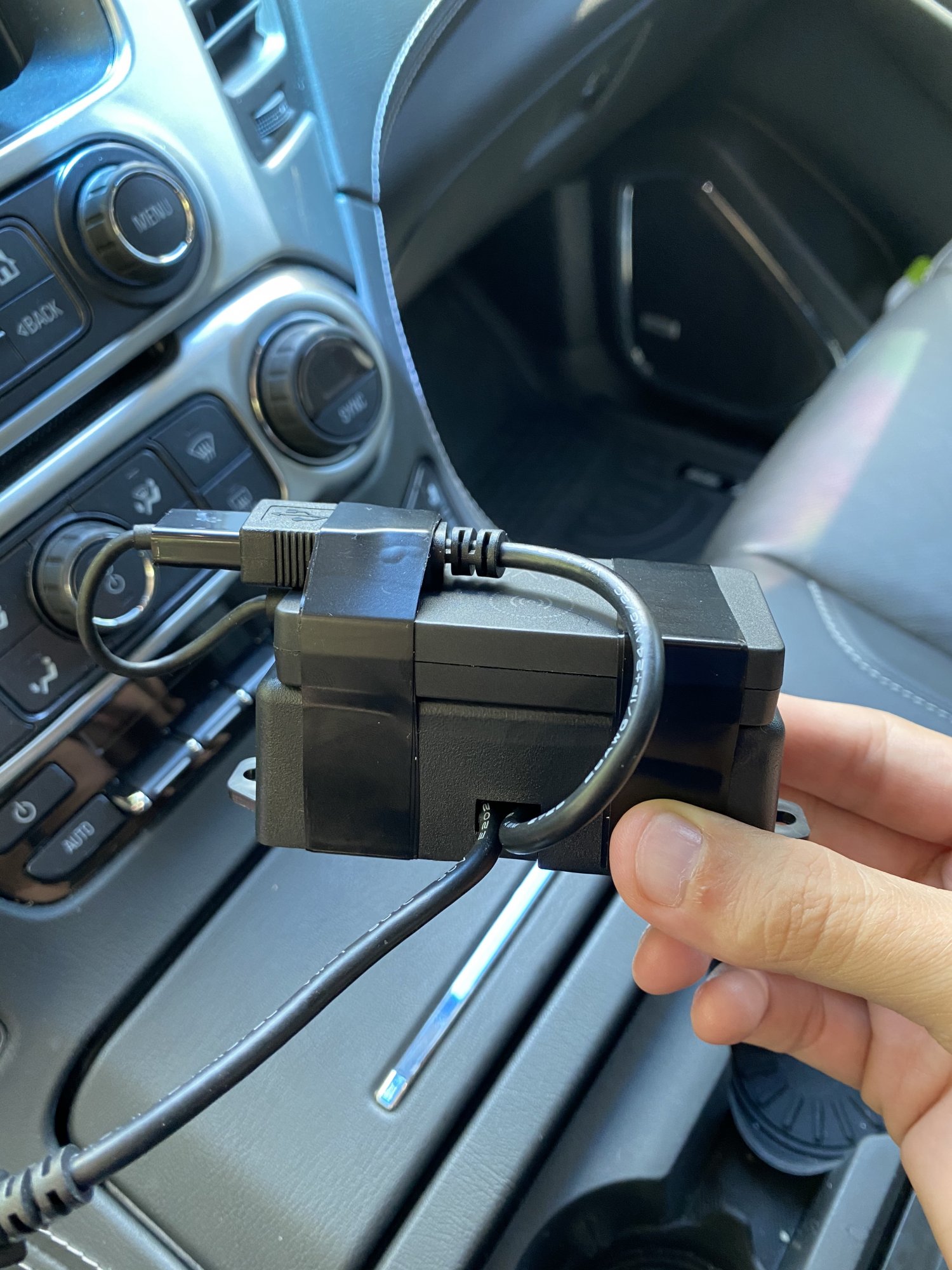

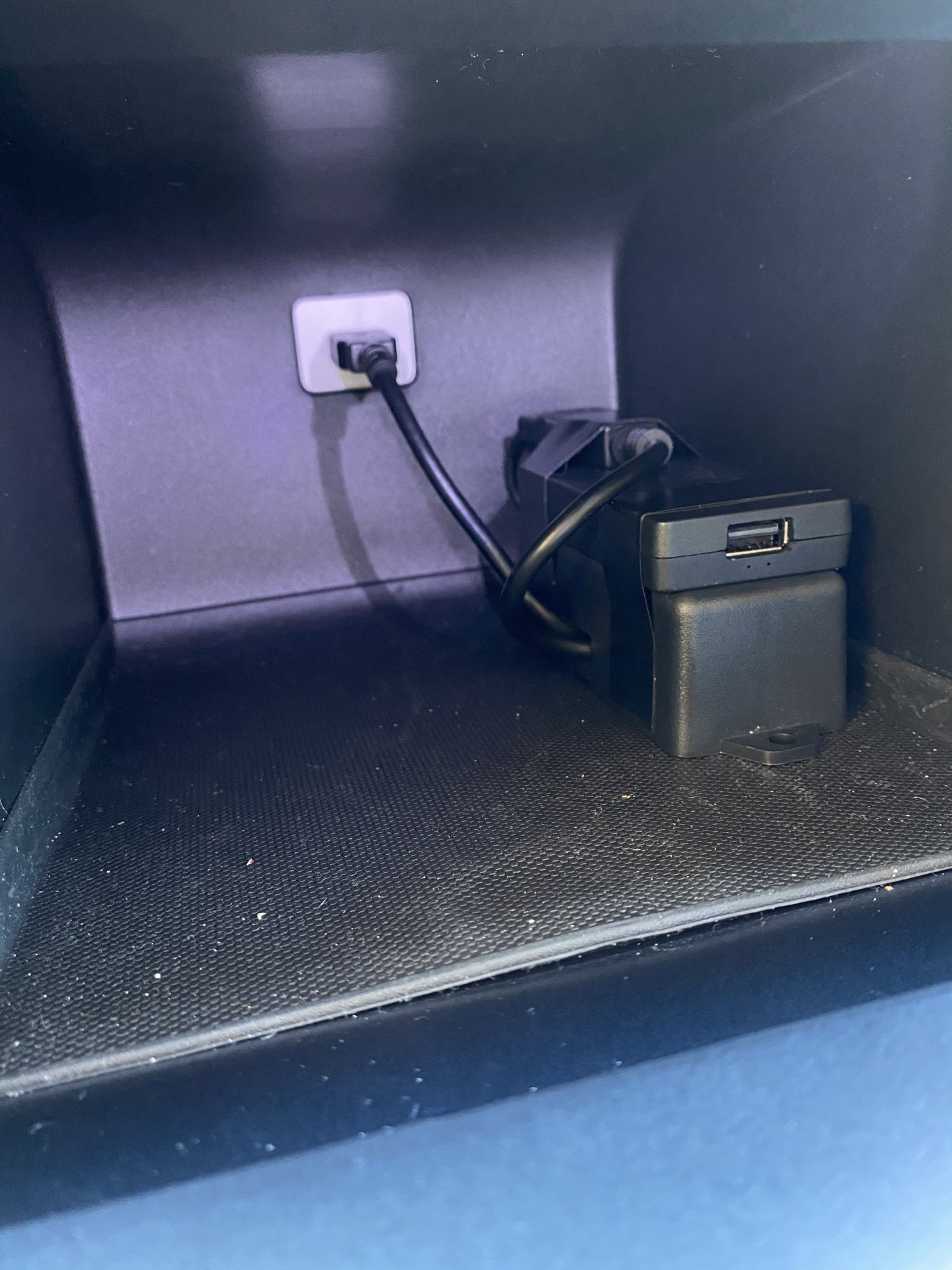

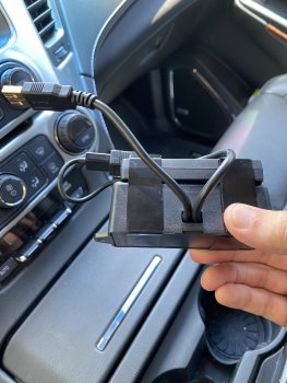

@BUXjr these are the items that I purchased.
The 5V 60 second delay relay. I paid the extra the $2.75 for shipping and I got it in about 10 days:
The enclosure link. I had to purchase it with another delay relay however, it's a 12V relay so it won't work, the way we are trying to use it. I messaged the seller and he said I was unable to purchase just the enclosure.
The usb extension link through Amazon. I bought the 1.5ft one because I have a 2017 Tahoe and I have this behind the radio in the storage department plugged into the USB. If you are putting it in the center console and hiding it like @2018 Denali, you would need a longer extension:
Attached below are the photos.

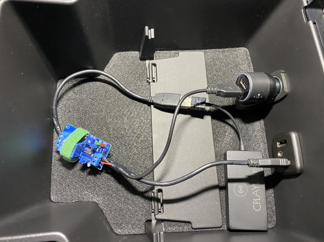

I am using a similar setup as 2018 Denali, the only difference is that instead of using the cigarette lighter adapter inside the center console as a trigger I am using it to supply power to the 5v delay relay timer because in my case (perhaps all GM vehicles) the power to the vehicle USB ports comes on when you open the door, that's not the case for cigarette lighter in the center console (power is only provided to it with the key in the ignition).
So my setup is not the most efficient, but it works well enough. I have two male USB Jacks coming out of the delay timer and one female coming out the other end where Cplay2air is plugged in, one of the two male jacks is bringing 5v (red and black wires) from the cigarette lighter adapter and the other is carrying data (white and green wires) plugged to the car USB port.
The other alternative is to have the timer plugged into the vehicle USB port and play with the amount of minutes needed to be set in your spacific application. That didn't work for me because I didn't want to time myself, I just have the timer start counting when I crank the engine.
I was not able to find a suitable enclosure yet.
