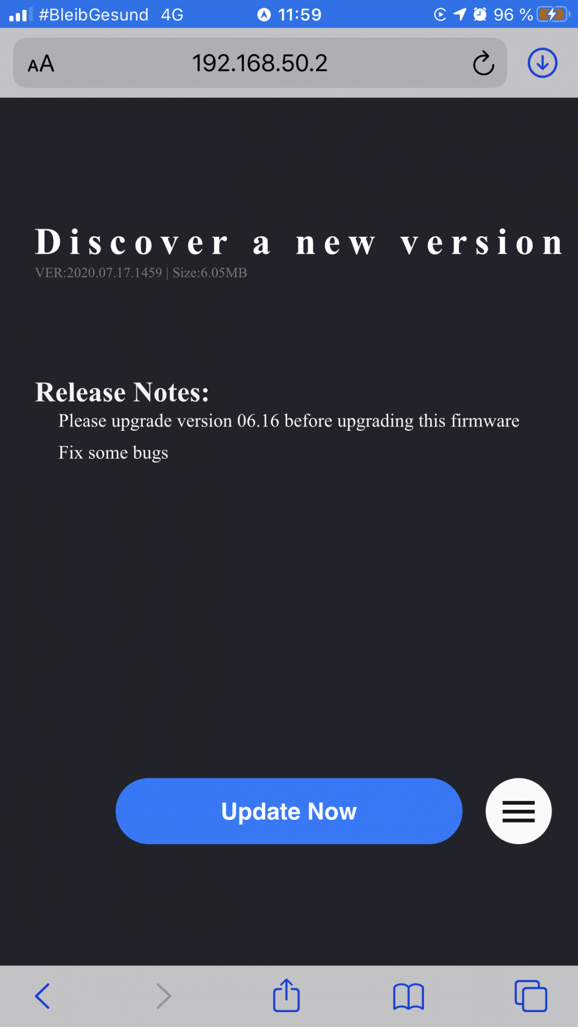

Got now an usb-c carlinkit 2.0 dongle, after the old usb-a carplay2air get‘s broken... today an update 17jul is available for ota, but on the iPhone screen it is mentioned to upgrade to 16jun Firmware before update to 17jul version. Does anybody else had this screen? Is it easy to do an ota update without bricking the device?
I have this exact same screen in UK. I've hit the upgrade button... and waited... and waited.... The update seems to get to around 90% then stops (this bit is quick - around 30 seconds max). I've waited at the 90% mark for over 10 mins.
I sent an email and tried to upload the log file via the safari browser... Let's see how quick they respond !
